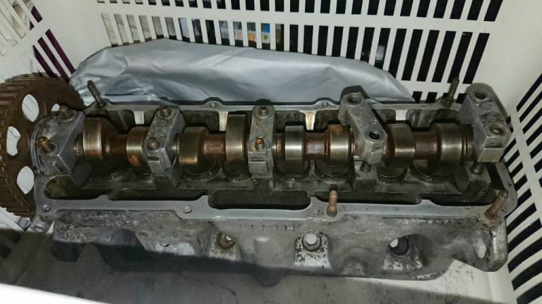

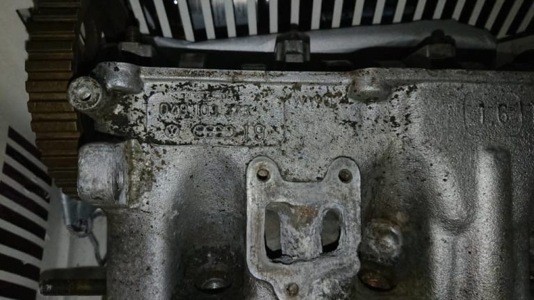

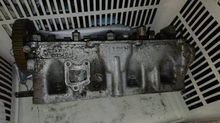

049 103 373 ?
as in
https://www.ebay.com/p/VW-Volkswagen-Cylinder-Head-RARE-Water-Cooled-Carb-Rabbit-Golf-Scirocco-Mk1/1533552878?iid=222994449568&chn=ps
https://www.ebay.com/itm/Cylinder-Head-VW-Jetta-Rabbit-Scirocco-Mk1-Dasher-Quantum-Audi-049-103-373-B-/311856017086
Golf Cabrio, this is the wrong section…. The 1.6 is a big block carb engine, not a small block….Golf Cabrio said
Mk1cabAlex
Welcome to the club first of all. 😀
Well I can't this question for you but I will move your post into a section where you might get a slightly better response! 😉 👍🏼
Solid tappets have 5 caps, Hydraulic heads have 4 caps.
You might be able to fit a hydraulic head to a not hydraulic engine but not 100% sure, you would find lots of those and if you change/get the top water hose outlet you could fit the 1.8 head…..
1.6 water outlet between cyinders 1 and 2, 1.8 water outlet between 3 and 4.
You might find it easier to take the head to an engine builders and see if they can repair/fix it?
