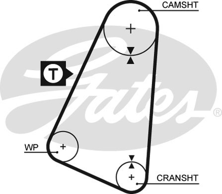

the water pump IS the tensioner.

it rotates round the 3 slots
you should pick up a belt for under 10 quid, so 20 all in or there abouts.
this is all you need and some coolant etc..
