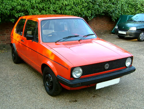

Completely agree, handling is definitly improved so i'm happy!
The seller let me fit them before payment so i thought i'd give it a go. I'm keeping them as its lowered it about 25mm at the front and about 30mm at the back, but it looks even all round, and the handling thru the corners is way better!
