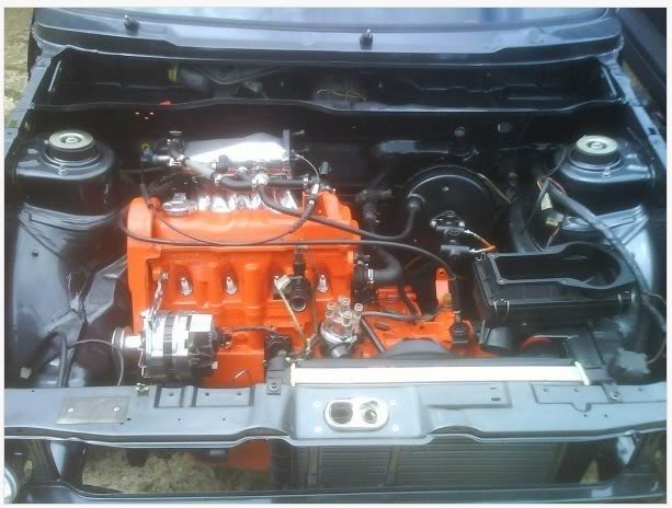

Can the sump be shortened? Can I put a dry sump on and what will that entail? Can I raise the engine up inside the bay without chopping the mounts and spoiling the new paint, there is about 3.5" clearance between the top of the engine and underside of the bonnet… Some sort of custom made brackets and rubbers might work but how would this effect handling, drive shafts gearbox linkages etc????

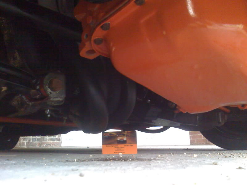

I'll get some pictures of the problem underside to show what I mean.
See the lowness
The sump is lower than a credit/RAC card. Can anyone see a way of making this higher? Can anyone recommend a firm that can help.
Air rides going to cost ?2000. I can put a new 1.3 G40 engine in for that with a custom exhaust and a tiny sump and i'm pretty strapped for cash now at the end of my project…
Any ideas…

I have to agree. Small wheels and low profile tyres have dropped to the ground. Then lowering too just keeps it heading for the ground!
Out of interest is your speedo correct? Hasn't the circumference of the wheel changed? So now you are traveling slower than your speedo readout???
