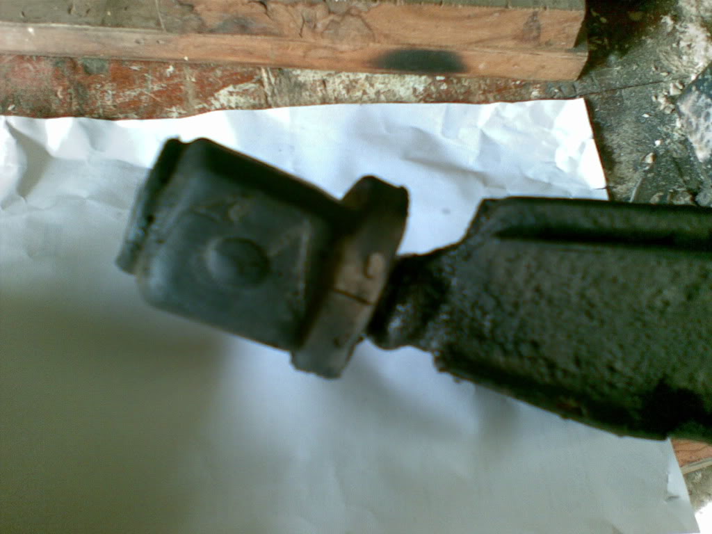

Hi, replacing the lower control arm, bought a new one but now trying to remove the rubber bushes to fit on the new arm.
Cant figure out how to remove them, they are tight. Please any advice on removing these rubber bushes.

I am going to replace both wishbones, but judging by the amount of force that is required to get the new bushes in the new wishbone I would say getting them out/off without destroying them is near impossible.
Since they are not that expensive this might just be a good time to replace them anyway.

Thanks guys, managed to get the one bush off and it ripped up pulling threw the hole so going to replace them all. Thanks again guys.

Dont even need a press, warm bush up in hot water to make it more pliable then drop of correct lubricant, long bolt with nut ,a socket and washer.

Guys, I am re-useing my arms as there is little wrong with them was just gonna wire wheel and black them.
Got all new bushes and ball joints but how the hell do you get the back bush out, and in. Does this have to be done in a press ?

You can cut the metal out with saw, or drill around it and push it out, then burn the rest out with oxy acet, or just continue with a saw. Don't cut too far or you WILL need a new arm.

Which still leaves me with the question do the bushes need to be pressed into the arm
Not tried yet, but can't you just put it in a vice and slowly apply the pressure by closing it?
If they are the poly type bushes, they should just push in by hand with a good greasing.  I've no experience with renewing standard ones, but why would you want to? :lol:
