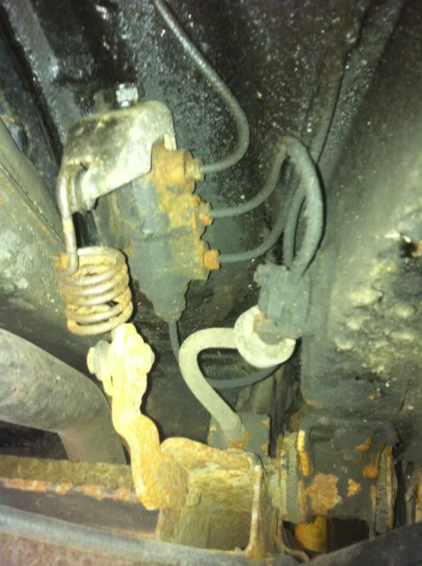

is the bias valve spring tight as you can stretch it a bit with a car jack

I have stretched the spring so it's hardly in use and it still does it. I think it is lined diagonally and the front discs are as big as I can go without changing the wheels. I am wondering if it either the bias valve or the connectors in the lines?

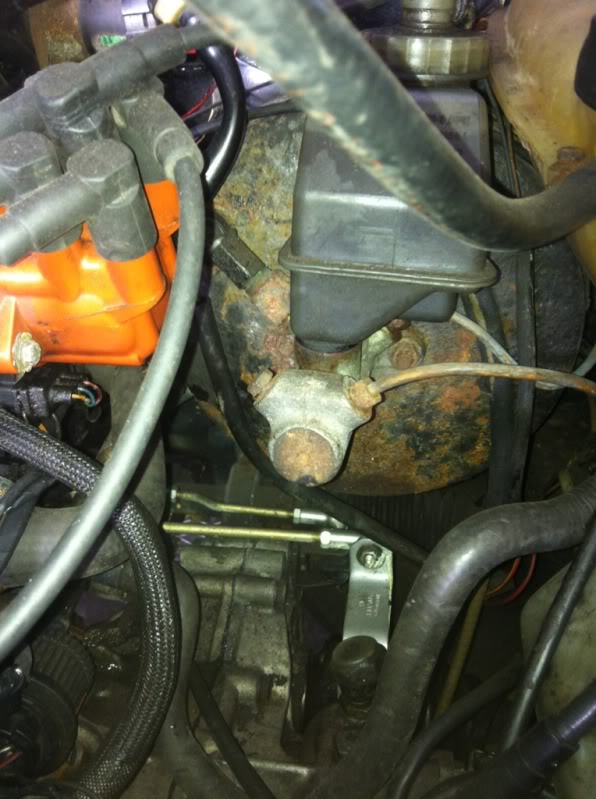

how many outlets are on your mc
it should be plumbed in like that anyway but if your mc only has 2 outlets then you can use the t's

you could take the spring off and see if it still does it but id say you wont be able to adjust it on the bias valve so maybe swap for the valve that go on the mc like these

could be the valve itself is shot, i made a bracket so i could fit a mk2 bias valve which was built with rear discs in mind, plus its easier and cheaper to get than the mk1 item.
you shouldnt need to upgrade the front brakes if the bias valve is working correctly.
