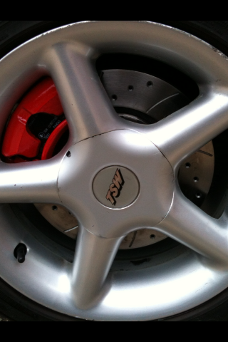

Result
close ha looks sweet !!
with a little filing on the hub, allows the adapter bracket to fit sweet.
massive size difference
