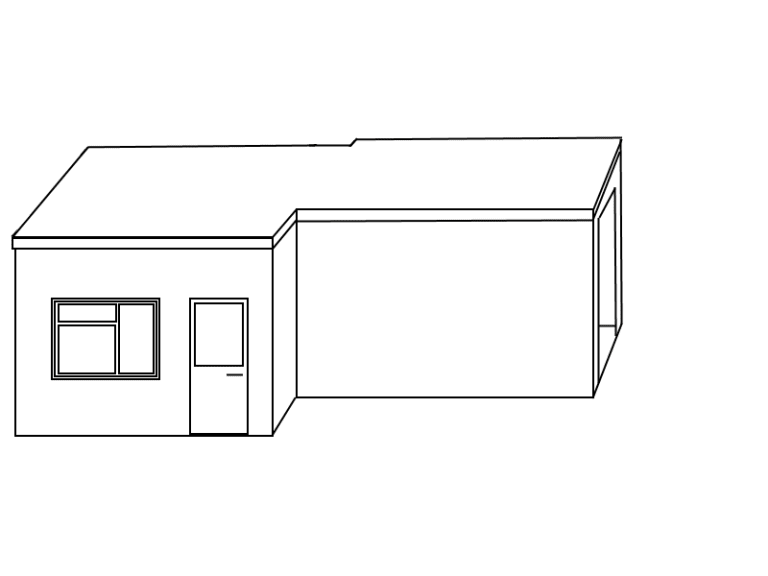

Building regs and planning say I'm good to go as exempt from building regs and under permitted development
It should hopefully look a bit like this:
In reality the rear wall will be about 150mm from the rear fence. The existing garage wall is on the boundary and where the new part of the garage will be located, my neighbour has a shed up to the fence so to avoid any disruption I have built it off the boundary slightly.

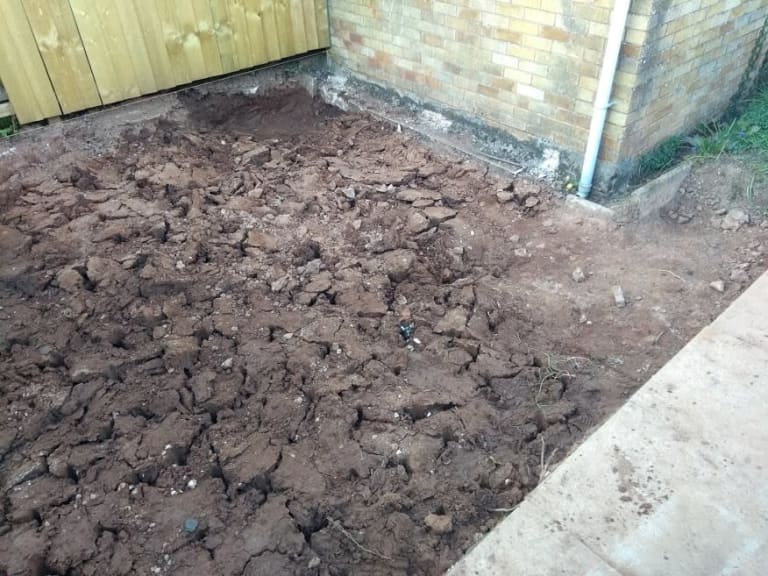

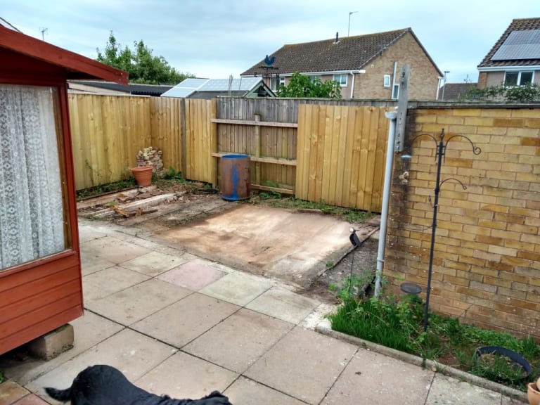

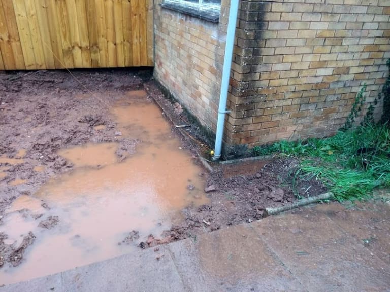

So with the sheds gone it's freed up the area where it will be located, the summer house will go when the new building is water tight.
So broke up the base:
So in the pouring rain yesterday I managed to remove quite a bit of earth. The land goes up hill ever so slightly do I need to bring it down by a foot to know where I stand with strip raft foundations. First skip is filled and another coming on Tuesday.

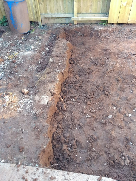

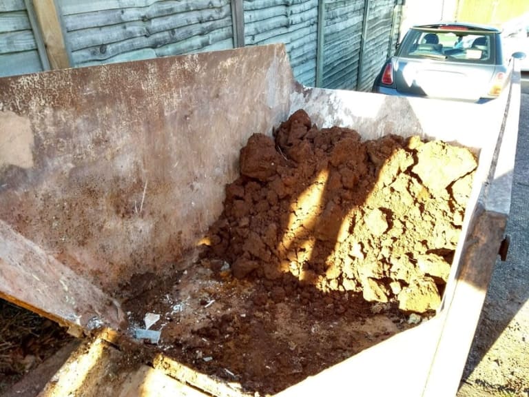

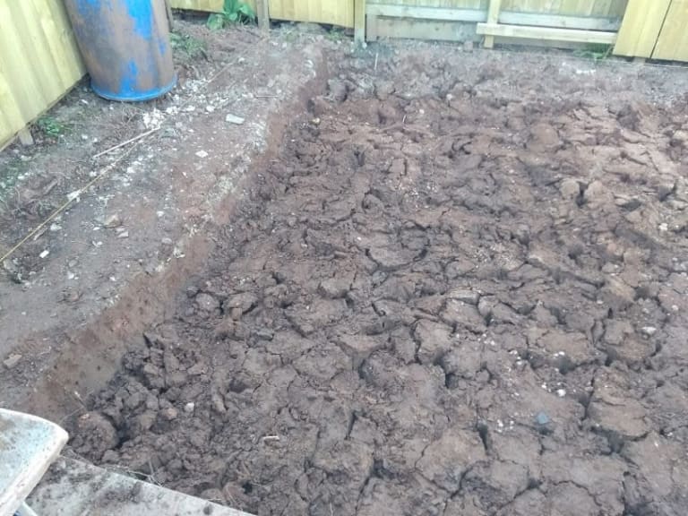

New skip and more digging
More digging
Got the area cut out down 300mm, need to dig another 300mm but boy the ground is hard at that depth. Dad and I took about half an hour to take out a metre squared with a pickaxe so I got the jack hammer out
All broken up and we should finish digging on Saturday.

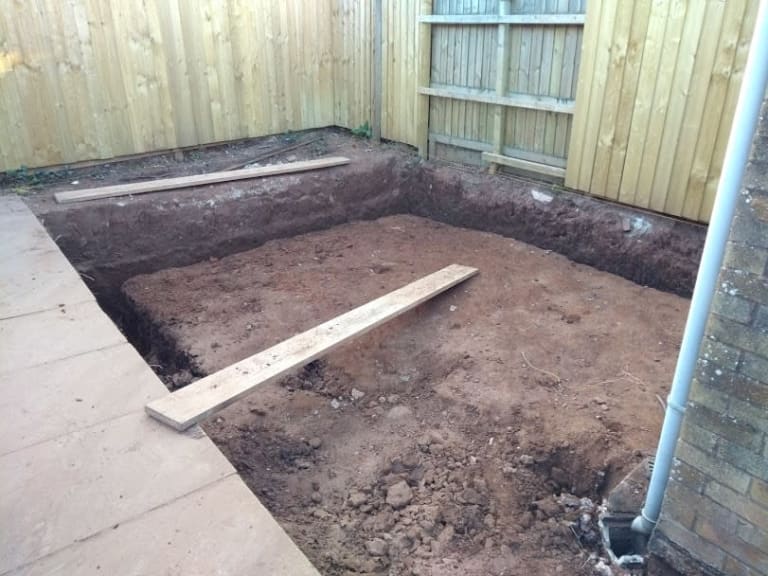

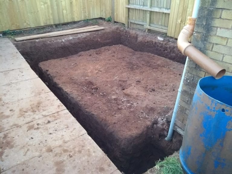

Yes got there finally.
The existing structure is on a raft so going to keep it the same. Compacted 803 sub base, reinforced 6" concrete on top. First course of bricks with visqueen membrane tucked over and then 3" screed to level with existing floor.

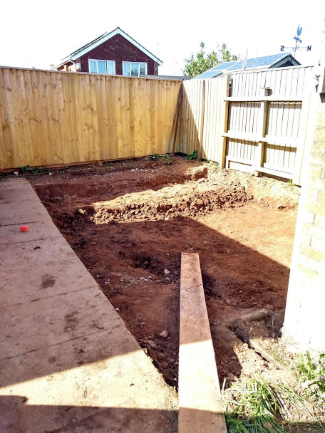

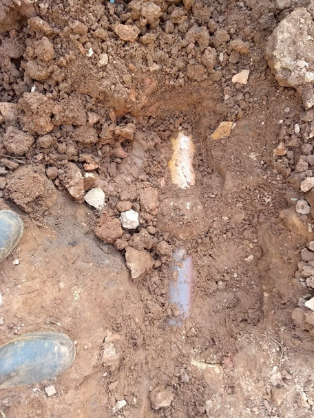

So last night i put in a few hours and found this beauty:
Fortunately in doesn't go anywhere and the end was covered in a cowl of bricks. Make shift soak away. Wasn't expecting to find it going in that direction but no problem as going to dig a drain going down to meet the existing drain.
Started digging at 8 am this morning
, pretty much cleared the area and filled another skip. Another coming on Monday.
Got folks coming round tomorrow to help bag the remaining bit. They are up on Monday and Tuesday to help nib away and ensure I have a consistent level for the slab

Uncharted services are a pain ain't they?
I found the original gas main and water main tucked in against the side of the house. Fair enough. The previous owner did say he'd had them replaced with alkathene pipes.
But we also found another 5 metal pipes of varying diameters running up through the excavation! Always a bit nerve racking to say the least!

Changed the plans lol

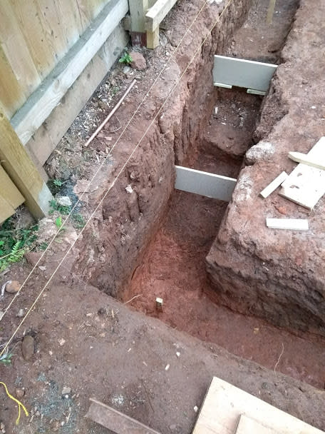

Going to go strip foundation, cleared the area down to around 2 foot.
Unfortunately there is an area in one corner where the earth is very soft so going to have to dig down any way so might as well put in strip foundations and go down with blocks a bit further than the other sides.

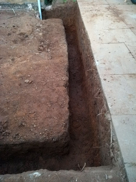

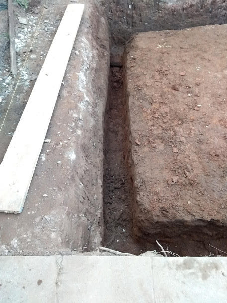

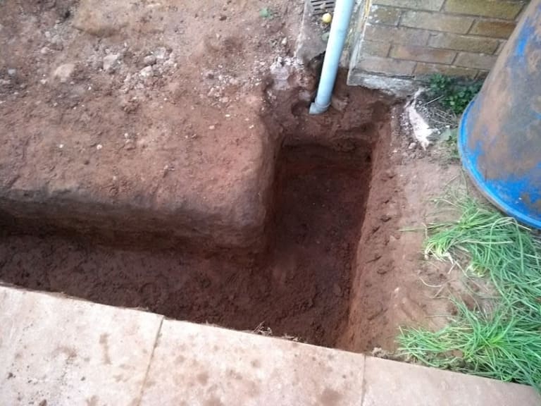

Today managed to get most of the trench dug out. Tomorrow morning should get it finished
Quite a bit done in the last few days. We've gone down over a metre in most of the trench and widened it to 500mm.
That's all the digging done phew
Next materials arrive on Tuesday and then tidy up the trench and get it ready for pouring concrete on 13th. Going to match the London buff bricks with the existing garage
. Should look the biz

It was nice to have last weekend as a break
So far this week….
Tidied the trench. Pegged out to 200mm for concrete
Material arrived at the break of dawn this morning
And carted to the back garden ready for Saturday
