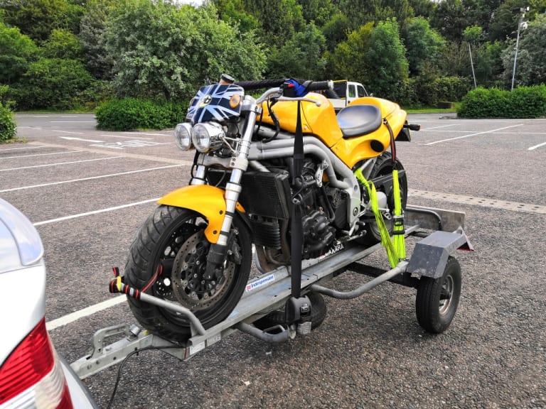

Picked up this low mileage but rough 1999 Daytona 995i last August for less than £900.
It came with all the original plastics and carbon race can and original clip on handlebars which I planned to keep
She wasn't pretty and was going to get worse before she got better but this is my 3rd Daytona and my 4th 955i engined Triumph so I'm hoping it's within my capabilties
By the time I removed all the bits I didn't want and sold the spares it owed me just under £500 so not an expensive project.

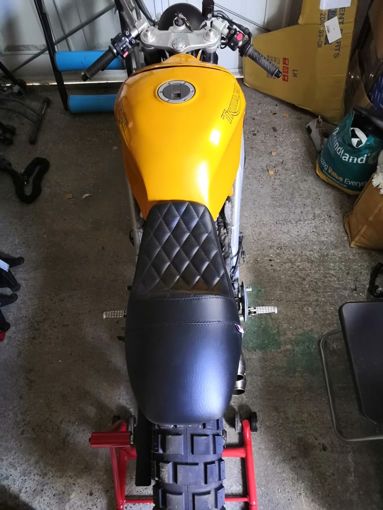

Next was to scrap the flat bar conversion (and sell for a tidy sum) before fitting the original bars, new 7" headlight with yellow lense and grille and billet brake fluid reservoir (not fitted in photo)

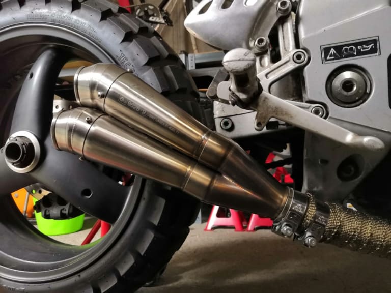

After 2 other purchases that didn't work out I settled on this duel tone laser exhaust and removed the rest of the system and wrapped it. These 3 cylinder engines sound beautiful and like nothing else on the road
Current rides:
Its going to sit about 3 inches taller at the back than before but being 6'2" that's not an issue and it means the numberplate can be mounted underneath in front of the back wheel

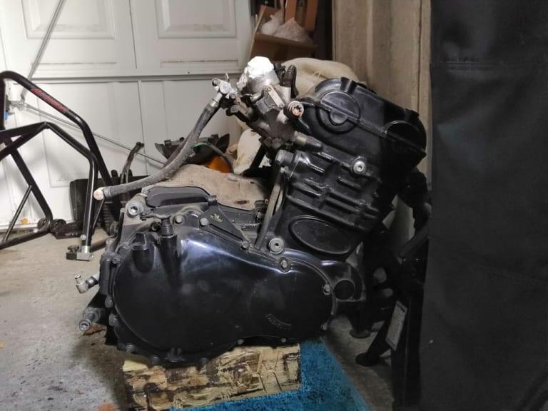

Removed the full loom and with the help of a label printer marked everything up, coolant system off and lump out
And its off to the fabricators, hard to believe but this is progress
