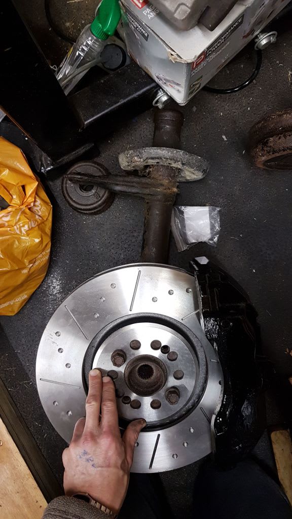

The previous owner allegedly spent a lot of money looking after it but everything that I inspect on it needs fixing. Already replaced the complete brake system, service components, etc., and the bodywork appears at some point to have been artificially distressed as there are scratches and dents in the most unlikely and improbable locations.

Just because I think that they will look really cool. Totally unnecessary stopping power given the gutless engine however
