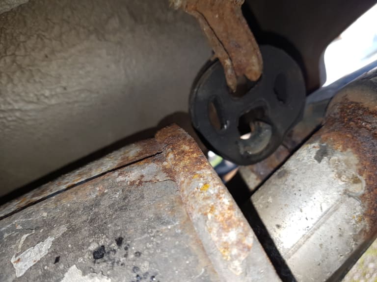

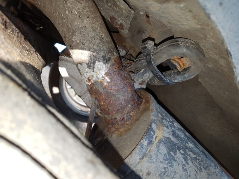

20161220_123004.jpg Fxxk I never noticed missing borbet cap.   Anyways today back from Saudi.  I replaced the hex bolts holding calipers on the rear for nice stainless  caphead.  Then inspected the exhaust hangers. That's next job i think I'll do..and maybe roof seal. 20161220_123009.jpg 20161220_122954.jpg

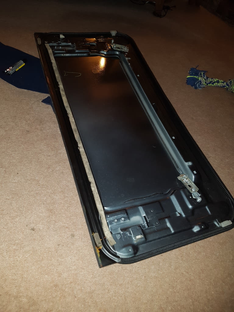

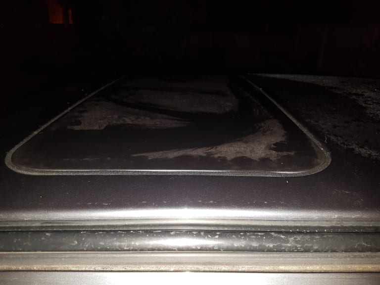

Today..or this afternoon I decided to have a go at sorting the sunroof seal. Well at least there's no rust. But im wondering why no clip to cover the join and why the previous joint was on the side. I've gone with joint at the rear next to the raintray where there is better chance of the leak being channelled. Also to protect bolt heads little bit of glue in the head to preserve the cross cut. Not really a job I fancied doing on the cold but needs must.

The outer seal is not actually a proper 'seal' (for water) it is there to keep the worst from cascading in and to keep leaves and rubbish out. That is why there isnt a clip on it and so the side  is okay and I think the new ones come shaped like that, generally.If you put joint at the back water could sit on it for longer.
Does it actually leak into the car? The photo's makes me think its all good and your replacing because of the cosmetics or ageing?
Does your sunroof when closing 'pop up' on the last few turns so that it is flush or very fractionally lower at the front with the roof line, and slightly higher at the rear?This stops water driving into the front  or sitting on the rear panel gap There are ramps/(cogs you might call them), which should be adjusted, each side, to get panel level left to right/front to back when closed. Sometimes due to wear these jump and the sunroof drops one side, and any misalignment will increase the chances of a damp head liner. Most importantly, make sure the 4 exit tubes let water pass through! test these individually as (especially the rear) can block with rust, or, debris blown in.Be careful not to dislodge inner connection tubes with strong air or anything you might want to put down them.

20161227_192146.jpg Thanks Marcus… theres a bit of water coming in to the headliner. And the seal had become detached completely on 1 edge.. I understand the function is to act as first seal and not to be 100% water tight but I'm thinking get it sorted then removes 1 concern. The drains I'll check with water and a wire to ensure clean. Sadly my garages are full of spares and not cars..so i was mainly trying to eliminate any leaks into the car.  Next is to fit rain scuttle /cover trays in engine bay. I did try seal to the side but my head said put it to the rear. 20161227_192135.jpg 20161227_174258.jpg 20161227_174305.jpg
