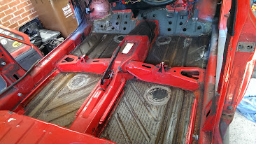

Then the welding started…
Then some underseal…
