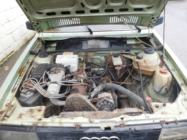

just got this off ebay, has been in a barn for 20 years.

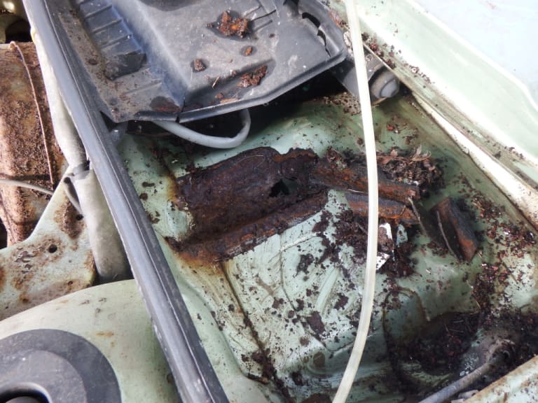

it will need work underneath and some welding on the arches, roof and c pillars but will leave the paint as it is, patch the repairs. trying to keep everything as original as i can.
i have got lots of old mk1 parts to try and revive the 1600 engine, its 110 bhp YZ engine with a really cool baffled alloy sump as they didnt have oil coolers

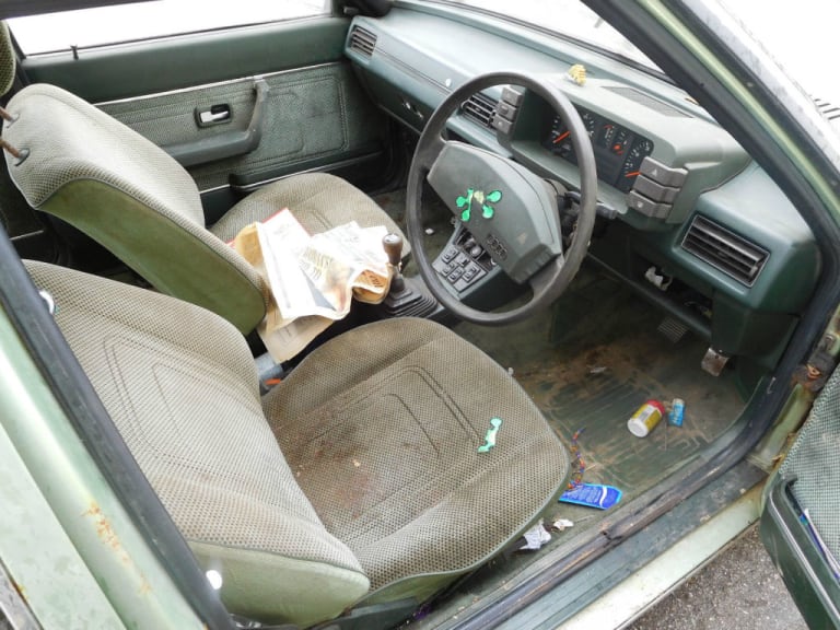

not been started since 1996 so first job was swap the old water pump as was covered in crusty coolant and had split a hose, also i need to fit my spare fuel pump and see if it runs, the injectors look like they may have rusted and cracked the seats so will check them before spending anything on the engine as it could need head removing. it turns over on the key, selects all gears, clutch seems to work, and most lights work
there is a bit of a dent in the door to pull out but overall its much better than i expected and looks like it should run without having to replace much.

Its got an old series 1 style fusebox with the bullet fuses, but has had another fuel pump relay added but it runs all the time, it looks like the old fuel pump relay is still in place too
this was the alloy thermostat housing when i got it off
the water pump
this is the rust that has come out the exhaust
