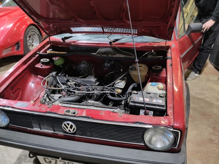

It's a '90 G reg, very very solid. No obvious rot anywhere - even in the hood area and fuel filler
It's on BBS reps, but I've sorted some tarantulas out
It needs a new clutch and its on webber carbs, so I need to decide if to take these off and go more original

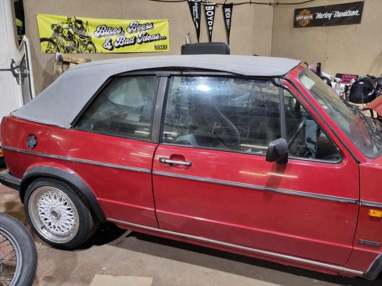

Small tear in roof at rear, and although its watertight it needs the cables adjusting/replacing on either side as they are a bit bowed. Might just put a mohair roof on - so need to investigate best place to do this.
Needs a bit of paint correction and small dent on drivers door sorting

As for the carb, I'd leave the weber on as they are generally more reliable and easier to get parts for.
Can't really help with your other questions as I'm not a cabby expert.
Does it have multiple carbs fitted?
Get some pics posted.
I'm very much not an expert but would be surprised if it's a clipper. I'll post more pics shortly…I haven't yet picked it up!
If it is a 1990 G Reg, looks like the clipper kit has been replaced with the old style small bumpers, wheel arch trims and grille. Although there are lots of other small details that some one could spot to see if its an older car re-registered?
Appears the single weber carb replacement for the factory 2E2 pierburg carb
As already mentioned a 1990 G reg car would of had the body kit fitted unless the car was made pre 1988 and sat unregistered, you can contact VW and get the build date to check, there's lots of threads on this as people check when there cars reach 40 years old and are road tax free.
It does look like someone has de kitted the car and fitted a early type grill and removed the spot lights, check to see if you have a couple of extra cables coming out of the headlight loom.
The roof, yes there is 2 side tension cables which look like they have snapped, you can fit new ones but if there is a tear in the roof you can't really repair them so new roof may be on the cards if funds allow.
The Webber carb 32/34 DMTL which you have is a direct replacement for the Pierburg that would of been on there from new, the Pierburg is a better carb but it's a real art to find anyone that can service or set them up to work right so most of the time a Webber carb is fitted as they have fixed jets and you can easily set up as you only have a mixture screw and idle speed to adjust so it's a really simple carb to work with.
From looking at the engine bay, a couple of things I've spotted, suspension top mounts are coming to the end of there life as the metal plate should be touching the rubber mount, they don't seem to last long and replacing them between 2 to 5 years is normal, having stiff coilovers does shorten their life or hitting pot holes or driving hard over very bumpy roads also does not help.
Get a blue coolant expansion tank cap as some of the black ones seem the fail or don't have a vent in case of to much pressure as this saves coolant hoses from busting.
It's a bit hard to see but check your clutch cable is sitting straight up from the gearbox end or the cable will rub of the gearbox making the clutch even heavier.
Check to see if there is a strengthening plate fitted on the bulk head where the clutch cable enters the cabin, it's behind the inlet manifold, if no plate fitted get one ASAP or one day the cable will rip a hole in the bulkhead, if not sure post up a picture and we can tell if there is one.
They are great cars and if looked after and regular serviced very reliable and great fun to drive, mines a daily drive for the last 27 years and it still puts a smile on my face and not let me down even after 321,000 miles.

The reason why your roof bows up frowning is due to it shrinking.
Even if the cables are snapped putting new on would not un shrink the roof.
Once these hoods shrink they often become porous so will allow moisture in. This can rot the actual top frame.
Take the time to watch the video to give you an overview of the top section construction.
