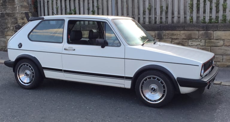

Welcome to my build thread.
Some of you will know this car from its reg, I've had this now for about a year so I'll put up what it's been through the last year.
This is how it started out but with different wheels.

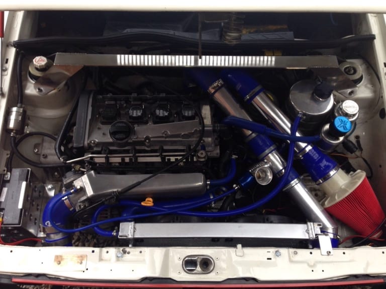

So
peterg60
to the rescue again (without him I wouldn't of got this motor right).

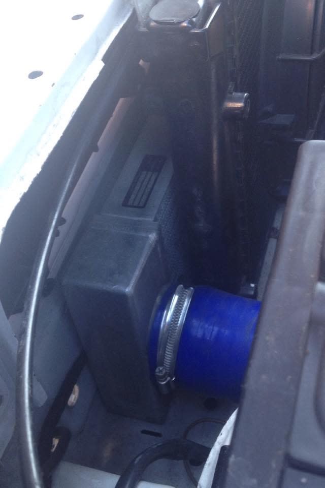

He suggested which intercooler to fit which turns out to be x4 the surface area of the one that's fitted plus it would get air.
Which radiator to upgrade to which was x2 bigger plus I could run x2 10" fans. Also drain and replace coolant with new temp stat.
We wasn't sure about the fuel pump problem as the standard pumps are good for plenty of pressure. But the pump did fail with 3 weeks so had to be replaced anyway. We decided to replace the 380cc injectors for 440cc green gaint ones to make sure we could have plenty of fuel.
The air intake been on the left of the engine it was just sucking hot air in from the engine, so I decided to repipe the intercooler system to get the air filter over the gearbox side.
This then ment I had to relocate the battery to the other side and fabricate a battery holder.
The air filter was also replaced with a Honda S2000 stock filter.
When I finished all this conversion the temp gauge was climbing too high when we noticed the motor had the wrong temp gauge stat so was reading high. I fitted the yellow band stay to make it read correct.

So this is how the engine ended up looking.

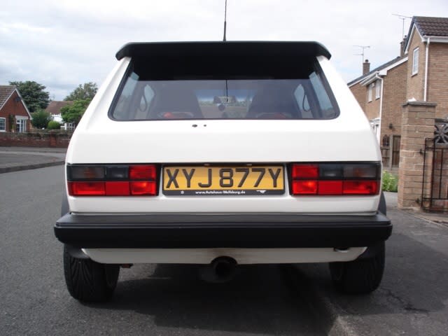

As you can see from the first photos the exhaust was centre exit and also went under the axle so not a good idea.
Thanks to tony banks exhausts in leeds we relocated it to the standard position and gave it a standard look. mellowyellow then replaced the rear panel to make the bodywork back to standard. Also making sure it followed the correct route over the axle.

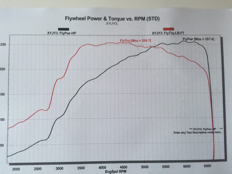

Yesterday was dyno day two.
This time I was using efi parts at Runcorn who also had good experience of dta units.
I arrived and had to fit my bigger injectors which then didn't fit the inlet manifold so a bit of modification work and we got them in.
Next was getting rid of the manual bleed valve as they are a bad idea when trying to regulate boost.
I opted for a n75j controller which I had wired into the dta ecu so hopefully he duty can be added to keep he boost stable at the top end.
Chris worked on the car for about four hours making adjustments.
We were having trouble keeping the boost high as the actuator spring wasn't holding, we adjusted the wastage more as managed about 23psi in the end.
So even after all this money and hours I've piled into a still didn't make the bhp it was ment to have.
Anyway I'm happy enough that it's safe at the power.

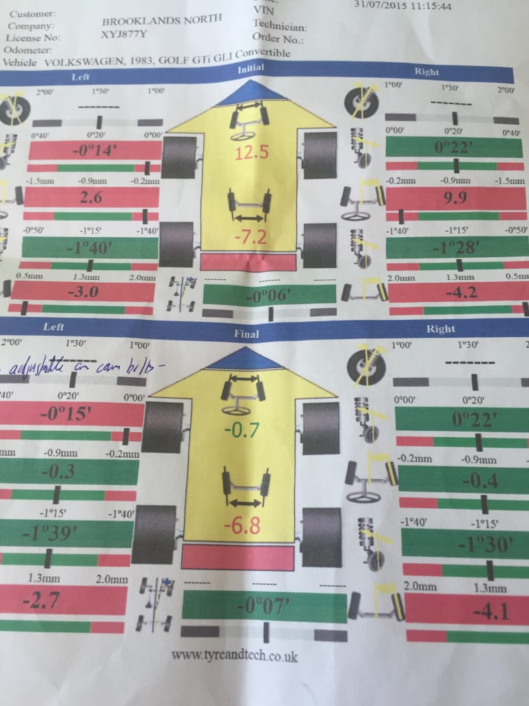

I sent my golf over to my brothers while I went on holiday for a month which is when he replaced the rear panel.
I was chatting about the handling as how vague it felt. The cars fully polybushed so should be like a train on rails.
Luckily my bother runs a bodyshop so we have good facility's.
On a good inspection so issues were found, the handling does have issues as it was tested by a few repair guys.
So on the ramp it went.
The drive shaft bolts were all hanging out and he drive shaft was ready to drop off.
The left rear hub bolts were loose.
The tracking was out
The steering rack has play.
The front left koni rebounds at a slower rate to the right.
The polybushes were checked for play and were ok.
A ball joint had also failed which we replaced.
We put the car on the jig to check its alignment and its had a little knock on the front chasis leg but pretty minor. So next up is a complete replacement suspension kit, I think I've decided on the bc racing coilovers @ £650 a set, a new steering rack @ £60 then another tracking session to see what happens next.

I was hoping for more to be honest, if it was ment to have an approx of 260-270 then after all that cash on upgrades I thought it would pull more.
But since I've research the limits of the ko3's hybrid that 257 I got was very good.
If I want more the next would be beach buggy hybrid to take me over 300bhp.
I need to sort out the scary handling first 😳

The play was seen between the joint of the column and the rack itself.
I've not replace the rack yet but the classic vw one will be used.
The tracking was all adjust (apart from the camber on the near side shock as they will be getting replaced)
