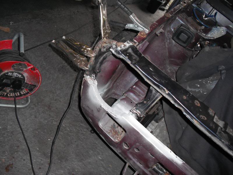

Front panel was to messed with and full of filler…..GENWINE replacement top half sourced - thanks "peter davies"

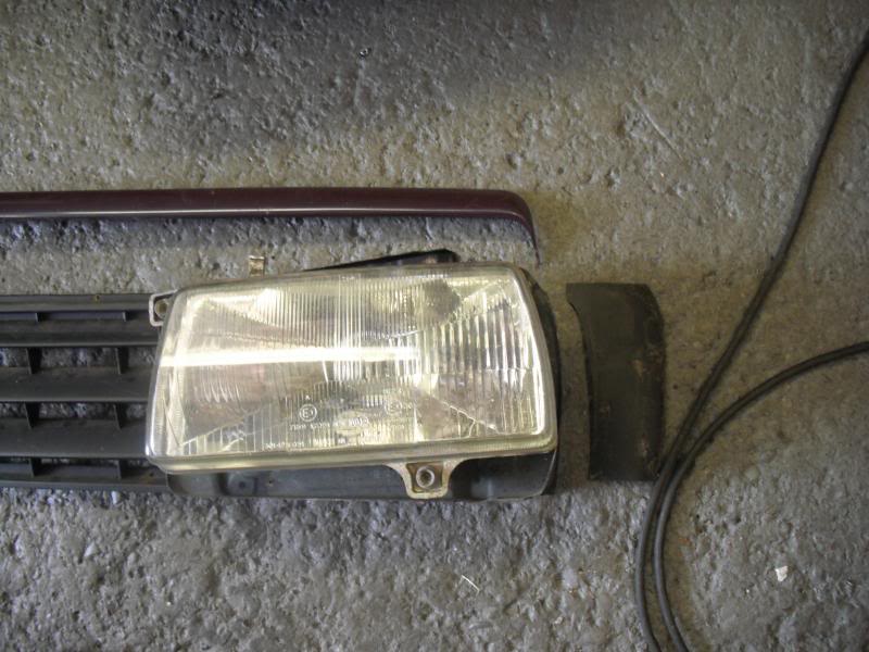

circular headlight section of the lower half front panel was filled with filler!!!!! no good….

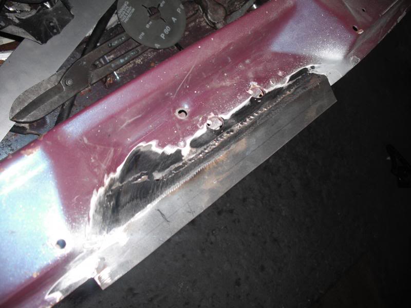

new section, welded in position, headlights & grill test fit…..looks so much better.

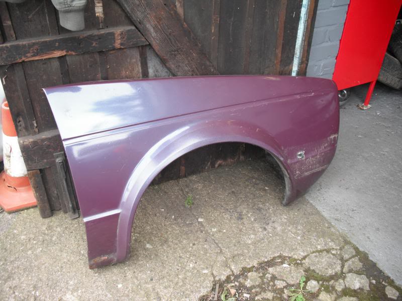

Wings removed, inner arches pressure washed & wire brushed clean, and repaired:

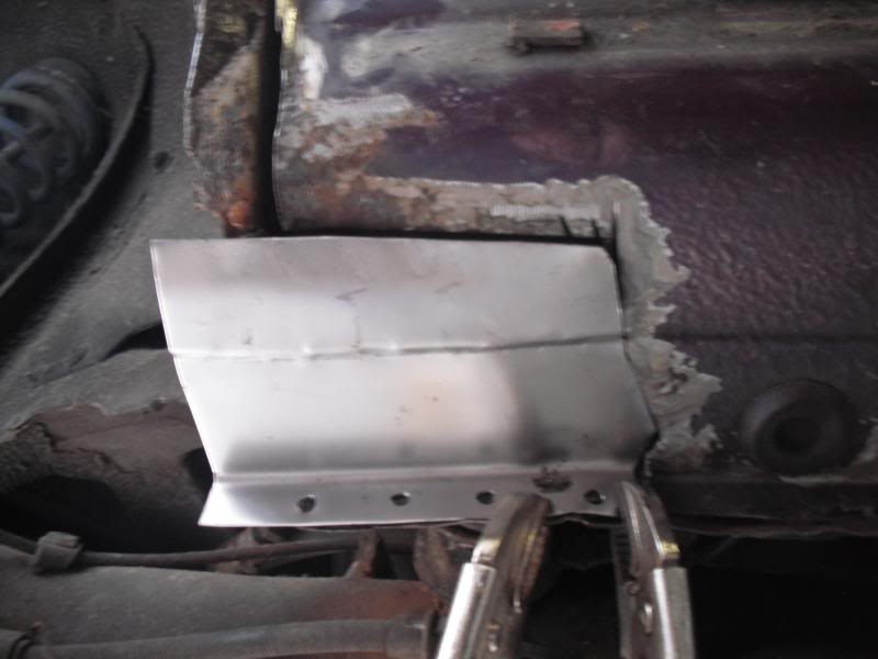

made this replacement section made - hand shaped and a prefect fit for the sill…
all the other rear arches had small repairs also…

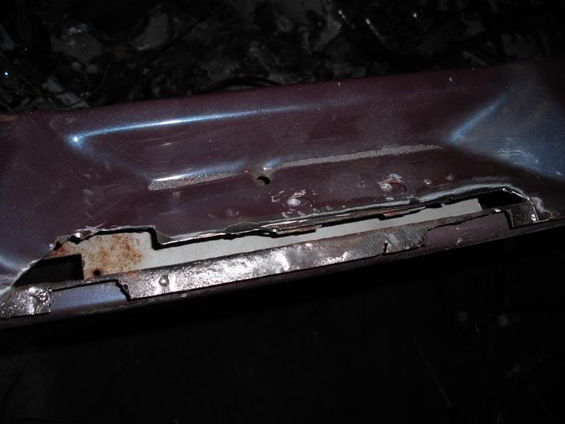

Rear Panel was solid apart from the bottom lip to boot floor and top inner edge. Decide to repair them instead of replace the panel. also the spare wheel well need a repair too.
another handmade panel :

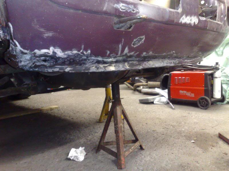

lower edge of the front panel was bent up, looks like it hit a kerb/speed hump or even jack up on…this was heated and straightened - no issues…cleaned, treated and primered:

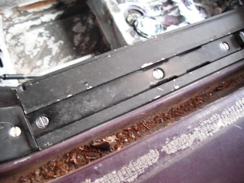

Sunroof - this was the first thing i checked when i went to see this car……give it a good jabbing with a screwdriver……solid, just surface scabs….. the sunroof panel itself was rotten, the outer seal was shredded and the track - half missing. Thanks to "BERT" - a replacement mk2 golf complete sunroof was purchased.
Still required work ,so ground back to metal, cleaned, treated, cleaned again, tube seam sealed around the joining of metal and primered:
New Stainless steel screws, washers and bolts for the sunroof track:
also had to buy myself a nut riveter, as some of the original fixing on the sunroof had come away- so i replaced all of them…dont seem to have a pic, but will get one 2mo for you.

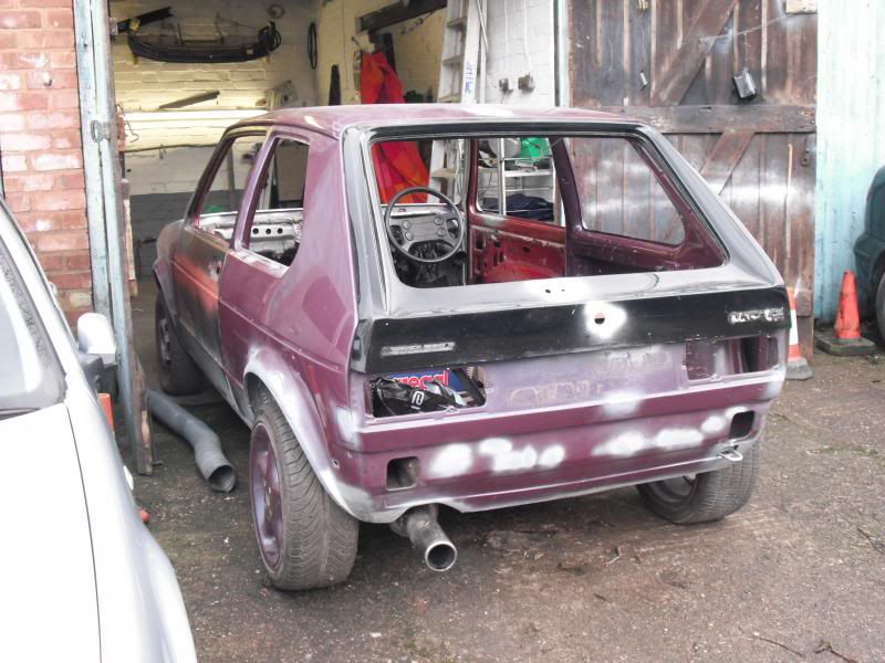

This was pretty much the external bodywork done, well my bit anyway…..like previously stated…..i'm not a man of filler and paint work.

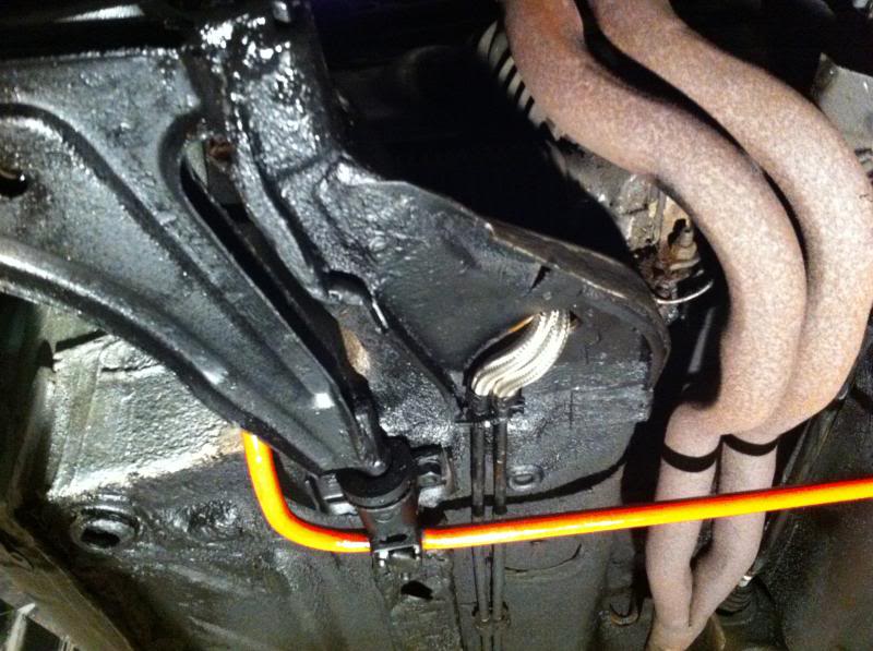

Suspension replaced and refurbed as well as the wishbones,anti roll bars and brakes:
Whilst taking the anti roll bar off, i manage to twist the brackets……so i made my own out of stainless steel:
Skip a few steps and this is the end result: - notice the braided stainless stain brake hoses (goodridge)
