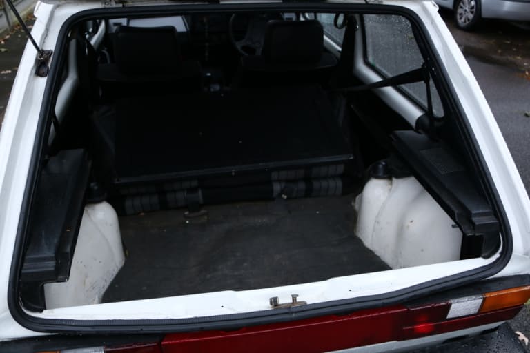

i was shock at just how easy this bench came out but not complaining. i have next to no storage space so nearly everything being removed will be going up for sale
i whipped out the rear bench and removed the boot liner, i had fitted a new sound system into the car only a few weeks ago so thats what all the excess wiring is for it ran to the amp and sub in the boot. i will see what i can get done tomorrow with a couple of hours to spare hopefully get the dash and the front seats out along with the front and rear bumpers.

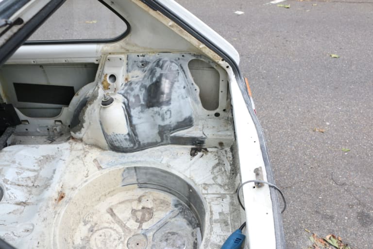

there was quite a few holes in the floor pan that where covered by tape and then had original paint over them. any ideas why these are here? and why they would have a tape over them and then painted over.. i want a clean floor so i may have to have these welded up. they are either side of the spare wheel well and in between the well and the petrol tank area..
before i started today..
![IMG_5120.JPG IMG_5120.JPG](https://res.cloudinary.com/mk1-golf-owners-club/image/upload/c_limit,w_768,f_auto,q_auto/v1473008004/uploads/attachments/57cc5181b28a4.jpg)
![IMG_5122.JPG IMG_5122.JPG](https://res.cloudinary.com/mk1-golf-owners-club/image/upload/c_limit,w_768,f_auto,q_auto/v1473008007/uploads/attachments/57cc518637405.jpg)
and after a couple of hours..
![IMG_5147.JPG IMG_5147.JPG](https://res.cloudinary.com/mk1-golf-owners-club/image/upload/c_limit,w_768,f_auto,q_auto/v1473008011/uploads/attachments/57cc5189dacce.jpg)
![IMG_5148.JPG IMG_5148.JPG](https://res.cloudinary.com/mk1-golf-owners-club/image/upload/c_limit,w_768,f_auto,q_auto/v1473008016/uploads/attachments/57cc518e1c9b9.jpg)
![IMG_5167.JPG IMG_5167.JPG](https://res.cloudinary.com/mk1-golf-owners-club/image/upload/c_limit,w_768,f_auto,q_auto/v1473008020/uploads/attachments/57cc51927c1a0.jpg)
![IMG_5174.JPG IMG_5174.JPG](https://res.cloudinary.com/mk1-golf-owners-club/image/upload/c_limit,w_768,f_auto,q_auto/v1473008023/uploads/attachments/57cc519602493.jpg)
![IMG_5177.JPG IMG_5177.JPG](https://res.cloudinary.com/mk1-golf-owners-club/image/upload/c_limit,w_768,f_auto,q_auto/v1473008027/uploads/attachments/57cc5199c818f.jpg)

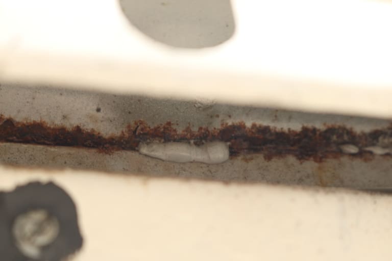

the very rear of the spare wheel well has rotted through its had a previous repair because it has a plate underneath the rotten area and had some kind of filler in there too.. there are also at least 5 holes in the wheel well that look like they have been purposely drilled so i am im not sure weather to try and cut out the small 4 -5 inch section of this and piece it in or do away with the spare wheel well completely this would also enable me to have a custom style exhaust with a centre exit..
also discovered that the rear panel will definitely need replacing there is a long line of rust/rot right up inside the lip that the bottom of the boot lid sits onto.. basically up inside the rear panel where the boot lock sits.. i can see from the outside the rubber seal has been glued on over the top of this rot.. and from crouching down inside the boot of the car and looking up you can see it has rotted all the way through and has been filled with several different colours/types of filler over the years.. NOT what i wanted to find but oh well.

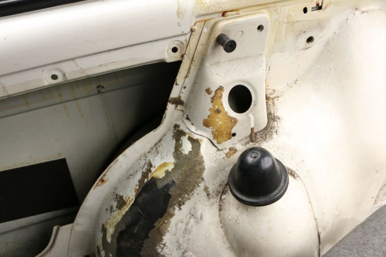

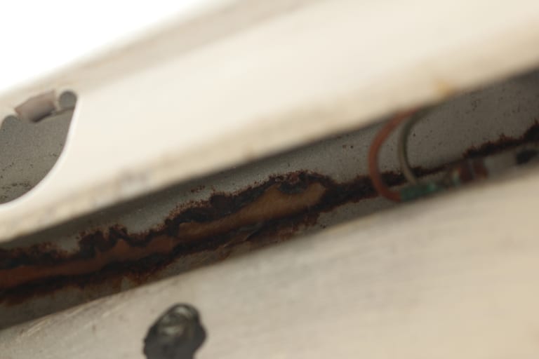

quite a mess made by someone in the past in the back passenger side corner a patch over a patch
![:(](https://vwgolfmk1.org.uk/themes/default/images/ocf_emoticons/sad.png)
the back drivers side corner has some rot at the very end of the chassis leg the lip that folds up ont the rear panel has rusted through. so when my rear panel is taken off i wont have a lip to fix to. i will have to add one at that time of the panel going on i guess.
