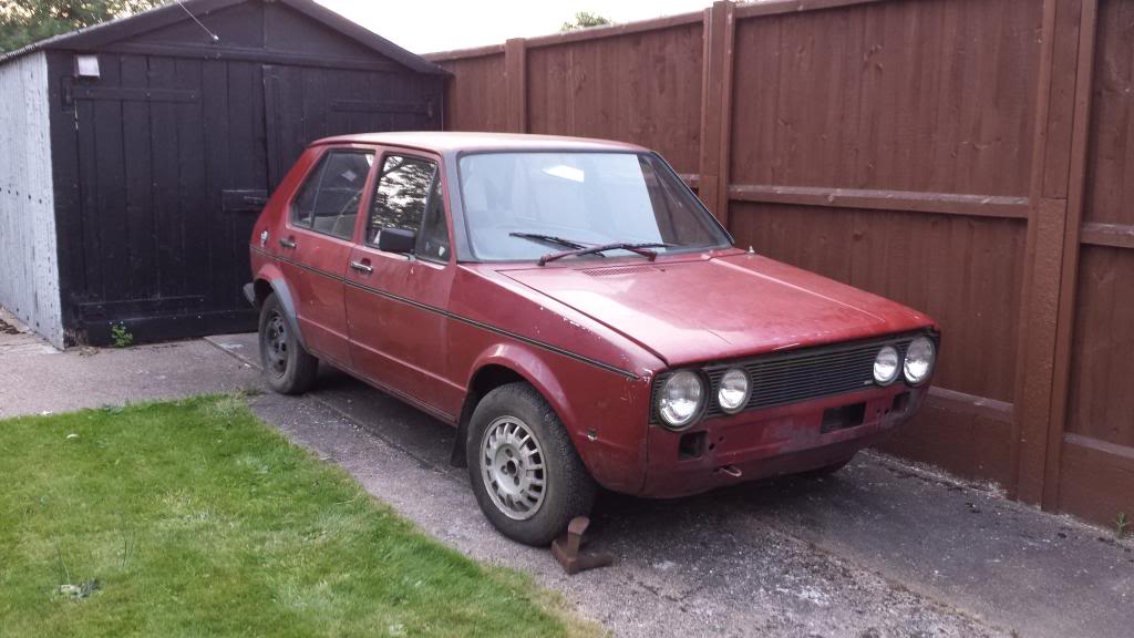

How she looked when I picked her up.

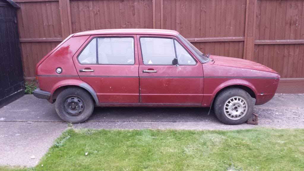

How she looked when I got her home.
Goly The Golf, a 1983 5dr 1.3cl having a full resto.
You guys must be mad. I'm stressed enough with one.
Looks like she needs saving mate. Good luck with the project
But can't beat breathing life back into the mk1's :-)
