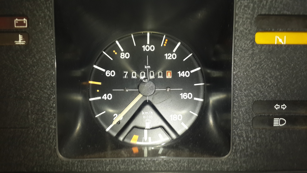

Genuine km reading…

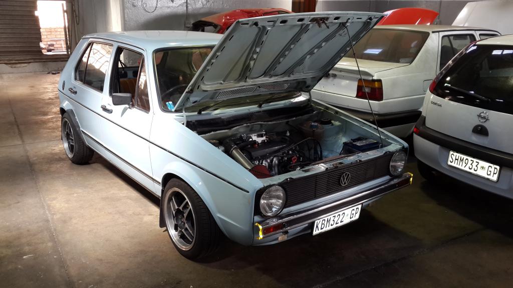

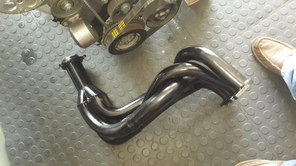

The motor is the one out of my race car, I will be detuning it a bit - shorter ram tubes (60mm vs 160mm) so that I can fit air filters, more restrictive (read quieter) exhaust and a more conservative state of tune to allow me to use 95 octane pump fuel. Even so I will be picking up more than 30wkw and 40Nm over the workled 8V that is coming out (and going into my Citi Golf project). I'm really looking forward to driving this car, performance should be extremely lively on the road. I will also be fitting coil overs and upgrading the brakes at the same time, 280mm disks up front and rear disk conversion to go with the booster delete already done previously.

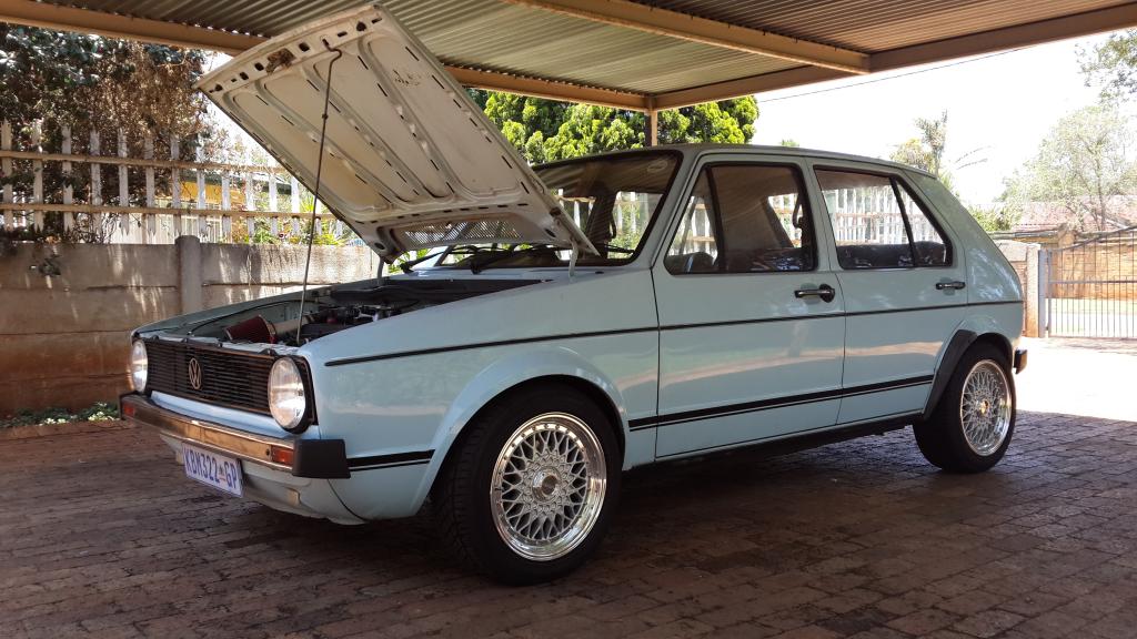

Took the LS for a last drive, parked and began stripping it. Yanked out the 2.0 8V, gearbox, suspension, brakes and steering. Fitted a new master cylinder, OEM steering rack, coil overs, big brake (280mm) upgrade in the front and discs in the rear, poly mounts all around, front bottom strut brace and rear anti roll bar. Fitted the motor comprehensively modded 2.1 ABF with throttles and rod shift gearbox with custom ratios. High c/r running on a 50% Ethanol mix should see about 70 whp more than the 8V, car was no slouch with the old motor but should be a demon with the new one, can't wait to take it for a spin…
