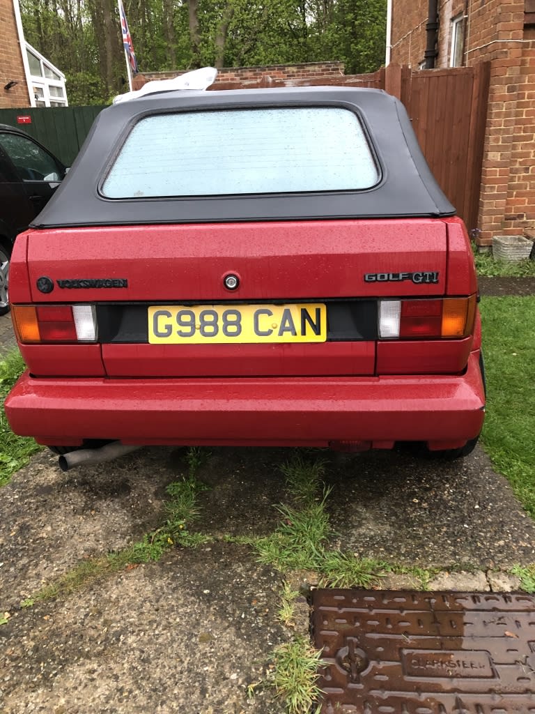

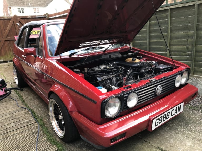

So i brought this 1990 Gti cabby in Paprika red last week, last owner had it 4 years and never used it!! It was either outside and covered over or parked in a workshop
someone slashed the roof trying to break into it at some point, why not just break a window? Lol
this is the 8th Mk1 i have Owned now, and the 3rd Mk1 cabriolet, i sold my red sport line cabby about 10 years ago now and have regretted it ever since :(with some attention to detail and a few minor fixes I’m sure this one will be just as good a car, it’s a solid basis to start with at least, interior complete! Exterior complete! Nothing missing or badly broken! Engine and gearbox original to car! It has done 168k and it starts and runs perfectly, electric hood works, interior is dry as a bone despite the hood rip (which isn’t now covered in “black nasty” army tape lol
big pile of history including most old mot’s, genuine keys, including the little silver “master” key , unheard of for me to have one of those :lol:needs a back box, some minor electrical issue sorting as wiper, radio, blower don’t work, on little inspection seems someone’s removed an alarm from it at some stage and dislodged 4 wires on the fuse box, trouble is, auto electrics is the least of my expertise! And i can’t see where or know where they connect to, I’m sure it’s an easy fix though
Appears to be a slight knock on the steering which seems is likely to be the top bearing near the wheel or the rack knuckle from a quick glance, haven’t checked the mount yet but they are often cracked! O_opaint is 2k ie no lacquer and was in need of some serious revival which i have begun doing
plans are all mechanicals checked and anything needing it replaced, get everything sorted for Mot time and then do the remaining cosmetics like the roof, decide on what wheels i will run it on and just enjoy driving it
it will make a change not to be able to see the fuel gauge on a car not moving much :lol: unlike my other cars
day i picked it up last Sunday

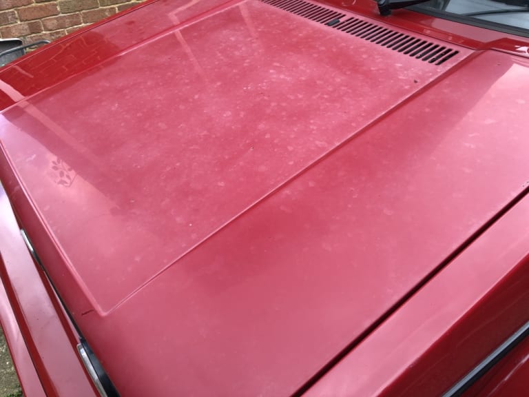

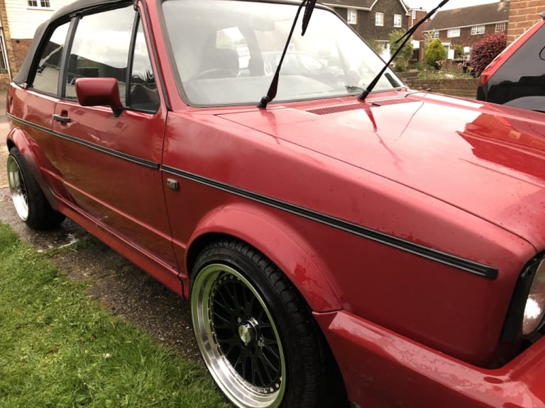

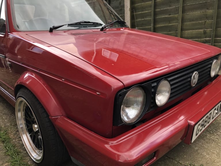

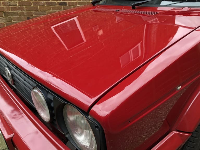

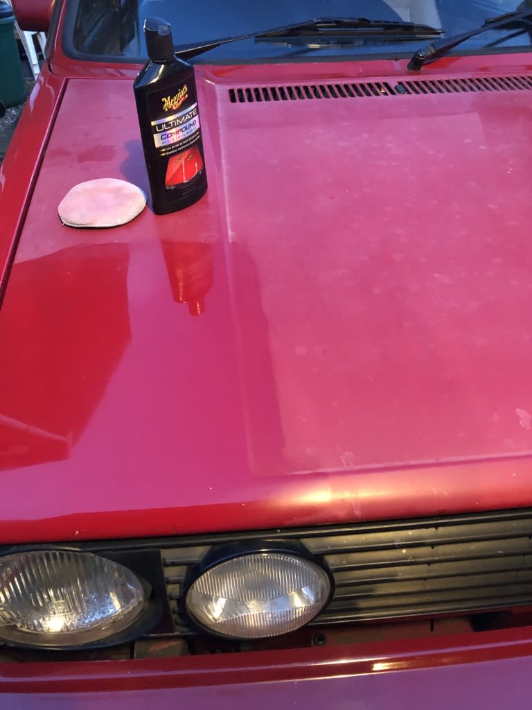

And how it's looking now with some detailing work done to the paint, using meguiars products and Da polisher 0FE17A03-C997-4304-BD4A-3BB211640DE9.jpeg 8F6438B9-C15F-4E6A-9991-1EF9B9D2312A.jpeg 4AEFC1F7-A479-4C0B-8C47-98A79FC25DE3.jpeg 8CFD8BBB-50BE-4EBB-9EE3-67E6188AE408.jpeg FA420B92-E864-46C0-9D13-9C6588C402A1.jpeg 7A40DF59-55A0-4E09-B1FD-0531E6CFBAFD.jpeg 496E6B48-700D-4A60-99EC-E0F75CED7A92.jpeg F1E7071B-B29E-45D7-8DAA-66C3310D02A2.jpeg

Wow that paints come up well…

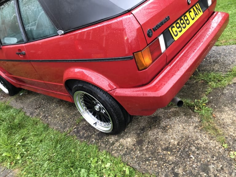

Exhaust looks at the wrong angle, might be a Mk2 Scirocco exhaust as it's not right, good job it needs a new exhaust as that will tidy it up nicely.  :thumbs:

 yeah not sure on the exhaust? Although it fits perfectly to the car and has the little kink on the outlet to miss the clipper kit?
Its getting replaced anyway
Knowing me for a custom stainless one i expect lol
