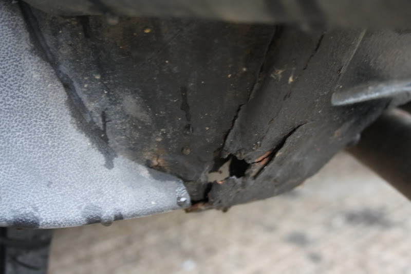

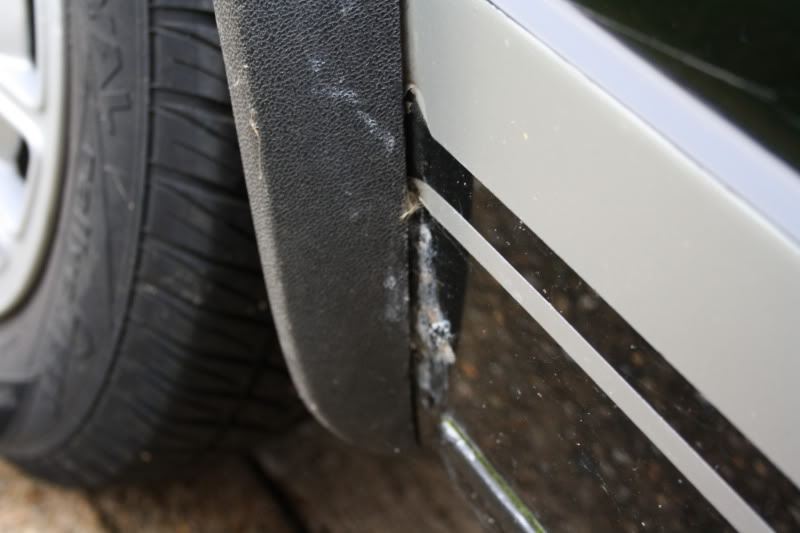

Been after a mk1 golf gti non sunroof model for a while now and as i sold my caddyvan tdi last saturday, it gave me a bigger budget to buy one. Well once i could find a decent non sunroof model anyway lol. This one came up on my local forum in the end. After a few days, we came to agreement on the price and i picked this up last night. Ran out of fuel 3 odd miles from home but i got back in the end. Failed to start this morning, suspected WUR so left it til later. Tried again when warmer but no luck so i stuck a fresh can of fuel in. Battery had died after so many times turning it over though. Its re-charging now. Kind of hoping its not sucked up crud from the tank as i know mk1's are common for rusting inside out. Hopefully update later with it starting. I'll let the pic's do the talking I know too well about the rotten arches on mk1 gti's but think these are pretty good for the age. The fronts look fine but the rears look like this Think i'll leave the arch spats on for now lol rear valance The front panel and wings are very good, as is round the windows. Its basically bog standard other than its been lowered on weitec springs and adjustable damping shocks, obviously it wont stay like this for long haha. Got a good few things to sort for its MOT but otherwise i very happy with it. Already started doing a few things which i'll probs update again later Hope you likey

Shame it's the rear arches and ot the fronts. Doesn't look too bad overall though.
TBH, i pleased its the rears. Genuine wings are expensive

Sounds like a good price for the shocks even though, as you say they're not the greatest. Probably better than 20-odd year old originals though!
Good to hear it's passed the MOT, means you can have some fun with it whilst the weather is just about OK.
For me without any welding skills I'd prefer rusy front wings that, whilst not cheap, are easy to replace.  But I guess that's not a problem for you.
