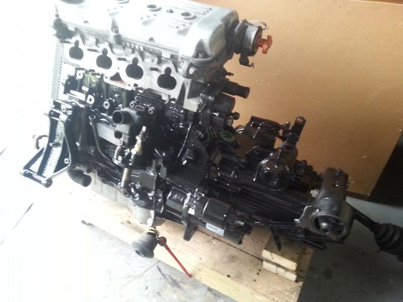

Engine Degreased
Bits removed from engine
Painted bits
Some bits arrived
New coolant pipe to replace bodged one
Engine painted with por 15 engine enamel
Painted bits bolted back on starting to look nice

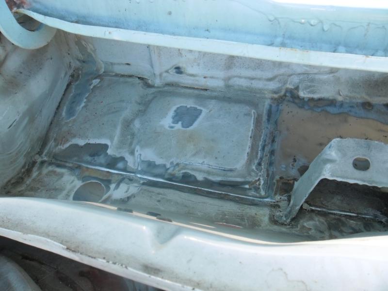

first welds
ground back
took the rubber bungs out aswell to be welded
Plates welded on the back also seam sealed these so no water can get into the welds
Decided to weld the ones up in the rain tray aswell as they are not needed
plates made
welded and grinded back
Starting now on the filler this week …let me know what you think guys …thanks jamie

not the neatest welding still learning ground down okay though

Think my weldings getting better don't think I done too bad considering not done much welding befor
all ground down
