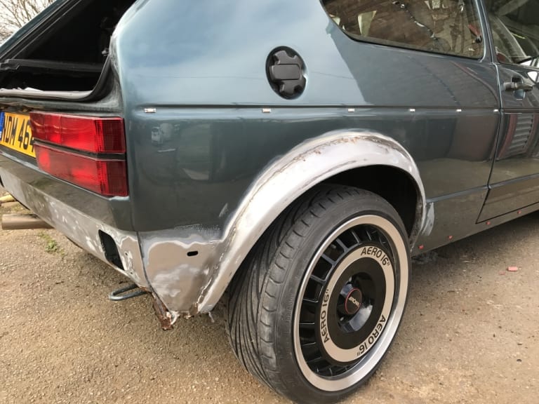

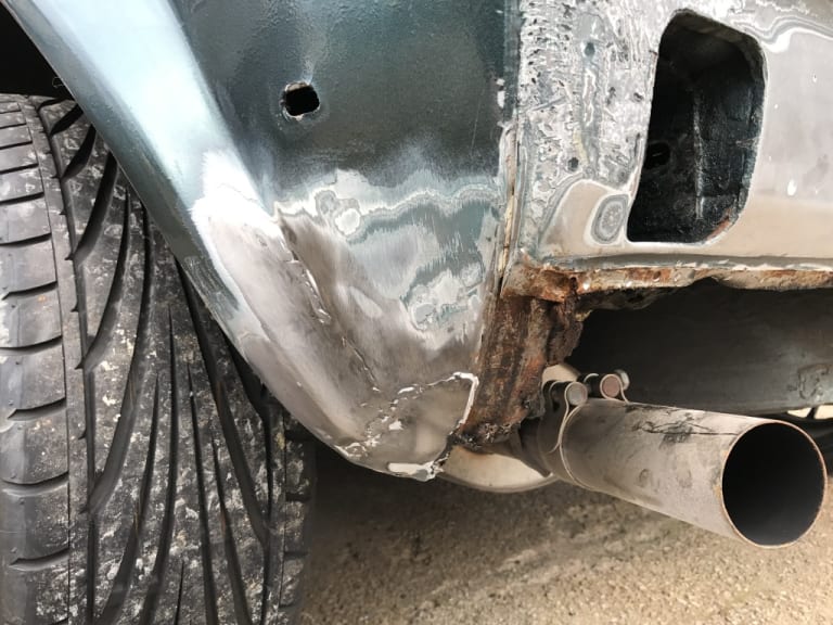

It's amazing what is behind some small rust bubbles :-(
Had a couple of patches of rust appear on the rear arches - found out the full extent of the rot today, fortunately it is confined to the arch corners and the very lower part of the rear valance - the drivers side arch is coming off though as a previous arch repair is beyond words, there was nearly half an inch of filler on the bodged welds !!

Ouch. At least it's getting sorted before it gets any worse  :thumbs:
I feel your pain, mine started from a few rust bubbles and behind it was a load of bodged welds!
Like Mike said, least its getting sorted!  :thumbs:
Rust is like an iceburg - you only see around 30% of what is really there!
I'm sure you being you, Ade, will get it sorted properly!!
Fair play there are some cowboys around… now in the sheriffs hands :lol:

Bit of an update, the drivers side arch is off, there were two arches there, one stuck on top of the other!
The inner arch lip has gone, so the lip will be replaced, the inner arch itself does not look too bad, well apart form the ends :-)
They have built up the rear passenger corner, we were wondering whether to take the passenger side arch off as well, but it has not bubbled in 6 years so I think we are going to leave it alone and just repair the inner and out ends.
