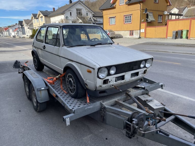

Picking up the car:

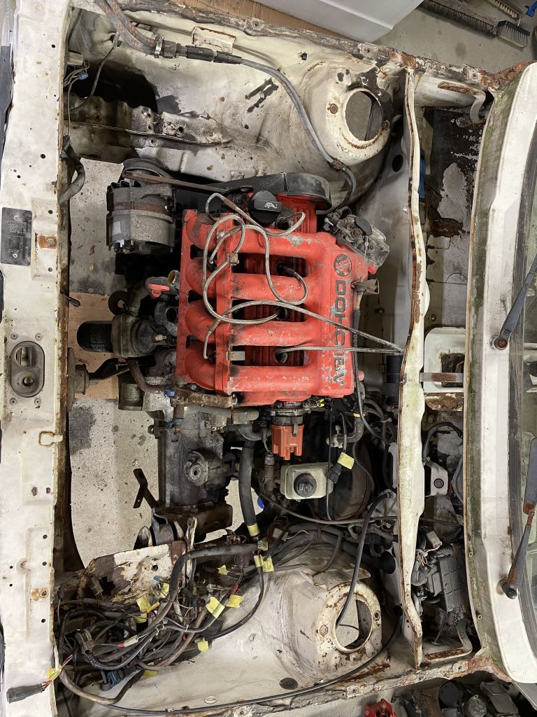

The engine bay when picking it up:

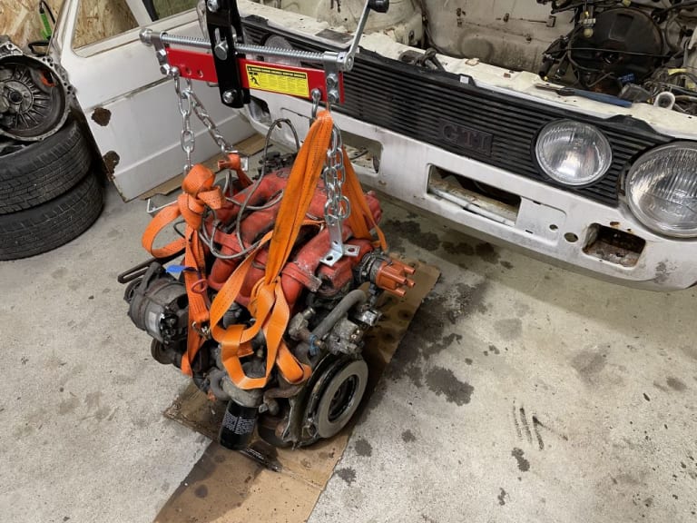

I'm hoping to be able to remove the engine this weekend. Something I've never done before - but I'm taking a lot of pictures, putting parts in boxes, screws in plastic bags and labelling as much as possible.

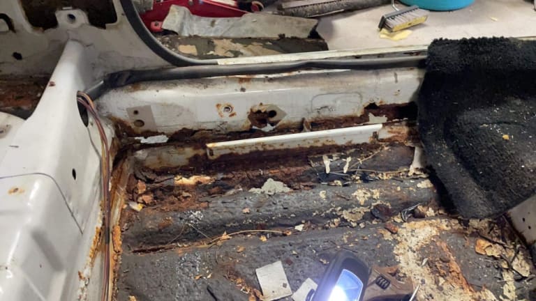

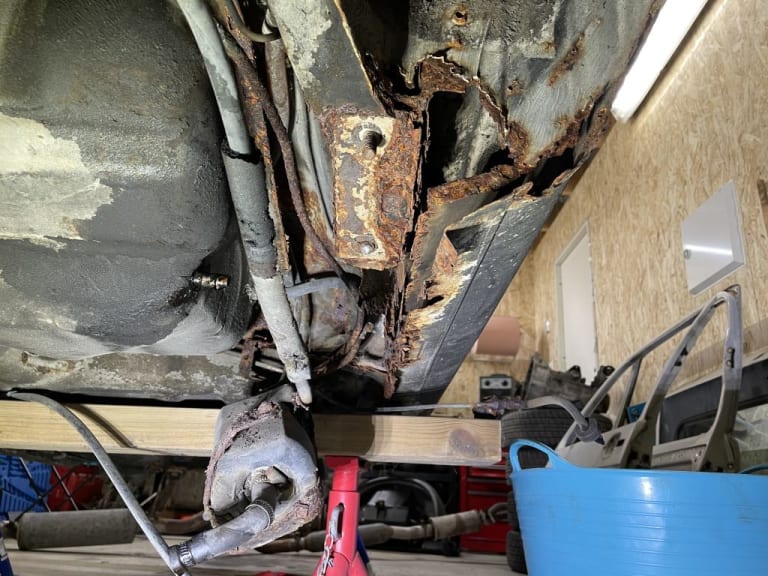

This is the driver (left) side. It is not shown in this picture but both floors needs to be replaced.

I've also started removing things from the engine bay and hopefully it won't be long before I can pull out the engine

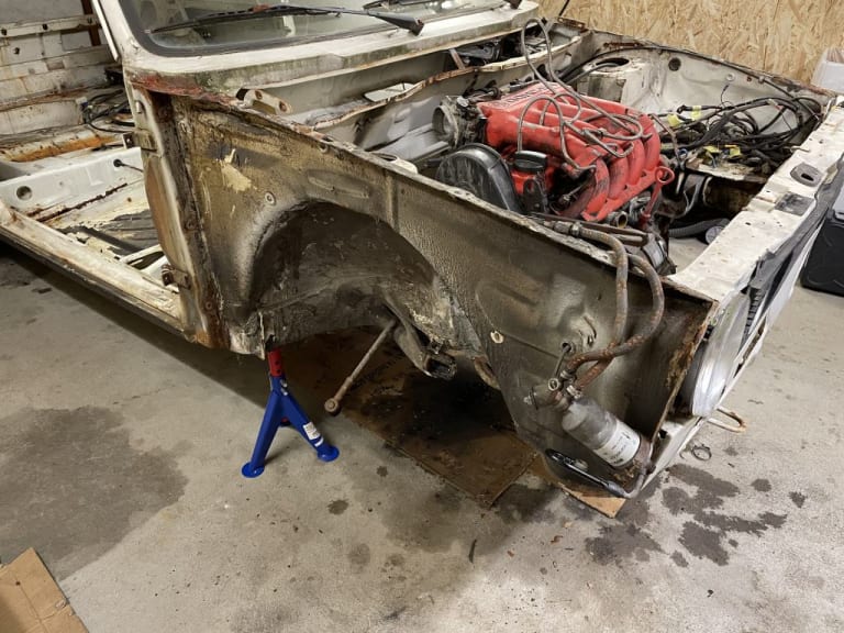

Thank you, and I agree - they doesn't look that bad. I think the reason may be as simple as they been protected from water. My theory is that most of the other rust is a result of the car standing outside and not in use for over 20 years, and the fact that the sunroof was not tight/fully closed so water could get in and stay there.tomsdubs said
Nice work mate, those inner wings are surprisingly good.
If I can get this back in working condition I would say anything is possible. At this point I'm seriously considering wether spending £1500 on sandblasting is the right thing to do. But still keeping fingers crossed
Apart from roof it all looks like normal old car rotten floor and sills. A bit of a weldathon but repair panels are available and it can be made good.
