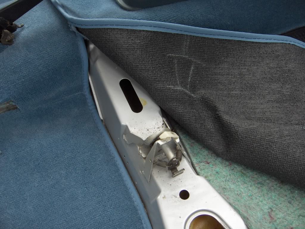

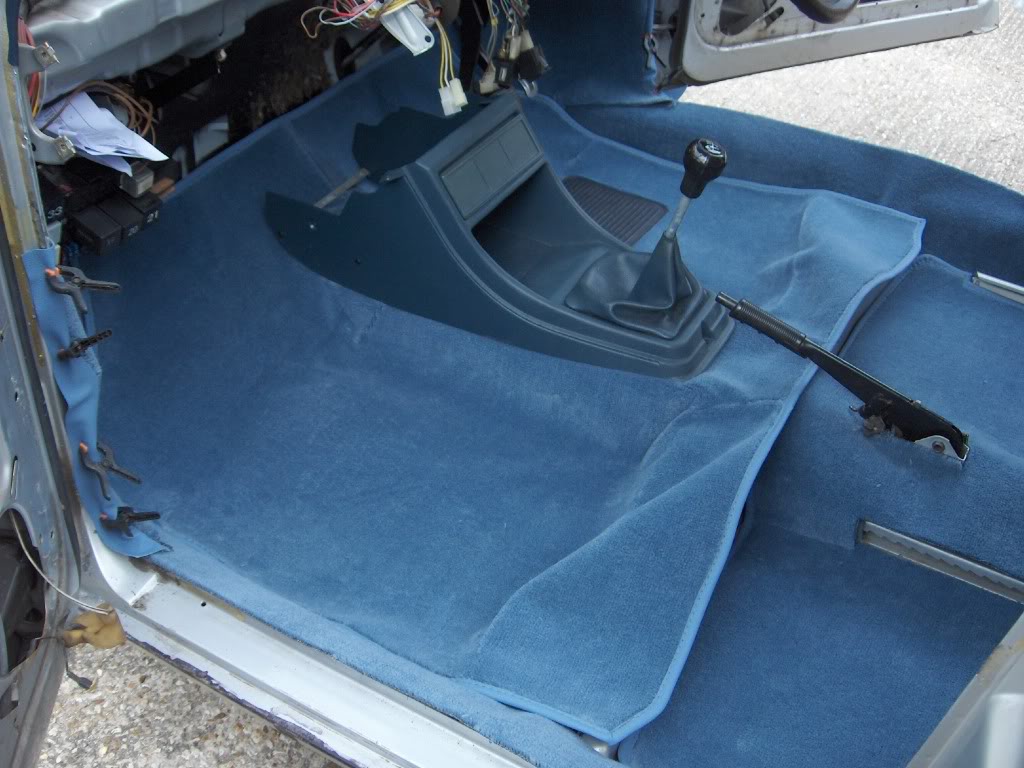

Decided to do a test fit.
Underfelt, some pre cust holes, fitted pretty well.
Maybe a little trimming required here.
Fitting the carpet, the side piece
The rear footwell vertical:
Where they join:
Fitting the front and rear footwell prompted a phone call to Terry as they had no holes for the gear stick and handbrake.
But they did have holes marked on the under side for standard car fit. (remember some cars have different gearboxes and modifications to seat mounts, so these areas are left uncut).
With some of the holes cut: the front and rear footwell sections (particularly the front) fit pretty well.
However, one shortfall, which I am sure I can sort out with Terry, the carpet does not cover the area by the side of the rear seat.
As stated before, this was a test fit, I did not do all the cutting I needed too, the car and me are not ready yet.
The carpet is flexible enough, without being too thin, to mould around corners. With a bit of sticky stuff here and there, they should stay in place OK
