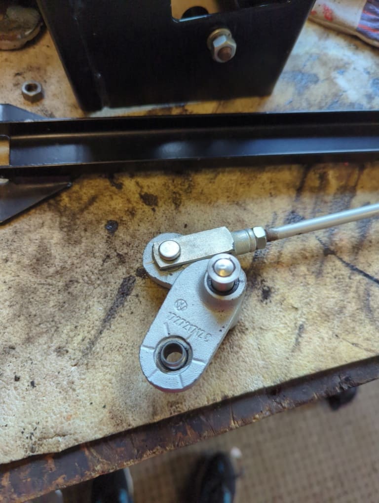

The part number is 172721793 and obviously long obsolete.
What solutions have you guys come up with?

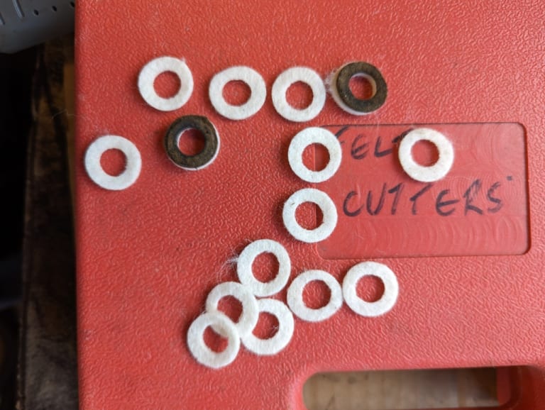

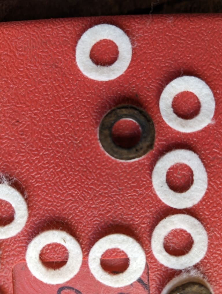

The VW diagram says that 6 are needed but in fact it's 9. I've ordered some quality felt as the craft stuff is to soft and doesn't hold its shape.
I have felt cutting dies from when I broached this issues a number of years ago. I will let you know if all works out.
