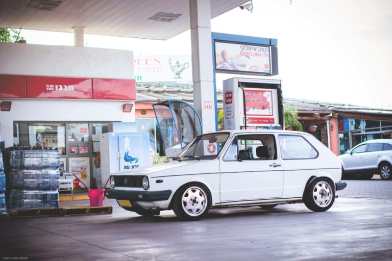

After getting the insurance money back, it was time to get my second Mk1.
Here it is on a set of Le Casttelle 15" Wheels:

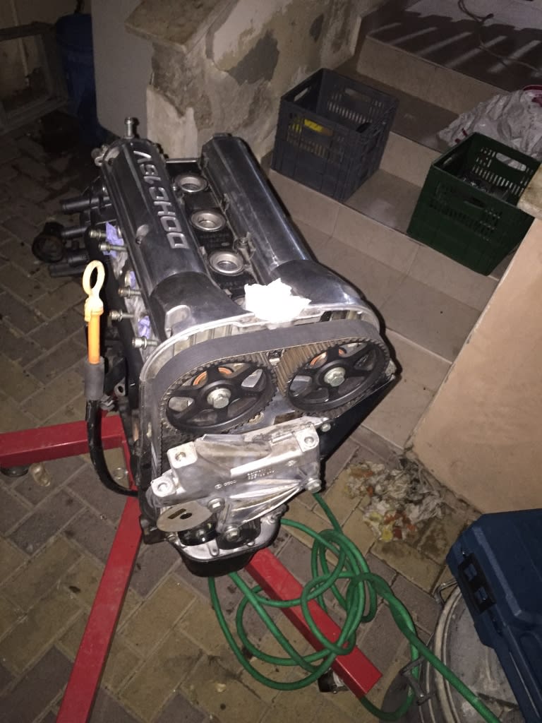

New full timing, new water hoes, refreshed new heart
Time to start working, 1.1l out
A day later and 1.4l in
Cranked right up, with the Mk2 dizzy and ignition module

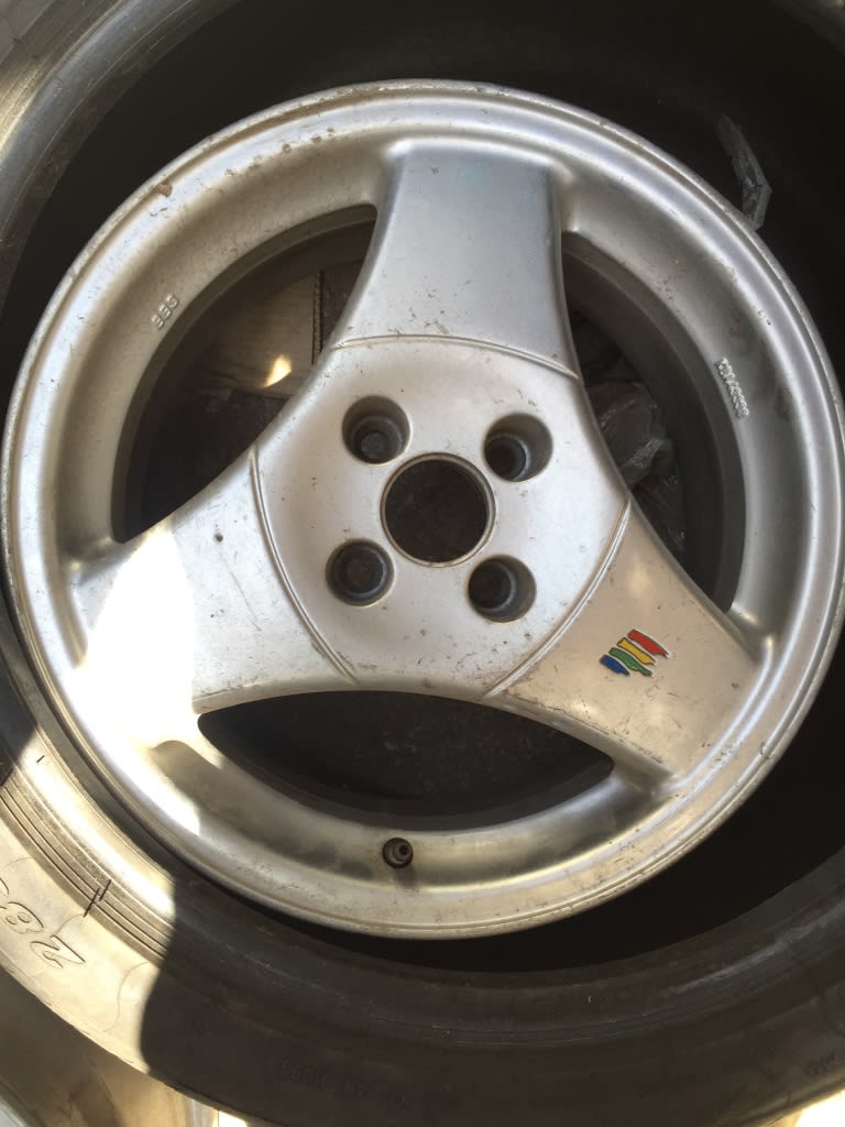

Some rare BBS Benetton F1 in mint condition and they are 100x4 pattern

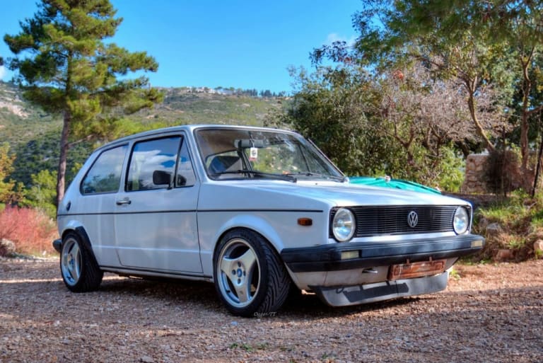

Sounds wonderful in WOT the three spokes compliment her a lot
2 photos of last month's novemberfest oldschool meeting
