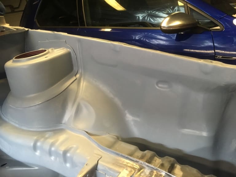

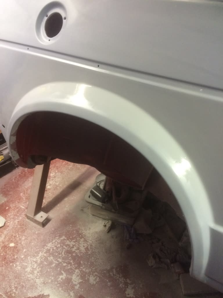

Next onto the boot floor and wheel arch tubs as there where a few dents that I would never be happy with leaving. Sanded back and a coat of skim filler:
After sanding:
Then caught a picture whilst the primer was still wet, looks nice and flat:

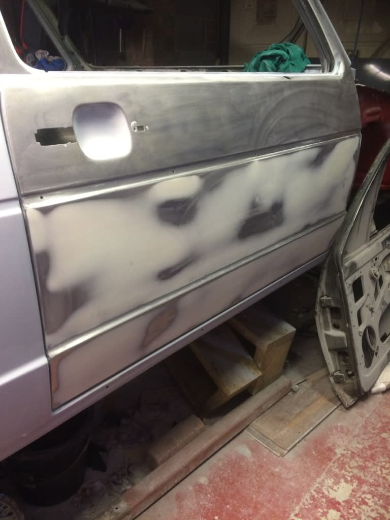

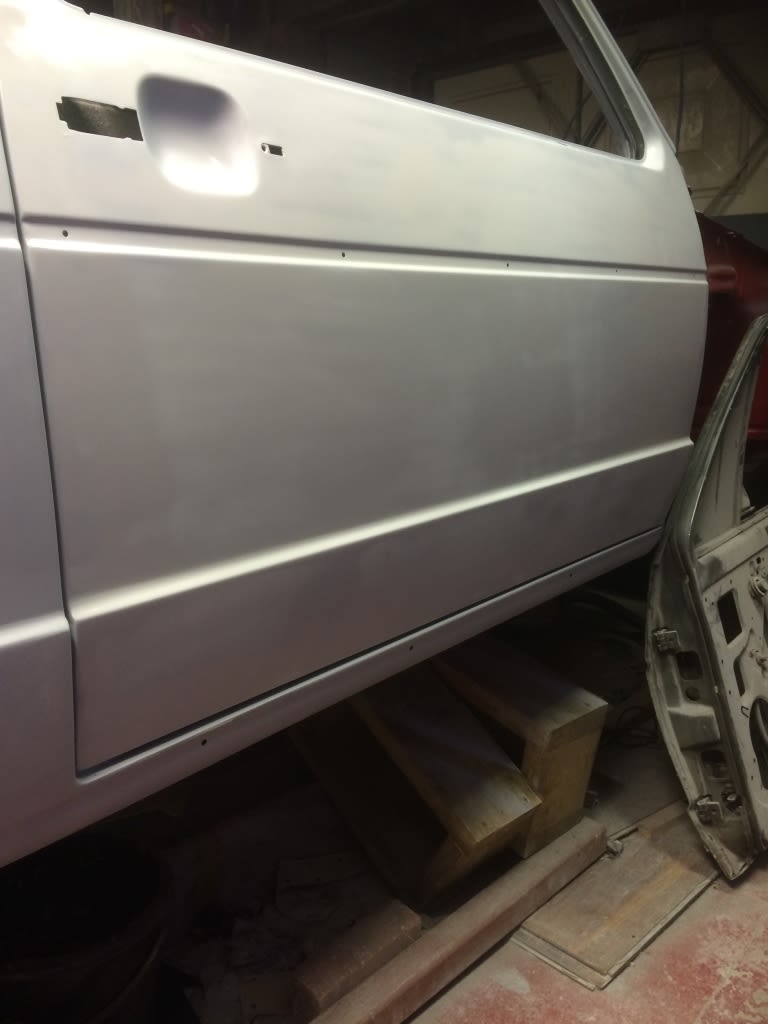

Moved onto the doors, had to spend a fair bit of time on the hinges as they were shot on the drivers door, got the pins from heritage but didn't fancy using their hinge blocks as they use a bigger thread and didn't want to drill the car bigger. I'd rather stay original.

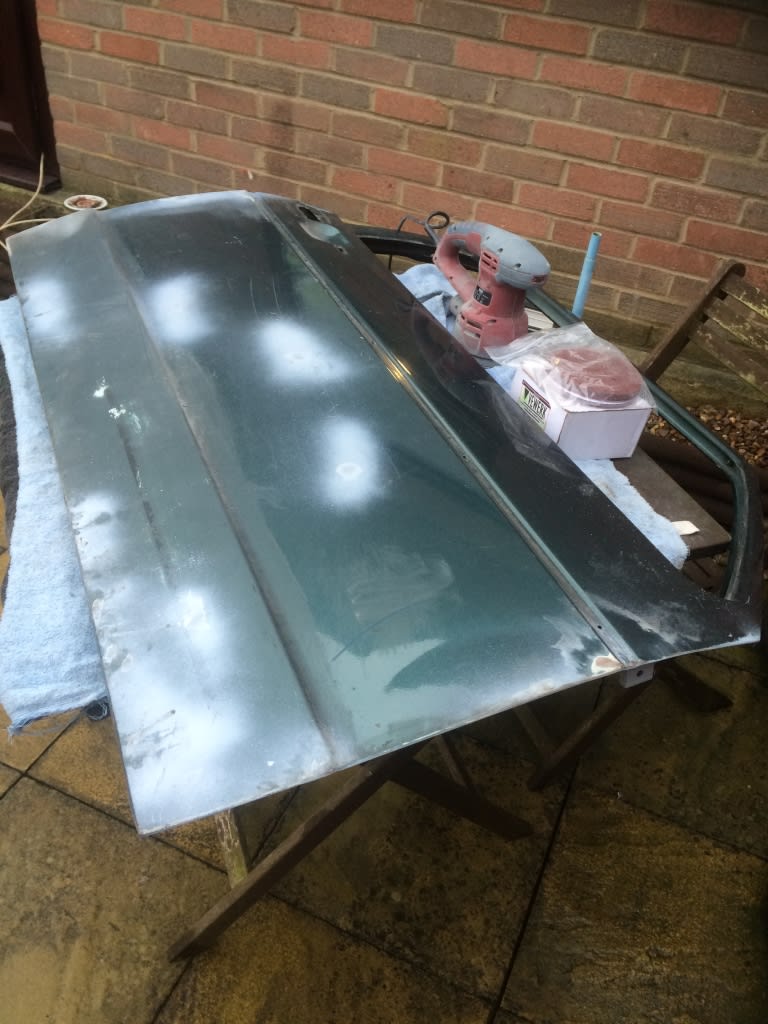

Drivers door had a pretty decent dent so sanded it to bare metal then had a PDR guy come and get rid leaving just a skim of filler

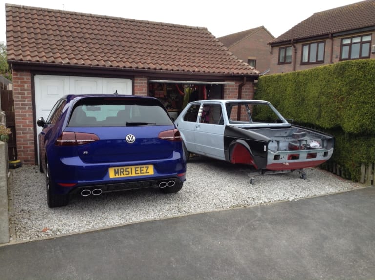

Got a quick photo of it out of the garage next to its big brother!

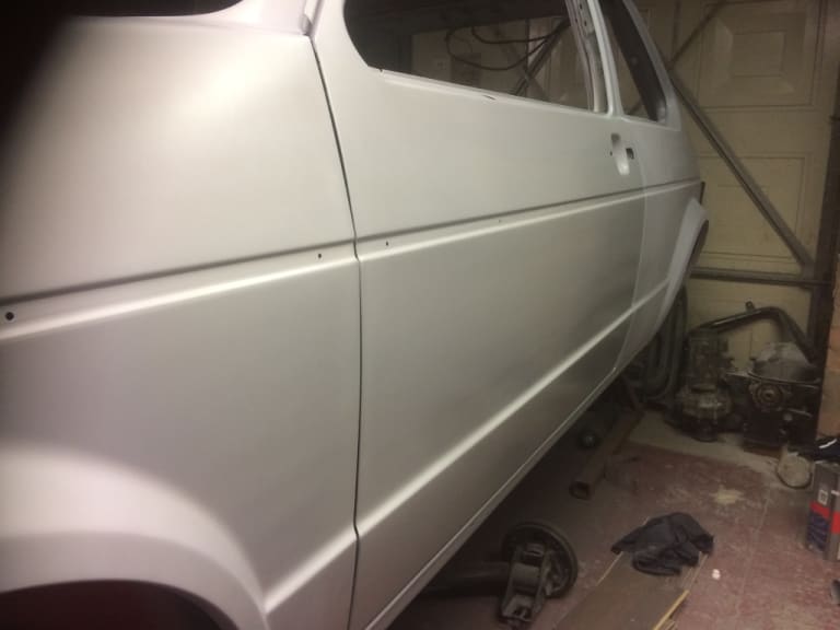

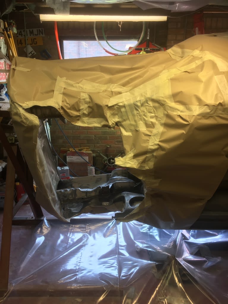

Job for the week is to clean out the shell to get red of dust, quick rub down so it's good to prime.
Weekend will be gapping all the panels and making a temporary spray booth in the garage.

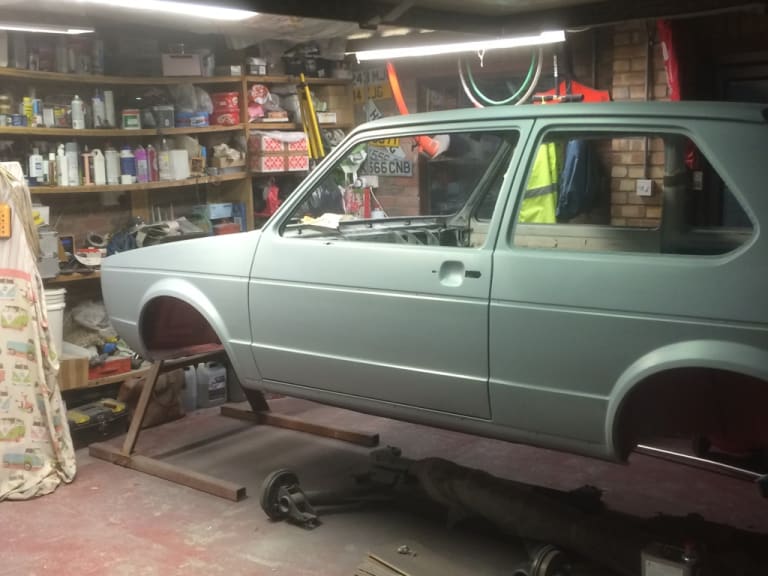

It's going to be the carbon steel grey metallic as this:

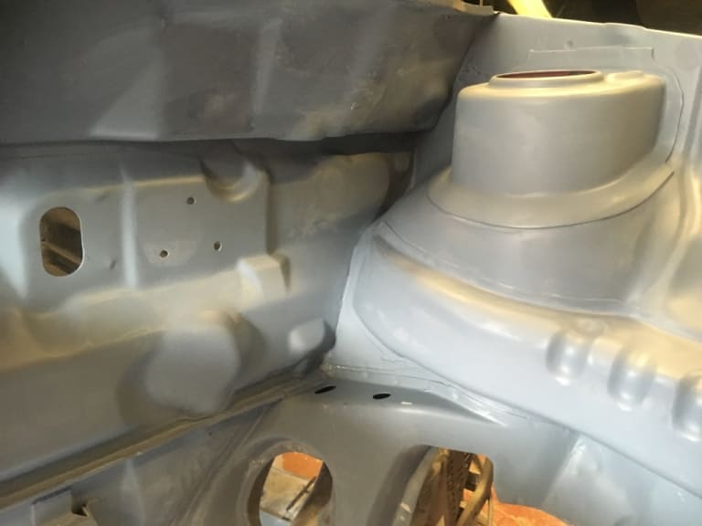

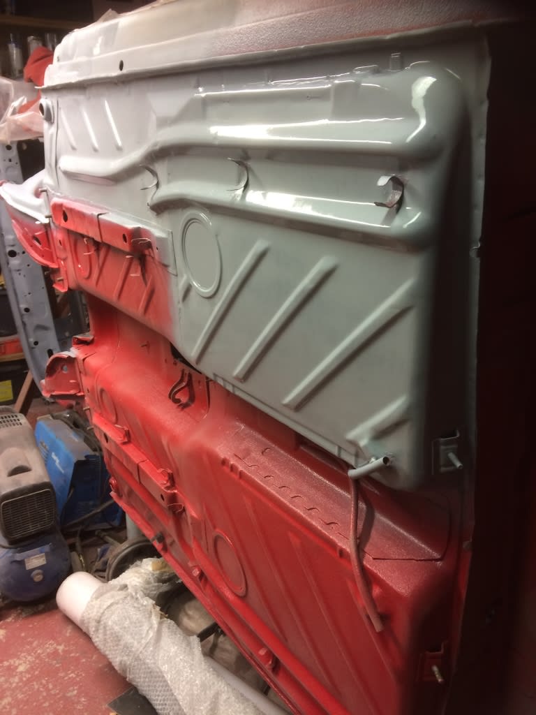

The shell will now sit like this while I prep the bay and strip and re-coat the underneath. Should give time for any shrinkage in the primer.

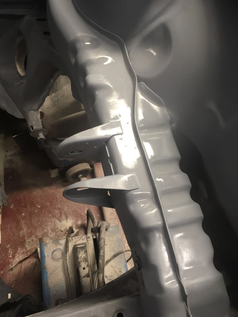

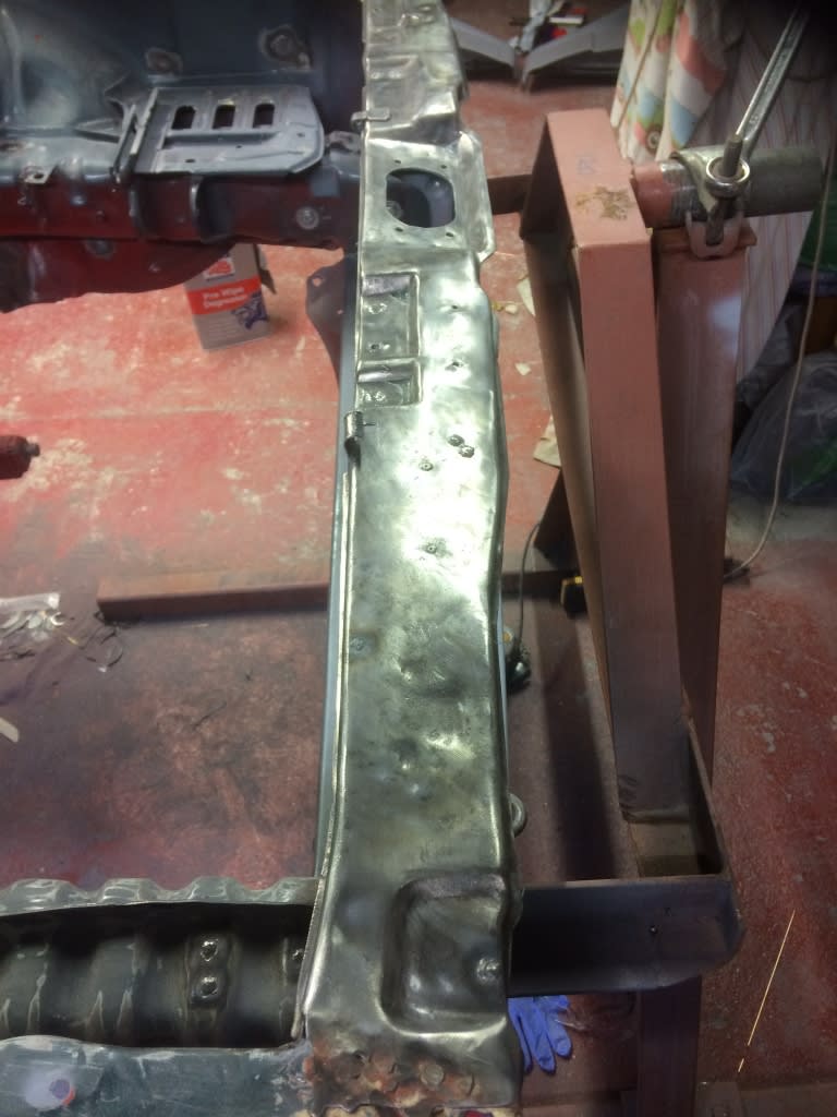

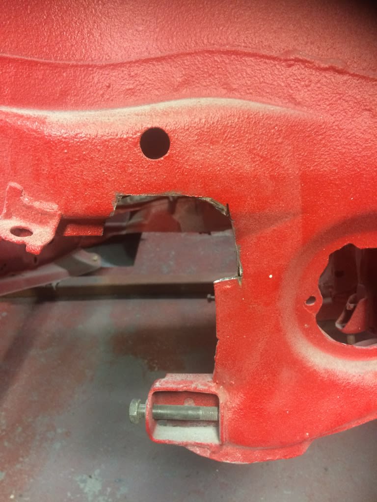

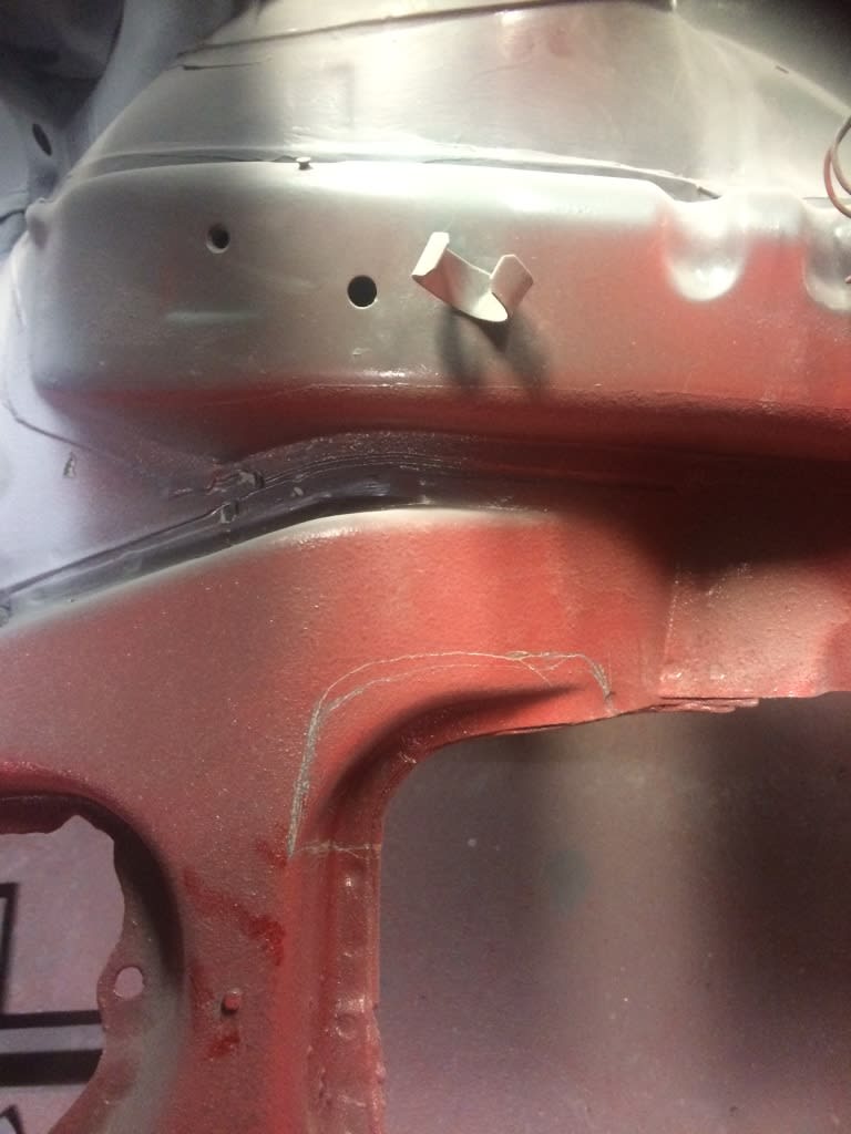

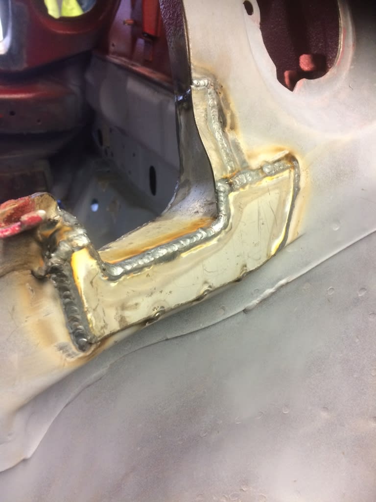

Needed to do a bit of chassis work so I can run the car low, wanted to be a bit more subtle then drilling and tubing

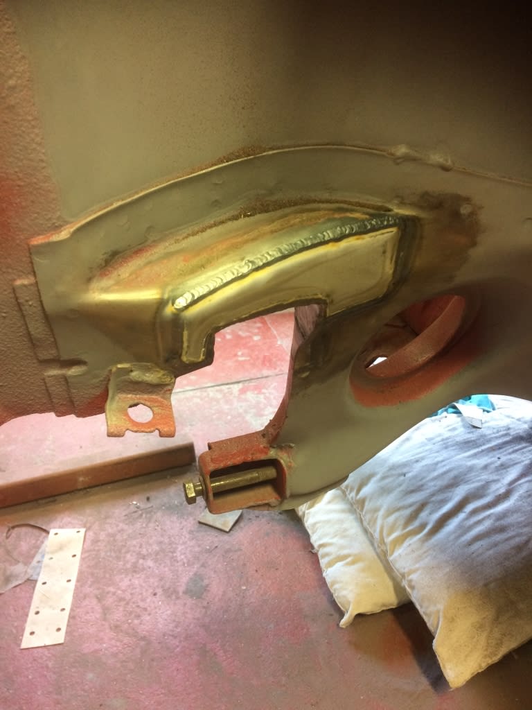

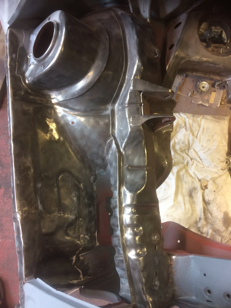

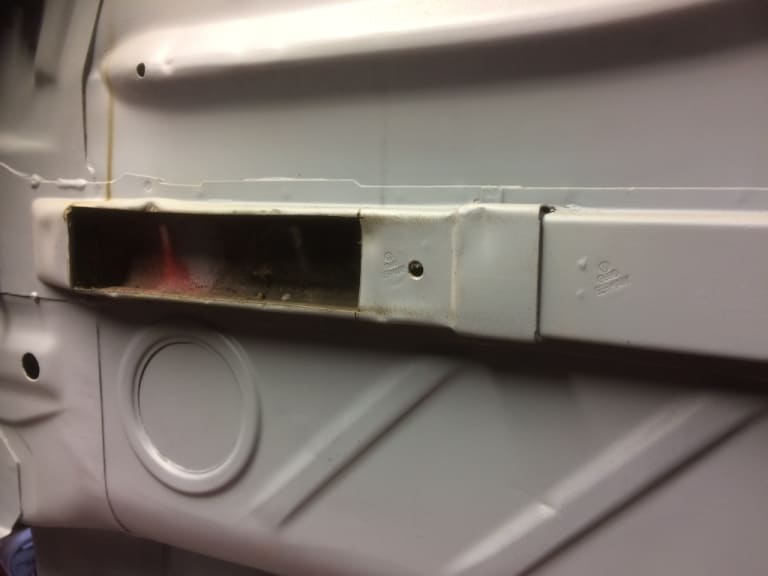

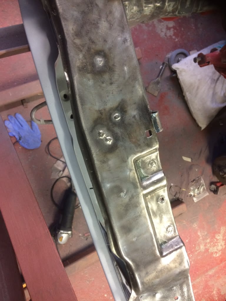

I've also decided to tuck the wiring so got some holes welded
Still some holes to fill in the bulkhead but got plenty to go at until my mate can come and finish the welding.

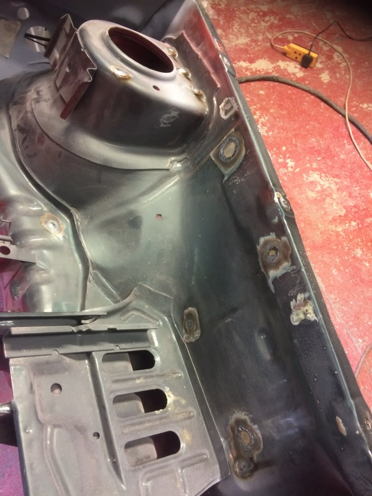

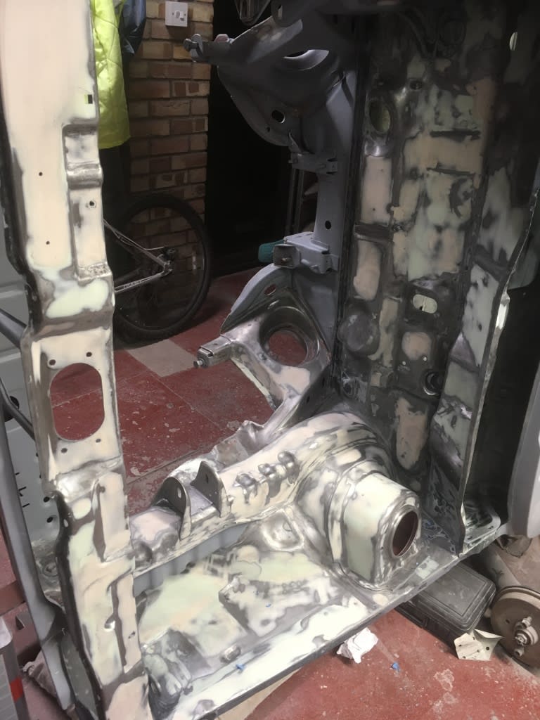

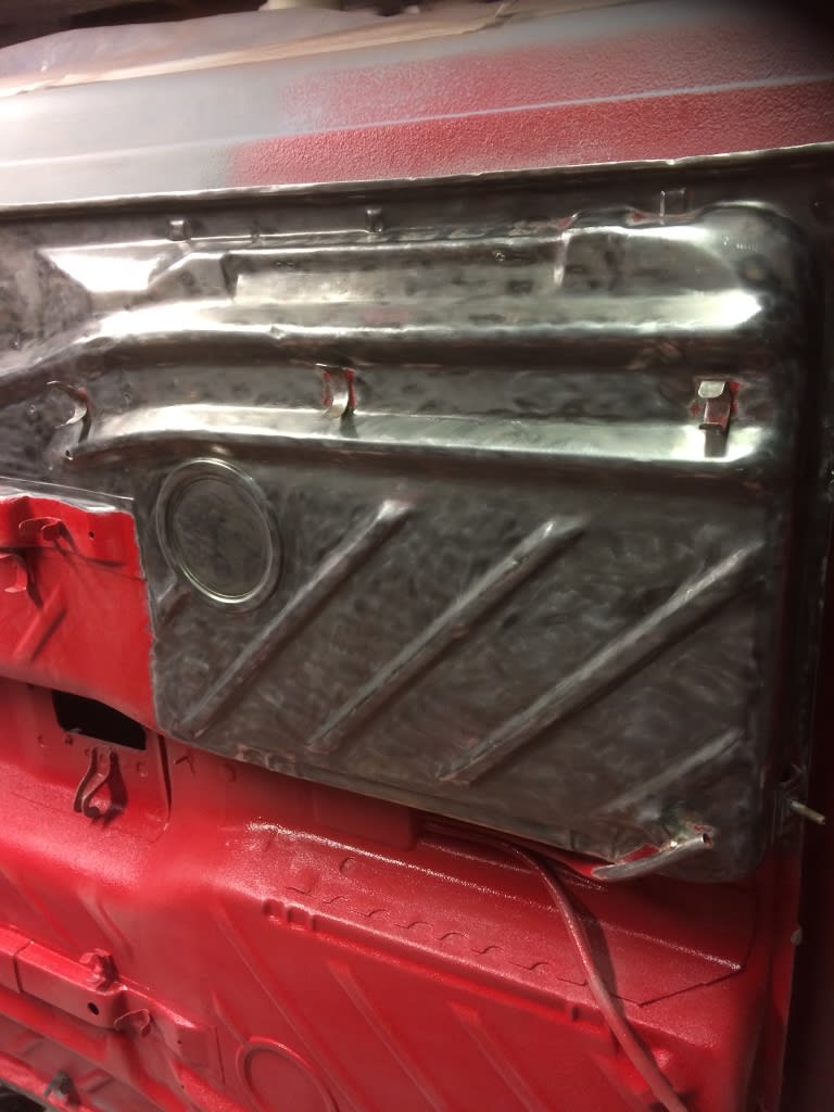

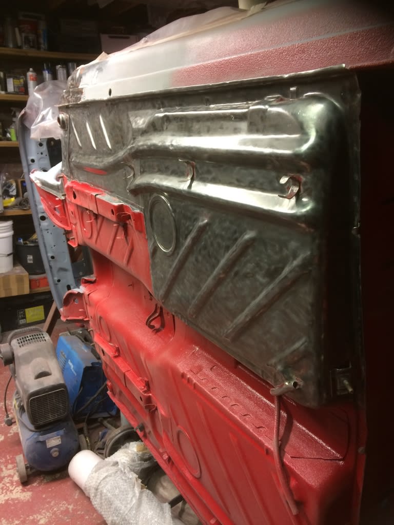

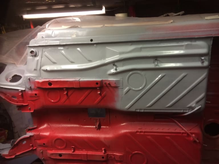

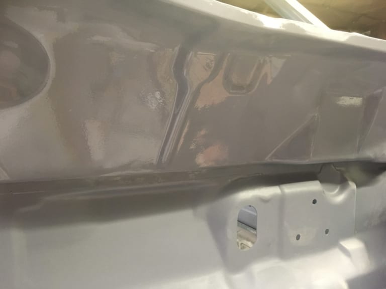

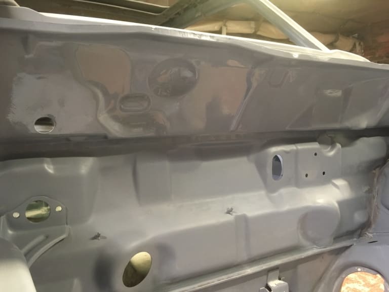

Then started to remove the stone chip from the floors to make sure it's all sound under there
Got another pair of 1/2" lips for my rs's so full set now

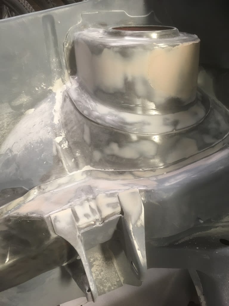

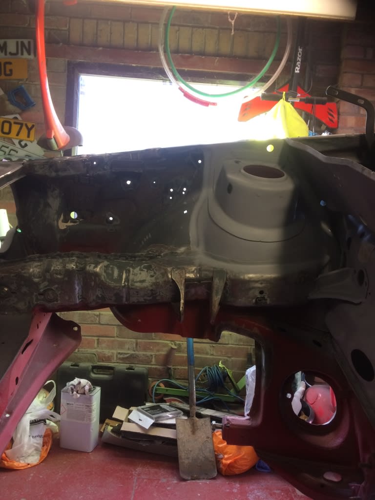

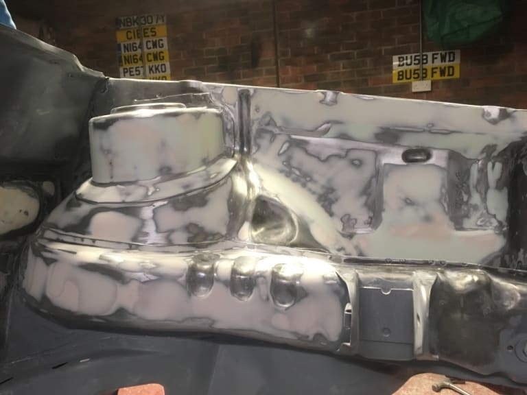

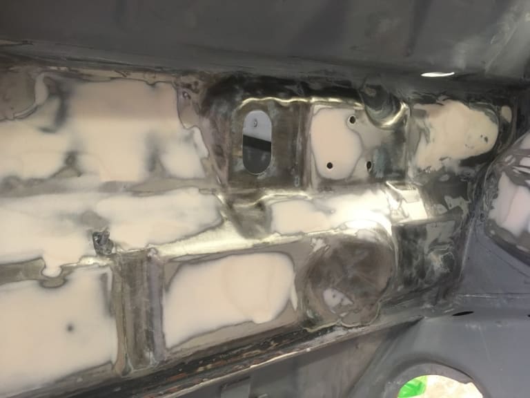

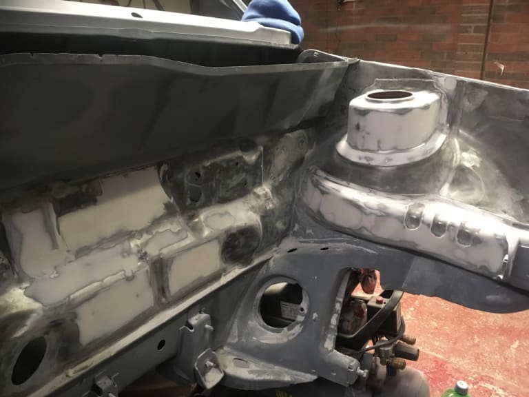

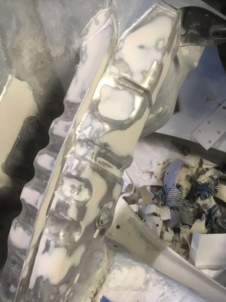

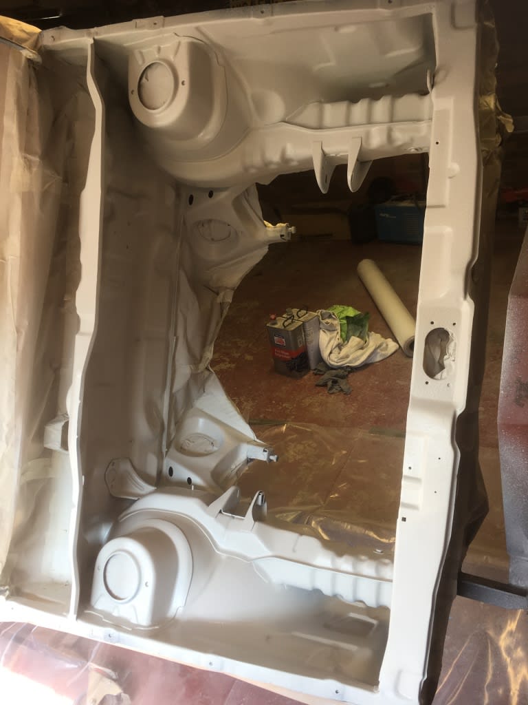

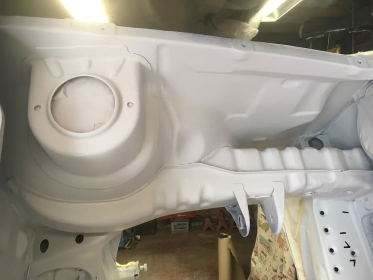

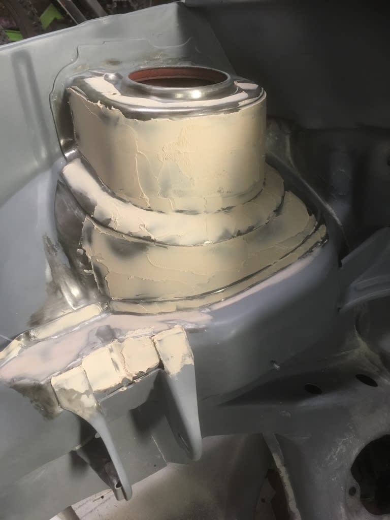

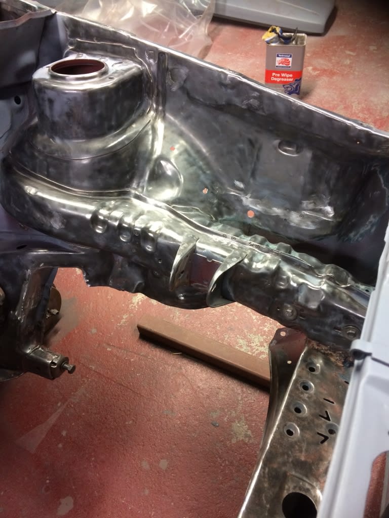

Then onto smoothing the engine bay
Once sorted it was onto priming with some polyester high build
