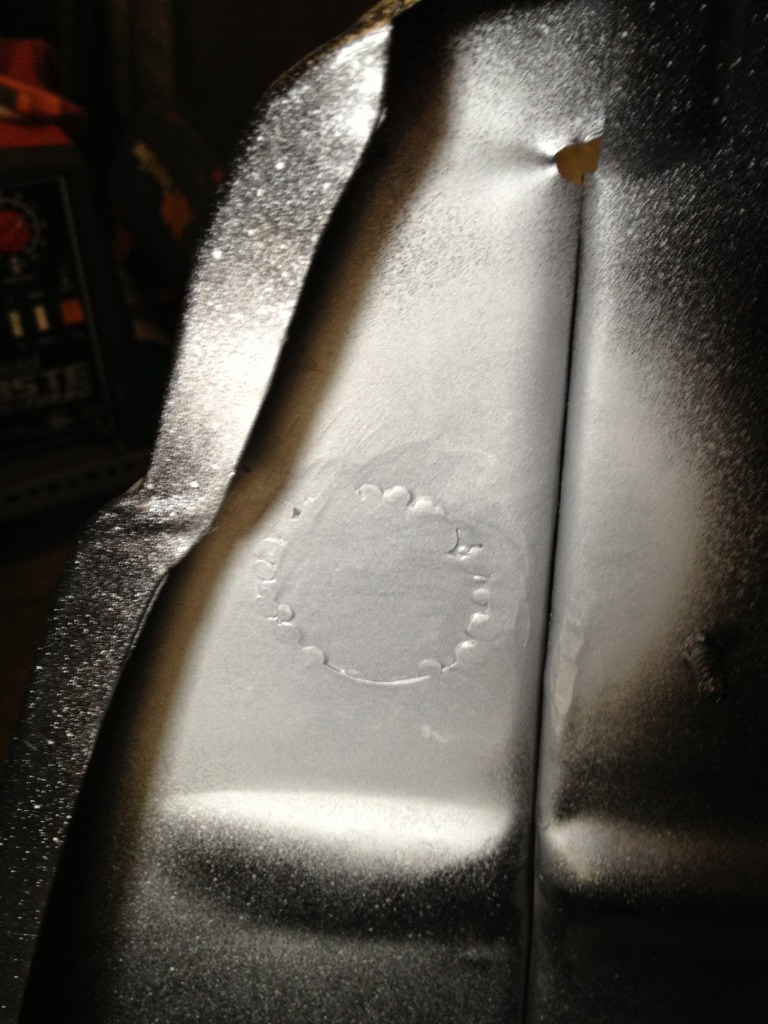

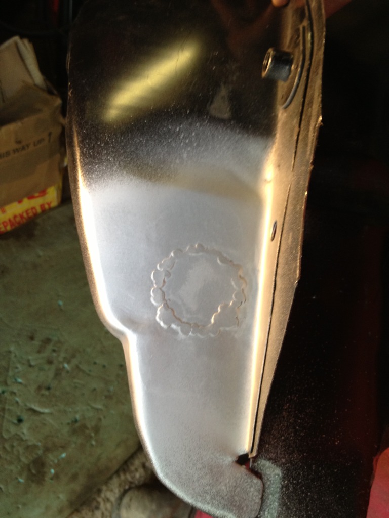

Looks great mate, good idea on shaping the edges of the plates makes it much neater :thumbs:
The plates are much neater, not sure my attaching them to the car skills are though! LMAO  :lol:
Melteddrummer said
Hairyarse said
Cheers Andy for the tip, wasn't sure if to go all the way around with weld or not.
I had it on 2, min and 7 from memory. 1 and min didn't get enough penetration, didn't try the 1 and max combo but will give it a bash ;)
No worries, If your set is the same as mine then MIN/2 has more power than Max/1, it shouldn't be this way but it is O_o
Yep same set. I'll give MAX 1 a bash, it may just take the edge off a little and help me blowing any more holes in the car

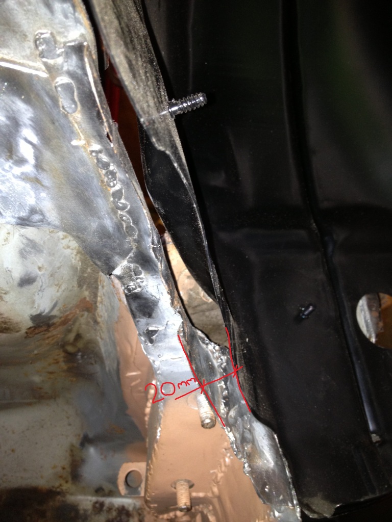

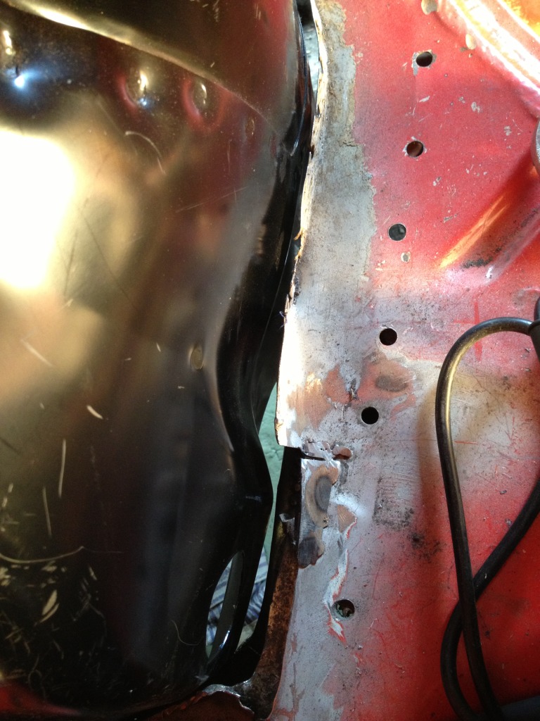

The last issue and the one I can't get my head around is the gap between the bottom of the arch tub and the flange adjacent to the rear beam mount and chassis leg
There's a gap of about 20mm and I think it's mostly due to the part of the tub that juts out (as mentioned above.) I can't close this gap with brute force - I really don't know what to do here short of chopping the tub up and fabbing this section which I really don't want to have to do!

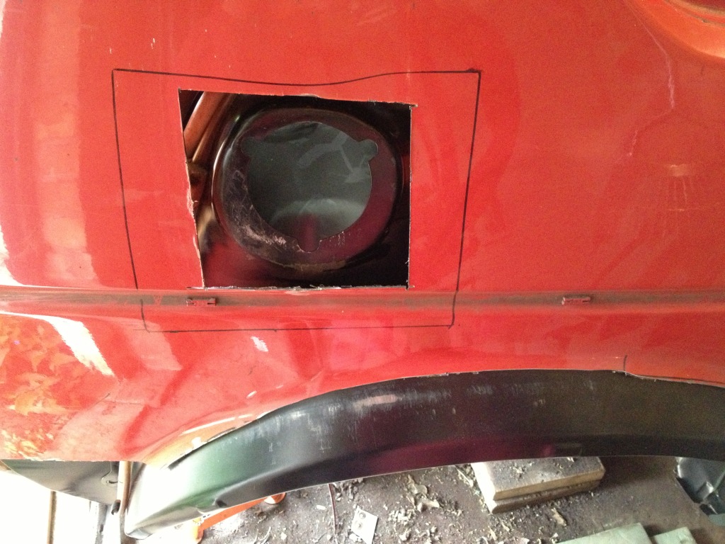

So, having spent half a day getting nowhere I thought I'd make the blank to close off the hole that's not needed. I was actually pleased at how round I made it! :lol:
Andy - I tried 1 MAX on the welder as you suggested. The first two spot welds were beautiful - game on I thought! Third and fourth blew holes though - for but weld really needed just a fraction of a second of squirt on the trigger so I turned it down again! Will be a good setting for double layers though I think ;)
After a while I ended up with this;
and this;
Happy about that at least! So, any help/advice would be really appreciated ref the above as I'm stumped now. I'm going to order an oversized outer arch from VWH which includes the rear corner as mine doesn't as I think I'm going to have to incorporate fitting this at the same time as the arch tub.
Answers on a postcard please! :)
Andy, does the arch tub seem like it needs to move towards the front of the car to fit correctly?
No, to be honest the position of it vertically and horizontally seems pretty spot on now - I had cut off some of that flange that you mentioned at the front edge which helped a little but that wasn't much of a problem
Have you got any pics of the top of the panel inside the car mate? I was wondering if you used the channel grips where that 20mm gap is to pull it together, does the top pull away from under the rear window, if so, there must be a pivot point where it is touching, that's where I'd be looking at.
No didn't take any of that bit! lol
Good point, I'll have a look at gripping the bottom and see what happens at the top (that could sound a bit wrong!  :lol: )
Probably wont get back on it until Monday now though
That's a perverted mind you have there Andy  :lol:
Yeah have a look and take some pics from inside mate. Wish I was a bit closer, as I'd come and give you a hand :P
Me too - you could save my sanity!  :P  :lol:

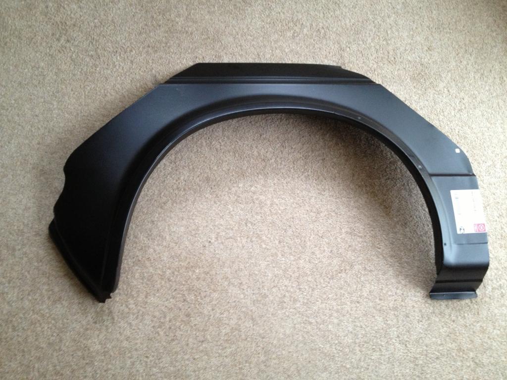

This arrived today though;
Hope to get in the garage tomorrow evening and see how this sits with the tub too. Also ordered my Bilstein B12 suspension kit. Can't wait til I'm at a point when I can bolt that on - will be a while yet though ;)
Nice delivery Andy!!

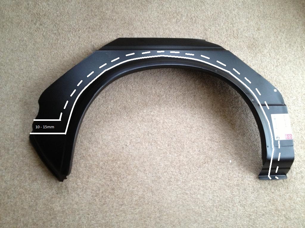

You need to trim off as much of that panel as you can, when you come to fit it. Once you get it in place and your happy with it, mark around where it meets the body and then measure 10-15mm back and cut off excess(see pic). You need to get that tub in position first though mate ;)
If you already know all this tell me to shut up lol :lol:
LOL, cheers Andy, you're alright ;)
That was the plan, I don't need much of the outer arch so most of this panel will go. I was going to sandwich it as Yomp drew up before for you.
I do already have one but not with the rear corner built in. Whilst I have a rear corner panel I thought it would make life a lot easier to have it all in one, hoping it may help to know I've got the tub all in the right place!
