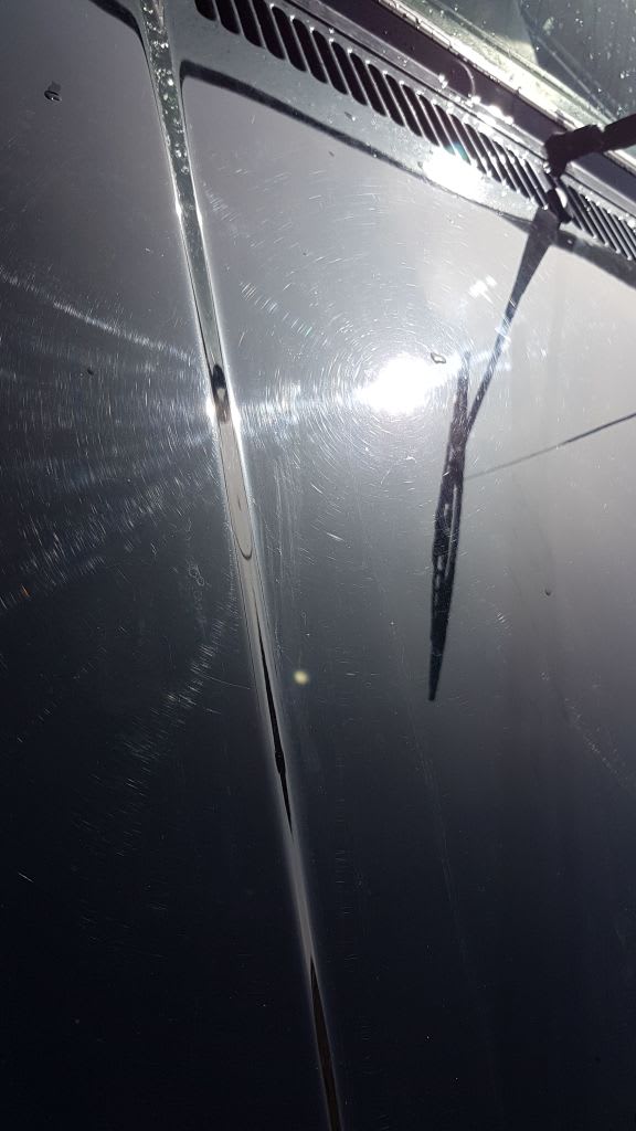

Long list of work to do but first up before and after picks of body
So I got My sportline on 24th June. Took me 18 months to find one because A. I wanted black which seem impossible to find these days, and B. wanted low miles. Over that period only 3 came up for sale, a really nice one in Scotland for £11k which had 82000 on it, and then a non runner in Barnsley that went for £4650 with 120,000 on it. Couldnt afford the Scotland one as it wasnt perfect in my eyes and wanted 'good' money for it despite work to be done. Went to view the one in Barnsley and not only was it a none runner it had been sat outside for about 5 yrs and was in a terrible state……
………….So that brought me on to car number 3 which felt like it had been waiting for me, 1992 model with 86,000 on the clock. Had spent most of its life in france so the most solid car I have ever come across and last owner had done £2k worth of work in the last 12 months including fuel tank, filler neck, brakes all round, pumps, belt ect…. I bought the car sight unseen really as put a decent deposit down to secure it, when I turned up it was what I expected from a 'running condition' as in all mechanically sound however body work looked like it had never seen a polisher in its life and that someone had washed it with stones, also interior needed the usual refinements. Mrs wasnt overly happy but bought it anyway as you cant be picky when so rare and mileage/ age and everything else was right.
Last edit: by ajc1984
After 3 days and £150 worth of product….

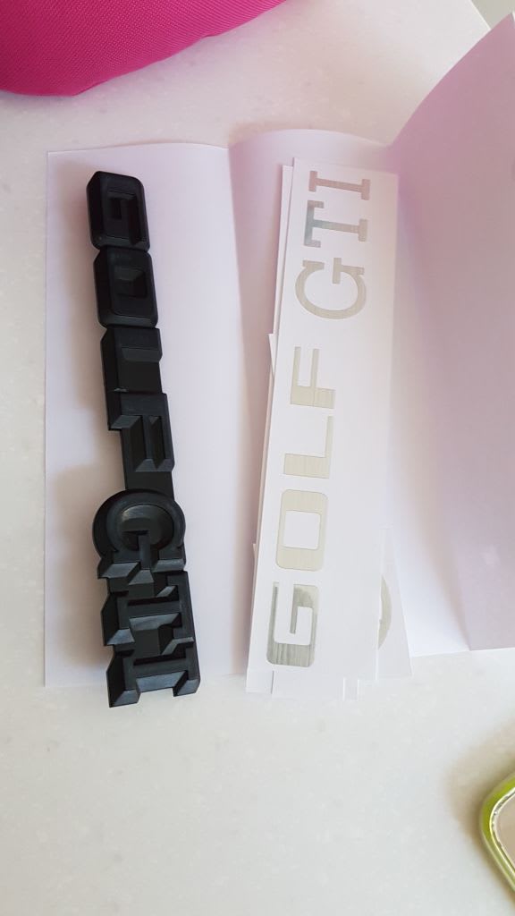

Badge refurb kit………. great for the money tricky to apply perfect but time and patience pays off… Also did the Karmann badges on side but no pics as I did them while on the car as stuck on not pined like these

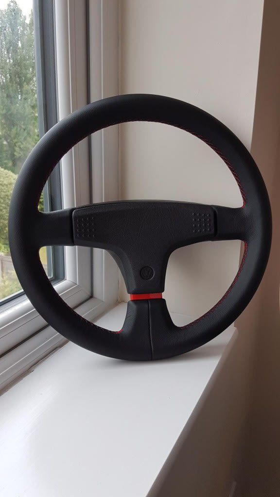

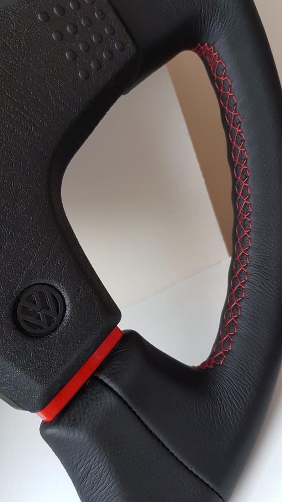

However couldnt help myself, bought a steering wheel end sent it to royal steering wheels for re-trimming, looks and feels amazing.

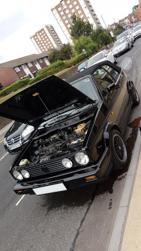

Decided to take car to work for the first time on the way there disaster struck…. Turned out rad had blown. Was a blessing in desguise however as the car had been running hot (almost in the red on temp gauge) turns out 1. fan wasnt plugged in and was knackard anyway and assume rad had a blockage as it blew side of rad out…. any how new rad/ fan and collant along with a flush and 2 new hoses runs perfect on temp now at about 1/3. My fan comes on when temp gets half way however is this right seams a bit early but does the job as its never gone over half way since all new bits….

Shame about the rad but at least it was only on the way to work and nowhere important

Steering wheel looks great too. Any links to the company you used?

Royalsteeringwheels.com is where I got the wheel done having read through loads of forums supposed to be one of the best around and I have to say mines come out great as hes matched the grain/texture of the leather to the plastic centre horn push very well and colour also.

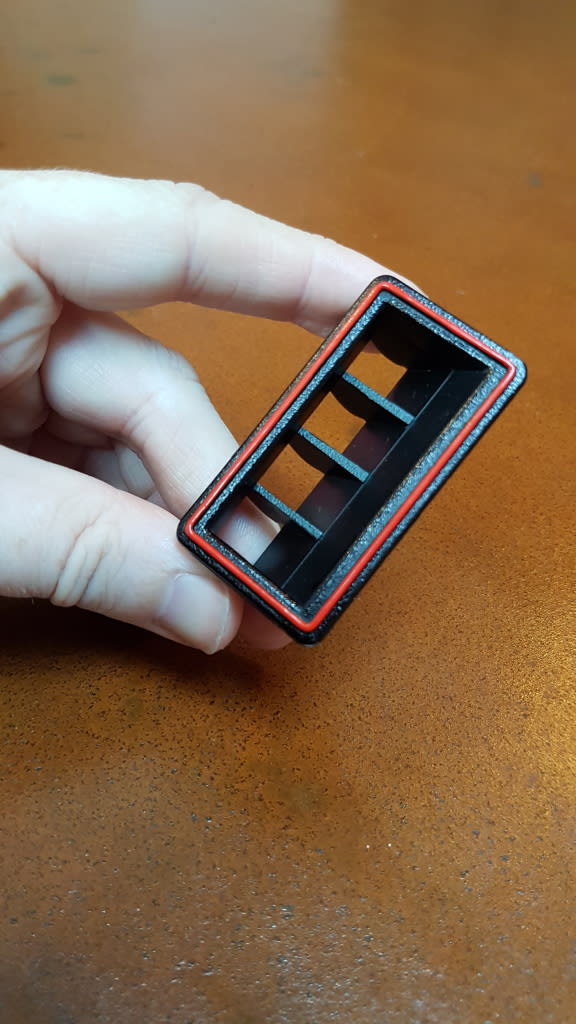

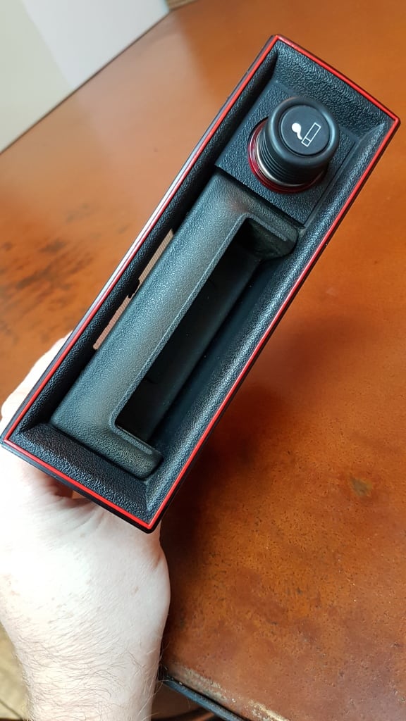

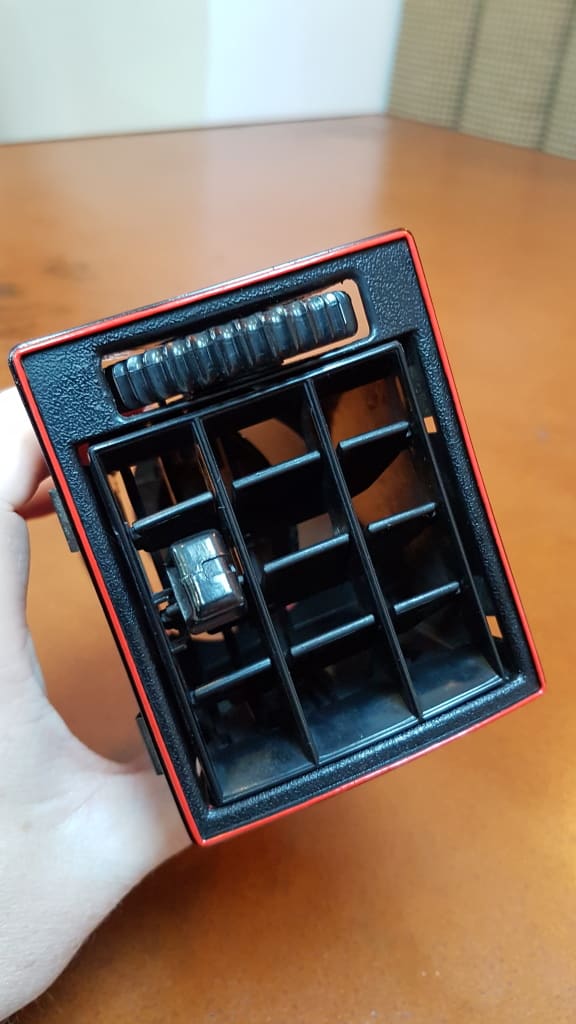

After wanting to brighten up the dashboard I was looking for the red dash trim around the clocks and also the red air vents. Found a mint set on ebay but sold for £360 and all the rest that are advertised usually have some marks/scratches on the red due to being circa 30yr old pieces which would drive me mad. So i decided I could do my own. I got some mars red 1, red undercoat and lacquer. Im really happy with the below pieces as the paint is a nice smooth and flat finish (lots of wet sanding and coats of paint to get a high build colour) and as you can see no paint lipping over the edges. Did the airvents/ upper vents/ cig holder and dash clock still to do. ( also got a new lighter surround in red to replace the green to keep theme going) still have original parts should I need to turn back to totally standard look but think these touches really bring to life a bit of a dull dash. Will add pics once all installed.

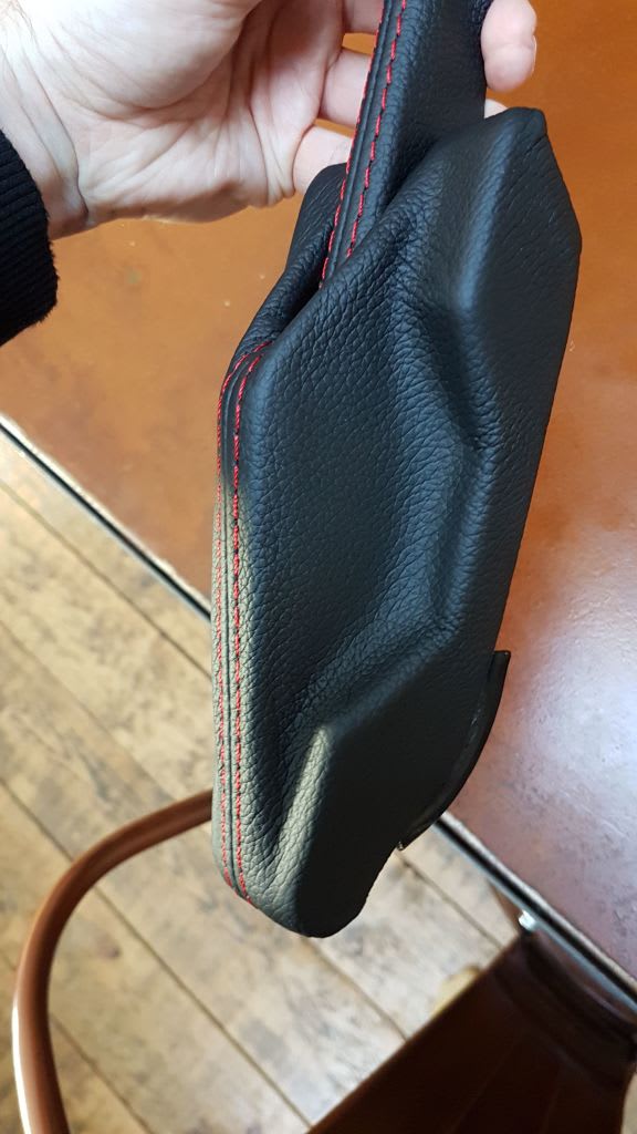

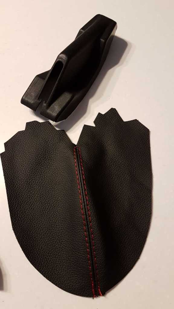

Small update trimmed handbrake and cover in leather… gear gaitor and knob up next. At £50 for a tiny bit of leather it wasnt cheap but will defo make it feel a much higher quality intorior…. much better than those big baggy covers I think.
