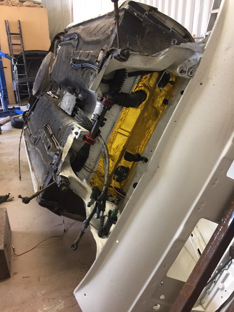

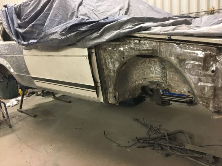

So it needed a small patch of welding on the rear spare wheel well and a tiny bit where it was jacked up wrong on a cill and crushed.

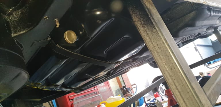

With this all done it was acid etched epoxy primed and raptor paint the floor arches and Inside
Then ontop due to raptor being hard and not Flexi, dinitrol was used as a rubberised underseal.

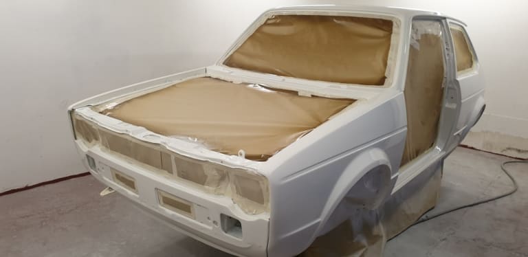

Some gen second hand wings where sourced and a bonnet as mine was a little scabby. These where the. Dipped prepped and recoated.
After a long time I think it was almost 2 years.. maybe longer. We got it in primer inside out

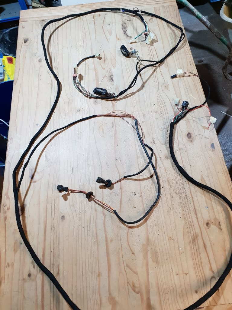

Meanwhile whilst I was at home and fell on things not being able to do I was sorting stuff like an ABF wiring loom and tidying all my interior loom wrapping with OEM tape

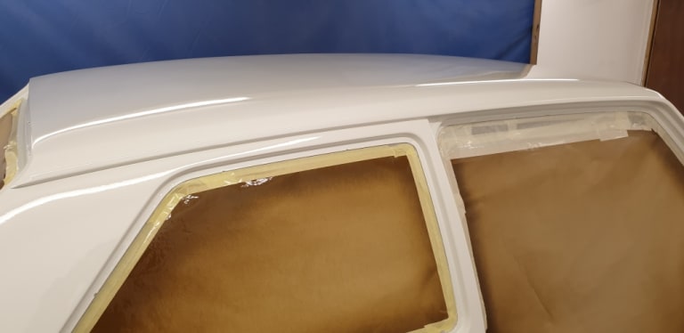

And literally a week before we got locked down, the car was painted and polished etc etc etc and came home

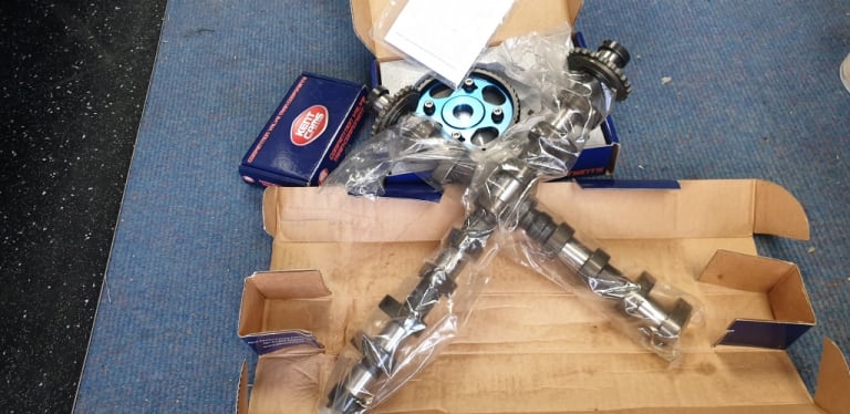

I ended up collecting 3 ABF engines so I've. Built one up with new gaskets stem seals cleaned all the head block etc and ready to throw in to use.. if it's ever finished.
And I've got a other one that I'll build as I've always fancied doing a 2.1 with cams etc and one incase something goes wrong 🤣🤣

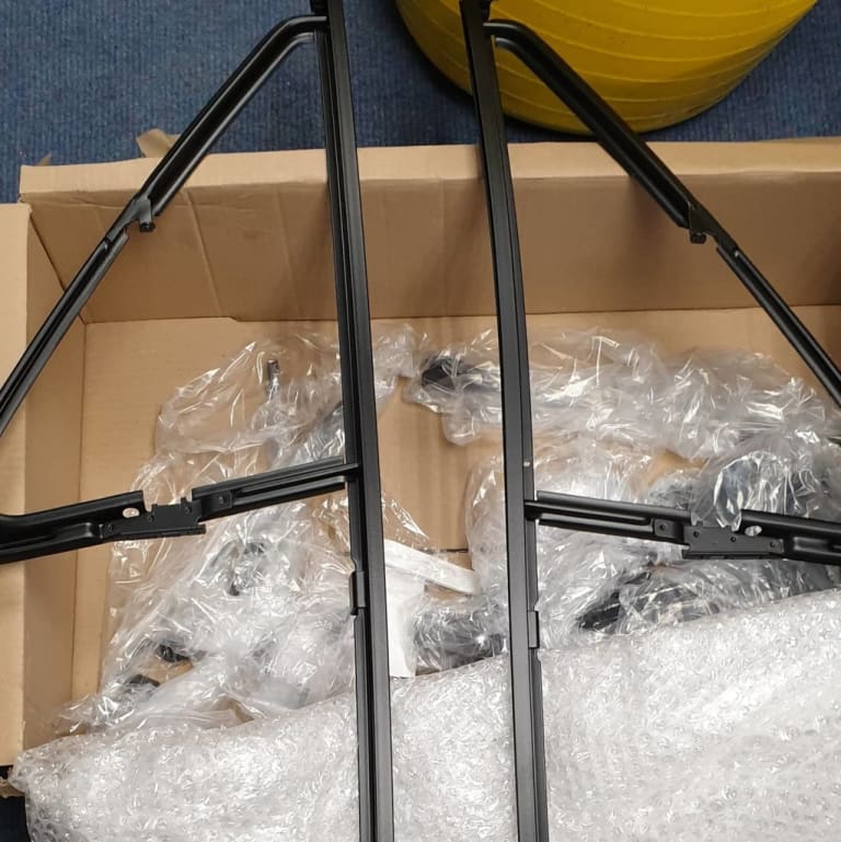

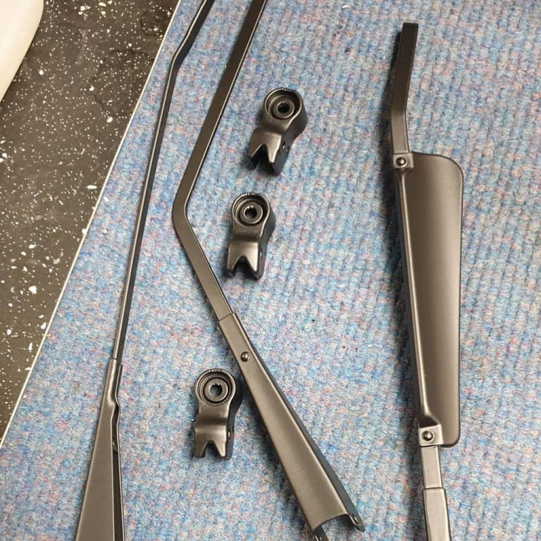

Stripped the vent windows repaired the frames and getting them all done the matt colour they should be

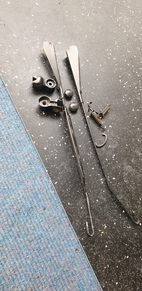

Love how the wipers and window channels have came out! Need to get hold of some sort of aerospace solid rivet gun to put some solid rivets back in now.

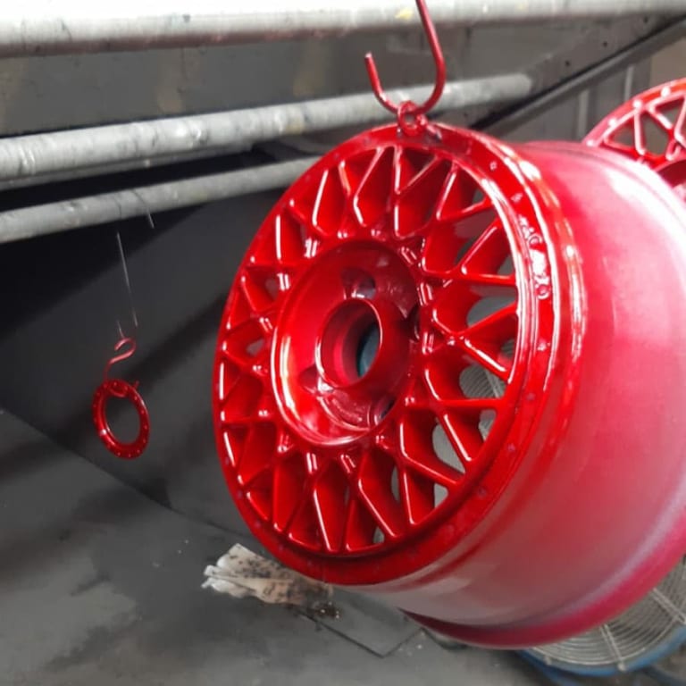

Got the splits back, happy with the colour.. they are in storage now until the time comes when I need to sort the lips and stance out,

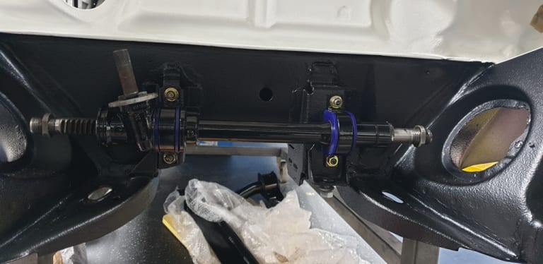

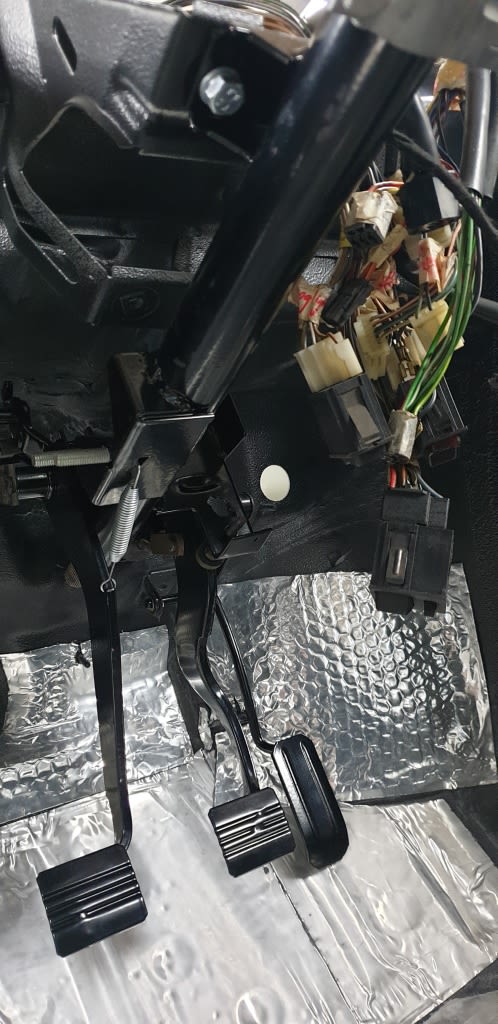

Managed to get the SA style brake bar fitted and built up along with the servo and 22mm master. Managed to grab a resivor with a clutch take off pipe so I'll be plumbing into that for my hydro clutch and making it look OE as possible.

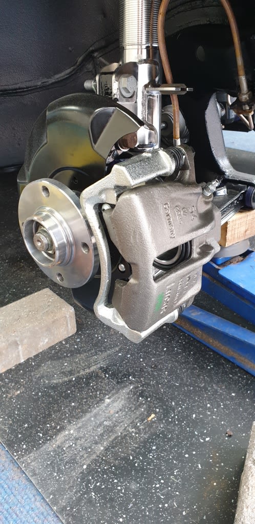

Grabbed some Rocco 16v calipers and carriers! Got these of mark at classic vw 😎
Built up all my steering column that came back all fresh and powdercoated.. love a powdercoat I do!

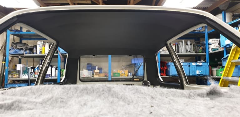

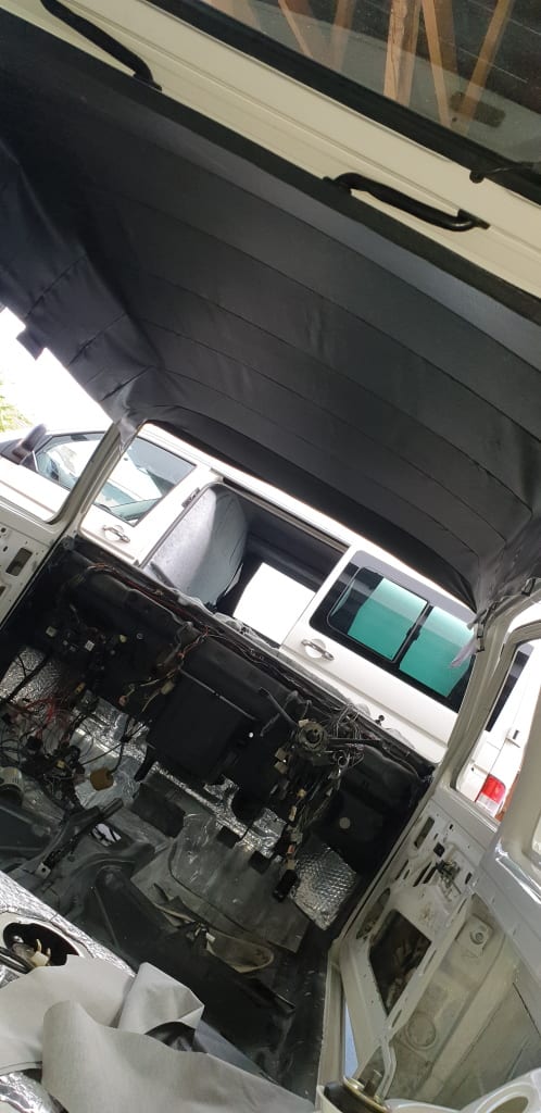

Managed to get a mate over who's into trimming, he helped me trim the headlining with the Newton kit. Looks really smart!

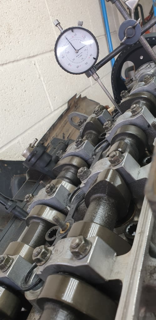

Managed to grab some time and get the Kent's dialled in today! And rebuilt all back up! Such a shame I can't flick the key and hear it running but time will come I suppose! 😤😤
