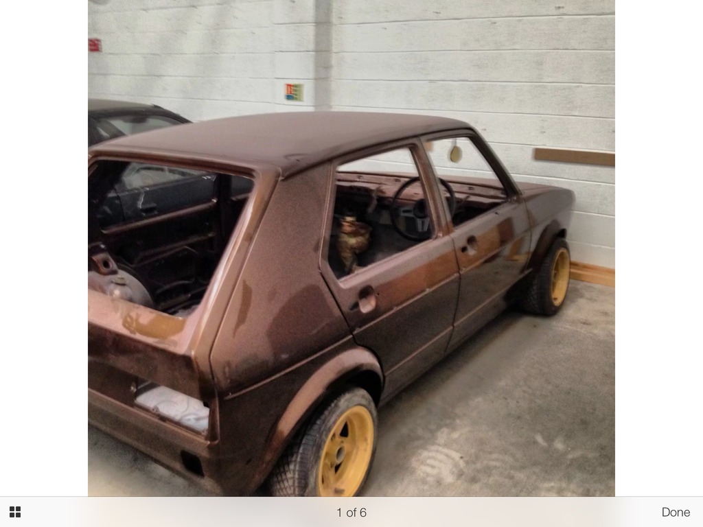

About a month ago, I stumbled across a brown 5door mk1 GLS for sale on eBay, which was located only 4 miles from my front door.
so I went and had a look and to meet the owner. Nice chap called John niell, he was selling the car following being messed about by a garage and he had just bought a house and needed to funds renovation work….step in me.
I have just had Dave and matt from retro shack round for a chat. Great guys, had a lot of ideas about had to handle the project from now.
Which to be honest has left me feeling very confused.
John who I bought the car off, was building the golf into a track car, but I would like it to be a road car, but I have a bit of a dilemma. As Dave and matt from retro shack pointed out to me there are certain parts and modifications that have been made to prep it for track, mods which will cost a lot to reverse. Which brings me to my dilemma, do I spend money reversing mods and then make the car my own? Do I continue building a track car, which I would probably sell at the end as I have no use for a track car? Or do I break the car, sell the parts and find a nice standard car to start from scratch?
Anyway, here's the spec of the car:
golf 5door gls with full service history
repainted inside and out in metallic brown (but the paint need touching up and the roof needs re doing imo)-petrol filler cap has been smoothed over.
it is part way through an ABF on R1 bike carbs engine conversion (reconditioned head), I have the dub power manifold etc.
the idea was to go hydro clutch, tt shifter (which I have) and I have a obp pedal box(which I prob won't use), I have a Wolfsburg steering wheel, coil overs, fresh painted engine bay in gun metal grey, gti brakes, recaro seats.
thats kind of it, here are some pics of how she currently looks, love to know your thoughts and your opinions of what I should do, as I think I could sell the parts I have and make my money back, and start again.
What mods and parts have been done to the car and why can't it be a road car?
Where do you put petrol in if the filler hole has been filled in?

Not any more to be honest. Trouble is, there are several bits that have clearly been thrown together. Eg there's a pencil instead of a bolt holding the drivers side swing arm on, so I don't really know what has or hasn't been done…. I'm mega confused about what to do with it

It looks a solid car and that's the biggest hurdle - Just start cracking on with it yourself and work from front to back making sure everything is done right - obviously removing pencils and adding bolts where required!
You can easily use this as a road car, the pedal box is easily reversible or you could use it as they have intended but still have it road legal.
I've seen plenty of Mk1's filling up with the boot lid open! A spare wheel well fuel cell would be cool!
Don't be disheartened - the colour is absolutely boss and it looks like it'll be mint when it's done.

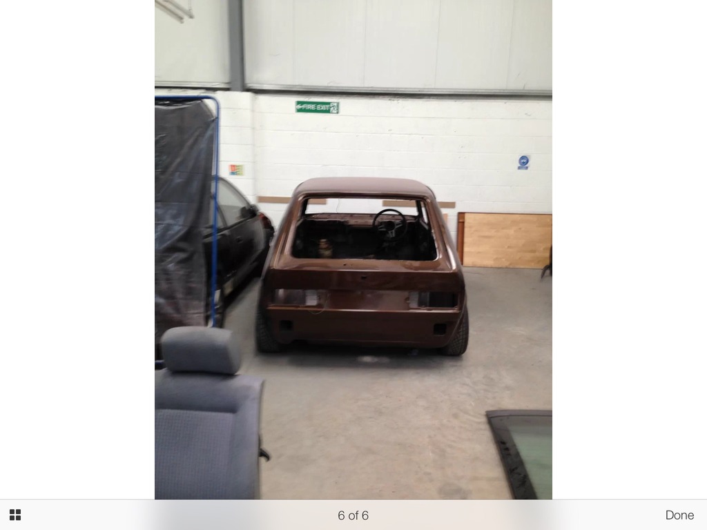

But with this project it's hard to see what stage it is at. For example there is no rear engine mount fitted, I have the mount but I can't understand why it isn't on the car when other bits are there that you would think would be fitted after the engine mount.
I think I need to make a list, like you say start front to back and get it done. Cuz I love the colour. And I can see in my head the final thing. Watch this space!!!!
It's a cracking car and you got it at a very reasonable price (I was watching it on ebay!) - I'd definitely say it's worth the time and effort to get it right.
There's plenty of helpful guides and helpful peple on here to get you moving in the right direction. Get it emptied out and get cracking with your list!
Might be an idea to work out what you are doing with the engine (keeping it or different engine) and fuel intake (Carb or injection) as the plumbing etc is different.
If you are doing the work your self, take the time you think it's going to take and double it as there is always things that crop up but do it right the 1st time so you don't have to do it twice.

Could well have just had the engine is a test fit to make sure everything slots in right - sounds like it wants to come out. That'll give you chance to check over all the steering rack mounts and boots too while its out and make sure everything in the engine bay is where it needs to be.

I hadn't thought about it that way. Take the engine out and go through the whole process again. I have emptied it out now and the roof as a bit of bubbling which sucks. As what attracted me was the body work was complete. But I will have to get that sorted.
One thing I am a bit daunted by is the hydro clutch conversion with the cable tt shifter. I have the shifter, but what is the best way to do this? Does anyone have any tips? I have searched, but I can't seem to find a definitive guide/how to.
I think I have established I can't afford to pay retro shack the £3-4000 to get it on the road. As you say I got it for a good price (£1300), I want a great car at the end, but I am on a budget.
