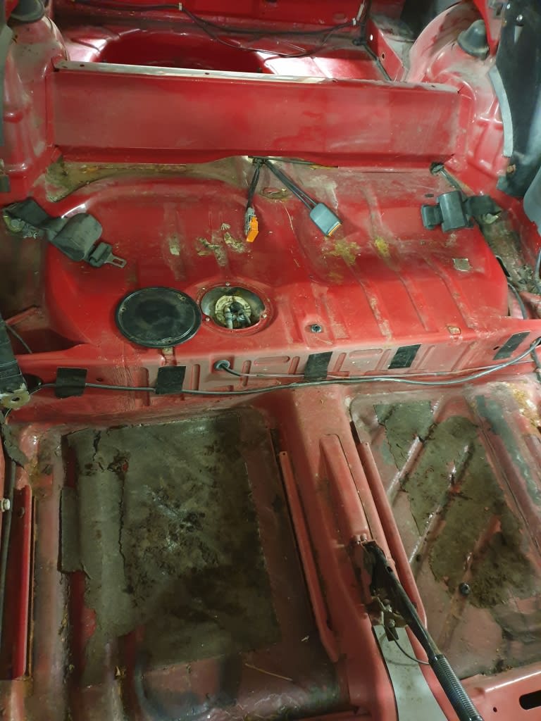

Stripped the interior out and lifted the carpets.
Disconnected the battery…which is just sat on the battery tray.
Pretty happy with the floor, couple of small surface areas to treat.

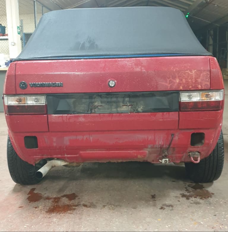

Rear towing point has rotted and the offside rear quater is a different shade, so will dig into the underside soon.
Will be taking the bonnet off to get into the engine bay next. Need a new radiator and the wiring is terrible, there has been a headlight conversion done I think at some point so it looks like I'll be chasing that for a while.

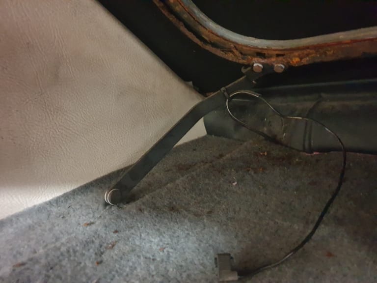

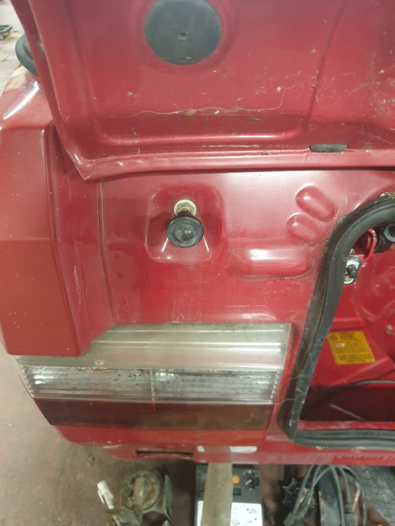

The roof then comes up about 5 inches and then won't go any further.
The two release catches on either side of the rear seats, I have had them up and down but no joy moving the roof any further back. The drivers side has resistance in it, passengers side is pretty loose.
Am I missing a trick?
The roof outer is new, doesn't have the window cut in…I will get a pro to do that I think! I was supplied a new window frame when purchasing the car.
1989 Paprika Red 1.8 Clipper Cabriolet

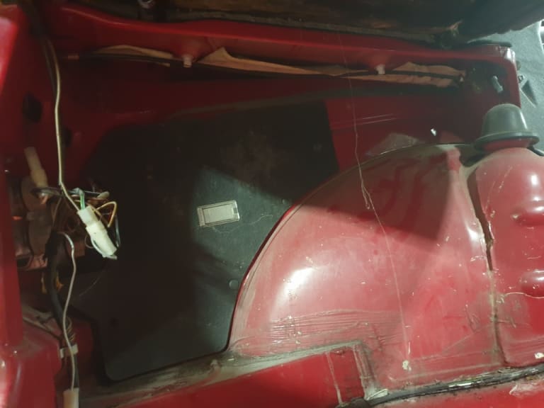

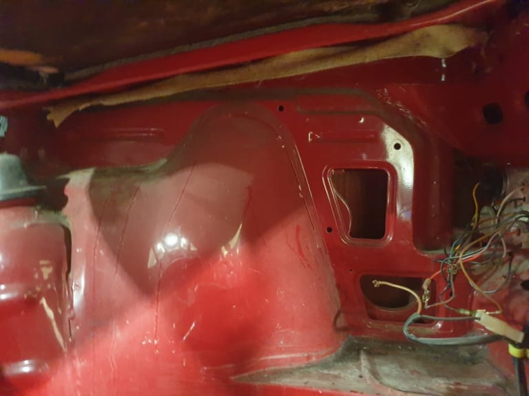

There will be hydraulics in the boot behind the side card.

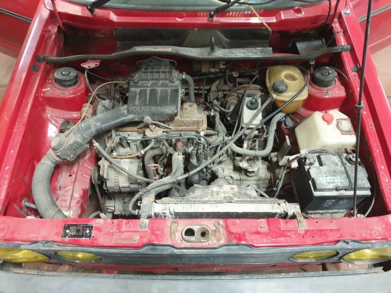

What's going on with your clutch cable, has someone fitted a South Africa later golf clutch cable mechanism as your cable is routed behind the engine, what’s the strange bracket fitted to the gearbox end of the cable, that’s not standard?
Yes normal for just the passenger side roof handle to have the locking tab, stops the passenger opening the roof if they use the handle as a grab handle.
Yes that’s how the roofs come with no hole, once the window frame is in place you have to cut a hole in the roof and staple it to the frame then fit the window. The rear tension cable along the back of roof should also not been seen, might be lose. If you are getting someone to fit the rear window get them to look at the cable.

Ref that clutch cable, I haven't even started to look at the engine bay yet. Will get round to it later today, I love that questions get brought up just after seeing one picture of it . I'll take some more pictures later and see what your guys think.

If you have got an electric roof and you need bits or if you want to go down that route, I've got what looks like a complete system with wiring and dash panel/buttons that came with mine.

Which side of the boot should the roof electrics be on, I'll take some pictures and see if there are indicators of them having been there previously.
The pump etc is behind the passenger side card, there should be a little screw tap near the bottom ( Luckily I don't have an electric roof so not 100% up on this)
Link here with some pics or post up a picture of the boot card.

Took the radiator and fan off, tested the fan and it works. Radiator is getting replaced.
Hoovered a lot of rubbish out of the engine bay.

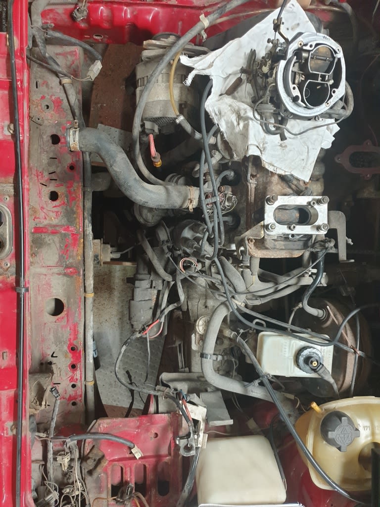

Started to look at the electrics…felt sick…stopped looking at the electrics. There are plugs and loose wires all over the place, odd bits cable tied everywhere. I think I'll service the engine and sort that first then come back to the electrics!
Drained the oil and took the oil filter off.
Took the air box off. There are no ends on the ducting, just the ribbed hose to the air box.

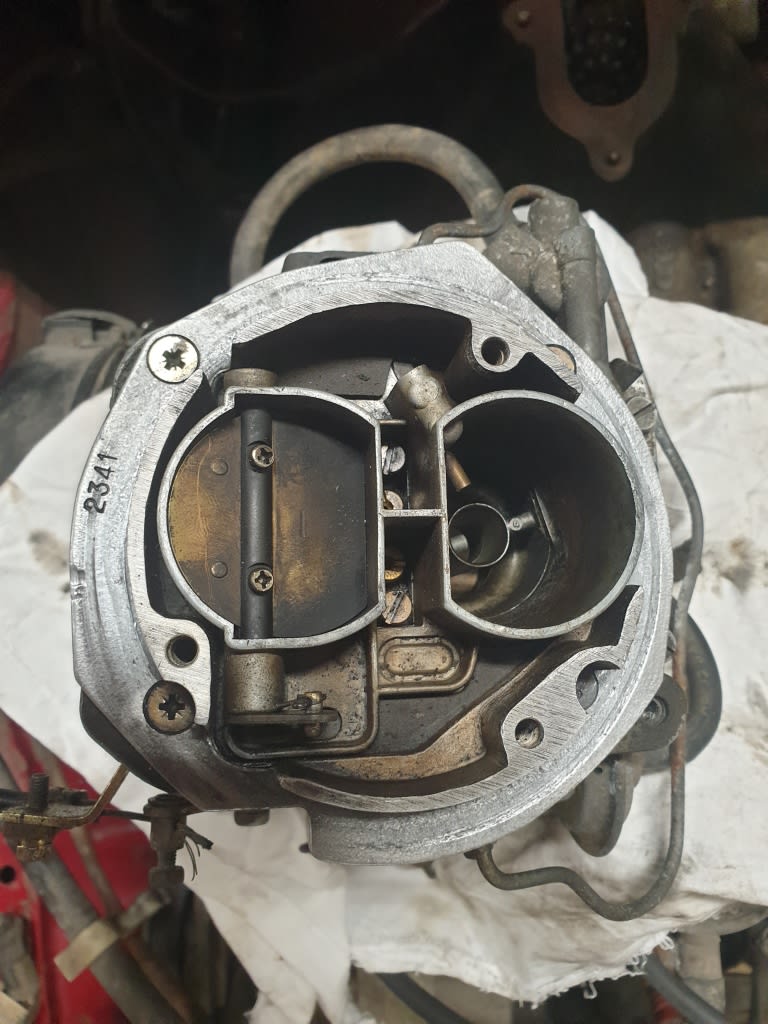

Looked at the carb and realised that the base of it has split. The thicker rubber base under the aluminium spacer, think its referred to as flange?!

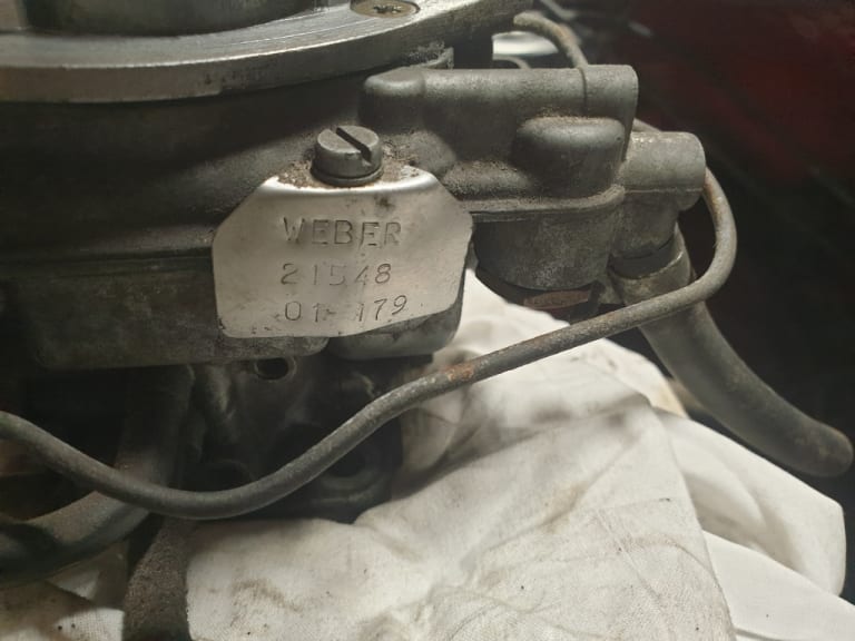

Thinking about stripping the carb, cleaning and replacing gaskets. Just need to identify which it is. Marked up Weber but has two different numbers on it.
21548 01 179 on the little plate & 2341 on the top edge.
Any advice for stripping the carb?

From the factory only Pierburg carbs were fitted.
The Weber is a common conversion because the pierburgs are super complicated and a pain to set up…
Do you know how to confirm the Weber carb so I can look to strip and replace gaskets?

The 2 levers inside the car near the back seat are to release the roof once it's folded down as it's locked in place to stop it flapping away when driving with it down. Both knobs have nothing to do with releasing the roof to fold it down.
There's a guide on replacing the roof which should help with gaining access to see if anything is missing or jammed, I'll find the link and post it up for you.
The Webber carb looks like a standard replacement 32/34 DMTL,.
Service kit for a DMTL
https://www.ebay.co.uk/itm/WEBER-32-34-DMTL-CARB-CARBURETTOR-SERVICE-KIT-ORIGINAL-WE411/361073073190?epid=1524818763&hash=item5411a1dc26:g:FuIAAOxyOM5Ra6BQ

Lots of places sell the rubber carb flange.
https://www.classic-vw.co.uk/mk1--mk2-golf-rubber-carb-flange-mount-16-4-bolt-027129761-11865-p.asp
And this one?
https://www.heritagepartscentre.com/uk/026129761a-carburettor-flange-for-2e-pierburg.html
