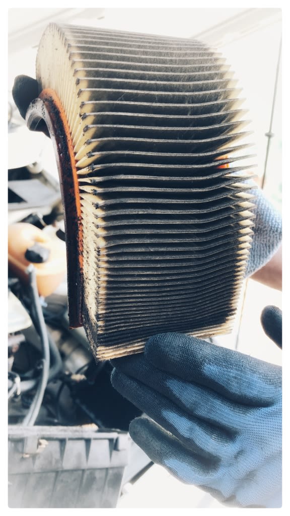

I thought I'd get a closer look at the Carburettor, so carefully removed the Air Filter to see what was lying beneath - chuffed to find a Webber! Check out the Air Filter, it's definitely ripe for changing out - good thing it's been ordered!
Thrilled to have greasy fingers and grazed knuckles!

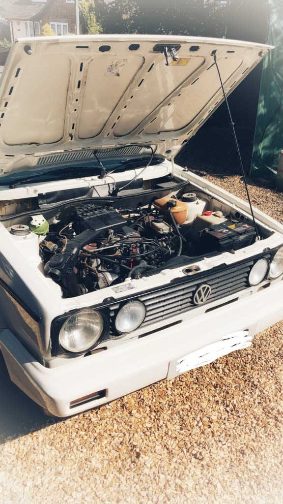

Finding it had a Webber DMTL 32/34 carb was a bonus, but that’s the end of the good news. The carb was missing the Air Filter Adapter that mounts on top of the carb. As a result the air box had been bodged on top of the carb. Its filthy and obviously well overdue for a rebuild and the fuel hose looks like garden hose
Missing air Filter Adapter:
Manky carb
If a jobs worth doing properly………………….or not!
A new Air Filter Adapter is £65, so instead we bought a second hand carburetor for £75 that had the missing adapter as a parts donor/replacement.
