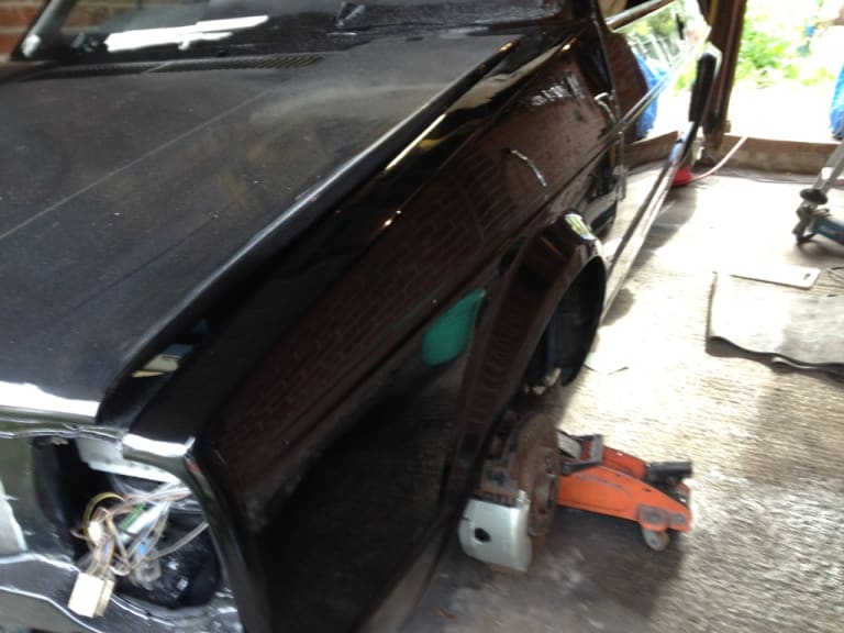

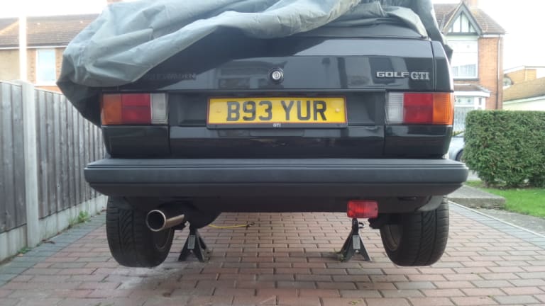

Not a good place to put your axel stands on the front, that bit of metal is hollow and easily crunched, I place mine on the rear wishbone mount, just in front of the anti roll bar and use some old cardboard on top of the stand to stop marking the paint work.
If you do need to place the axel stands where you have put them, if you are removing the wishbones then place a long bit of wood to spread out the load.

Yep suspension will be changed before I actually really start driving her properly, the front springs were an advisory on the current mot

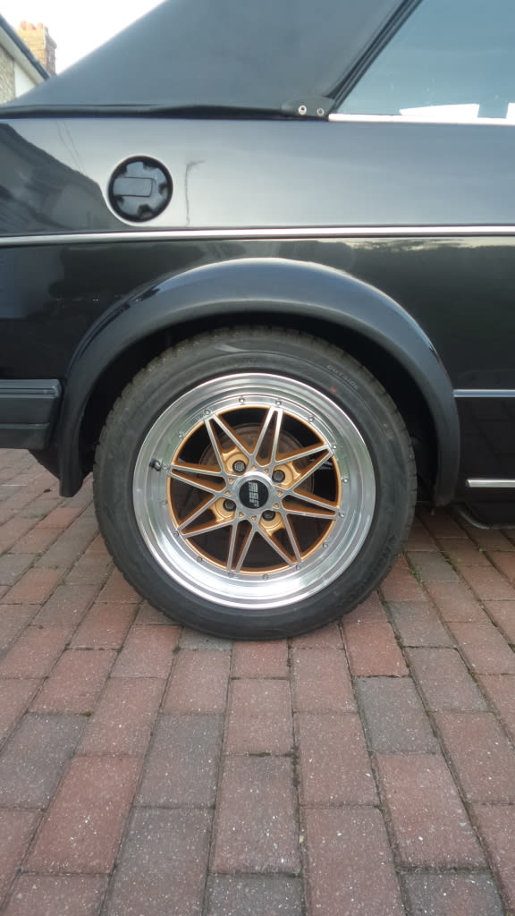

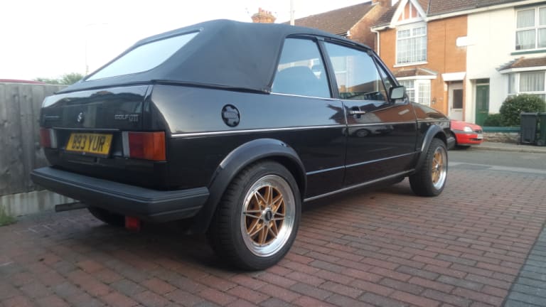

But did manage to fit a missing waistline trim and fit these beauties, back end sits quite nicely but front badly needs bringing down to earth
looks really tidy and original

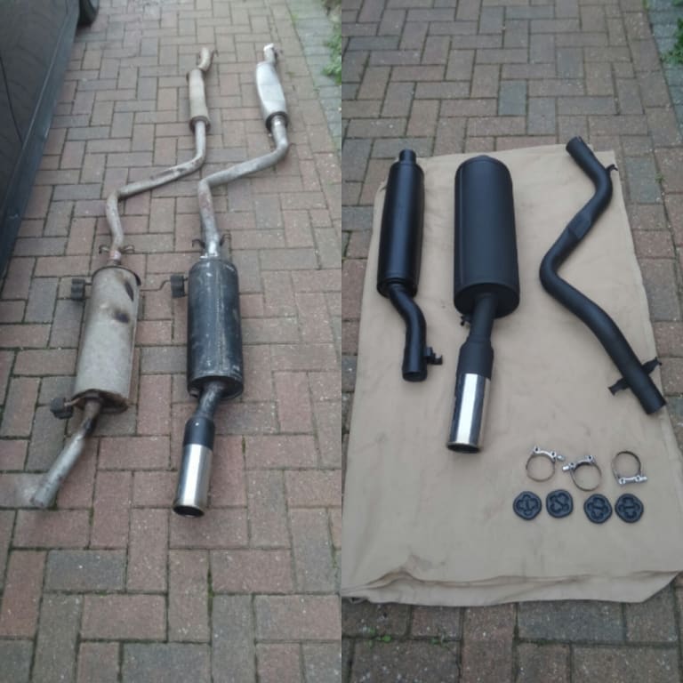

Allegedly only done a few thousand miles but looked scruffy. My old middle box was blowing anyway so it needed changing.
Decided to paint the full system to match the satin black back box, so rubbed it all back and sprayed it all with VHT satin.
Here is a pic of the original system and the jetex as I received it, the right is how now

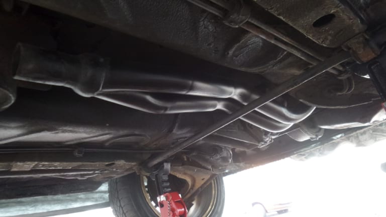

While under the car I decided the original down pipes would let the rest of the exhaust down so this got the same treatment
Armed with new rubbers and clamps I aim to fit it this weekend, looking for to hearing it running

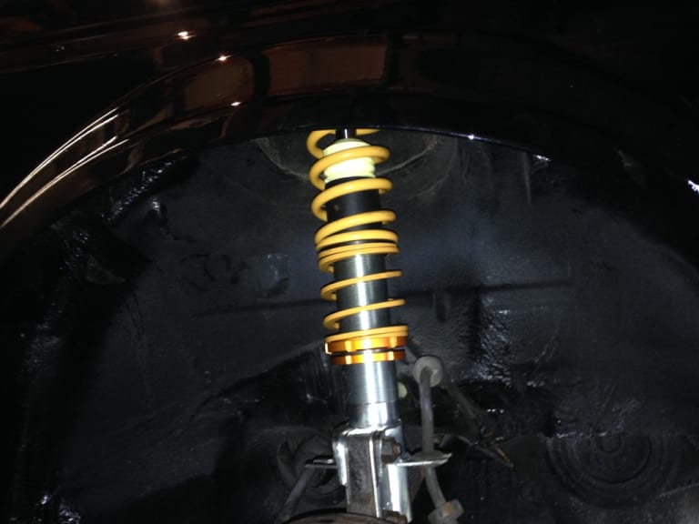

I now have a completely different front end and car is sitting on its Prosport coilovers.
185/45R15's on the front are looking a little lost so going to space out a bit and lower slightly more

How's the Prosports working out for you?
Interesting tyre size choice on the front. Do they clear the collars on the coilovers ok? My 195's are very close and I have to keep the front end high just to miss the collar and tyre meeting……
