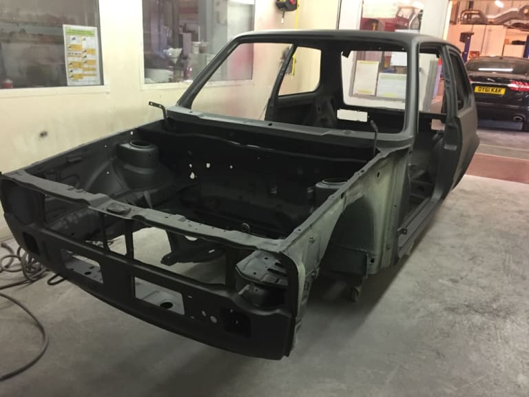

So this is my build thread, sorry you missed the bodywork , but now things should get interesting IMG_0113.JPG IMG_0113.JPG IMG_0113.JPG IMG_0113.JPG

Your shell looks in great condition. Looks to be an interesting garage its in too 👍🏼
What's your plans?
Matt
Looks good, my black GTI is in the paint shop at the moment (where it's been for 6 mths!) so will be following this with interest.

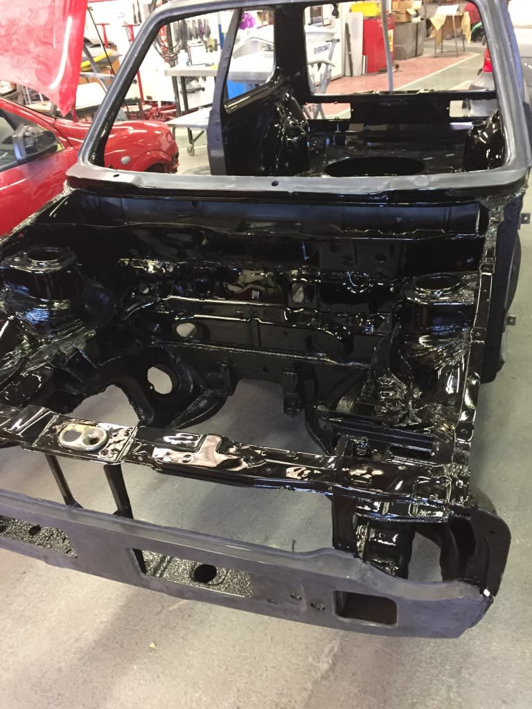

Very nice  :cool:
Sweet!! ;)

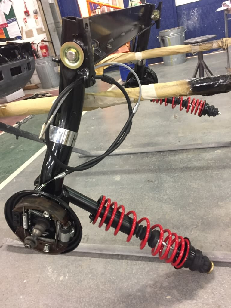

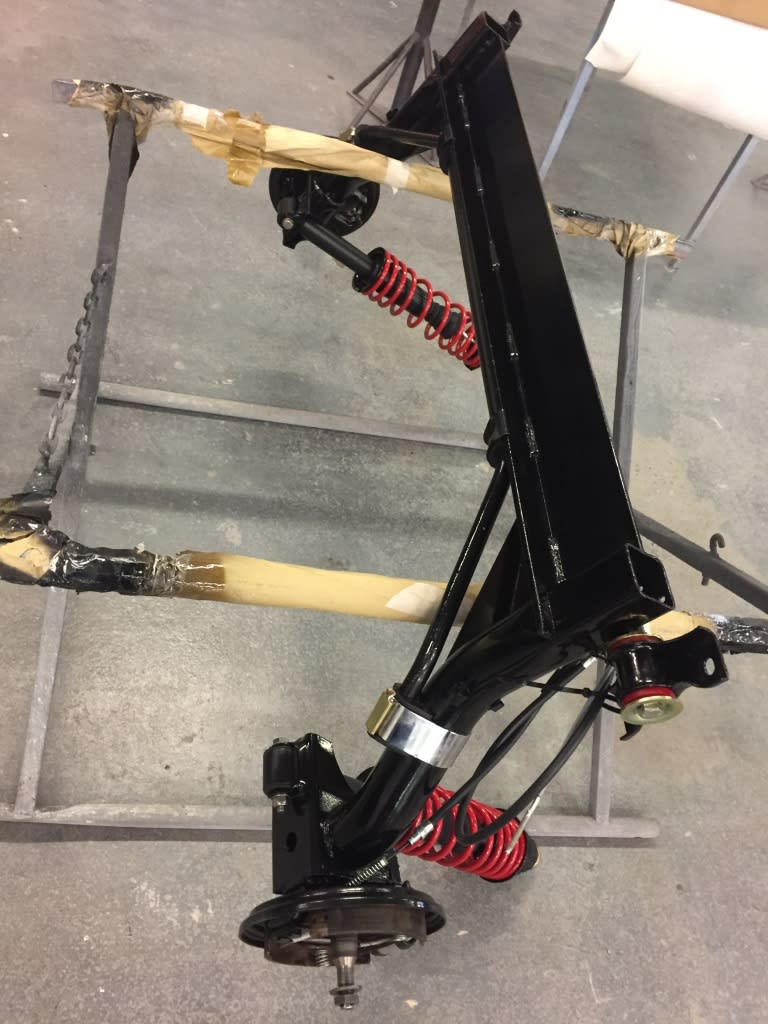

Suspension all powder coated and built up with new parts and stainless steel bolts …. 😎
Looking tidy  :cool:
All looking like new, very nice  :thumbs:

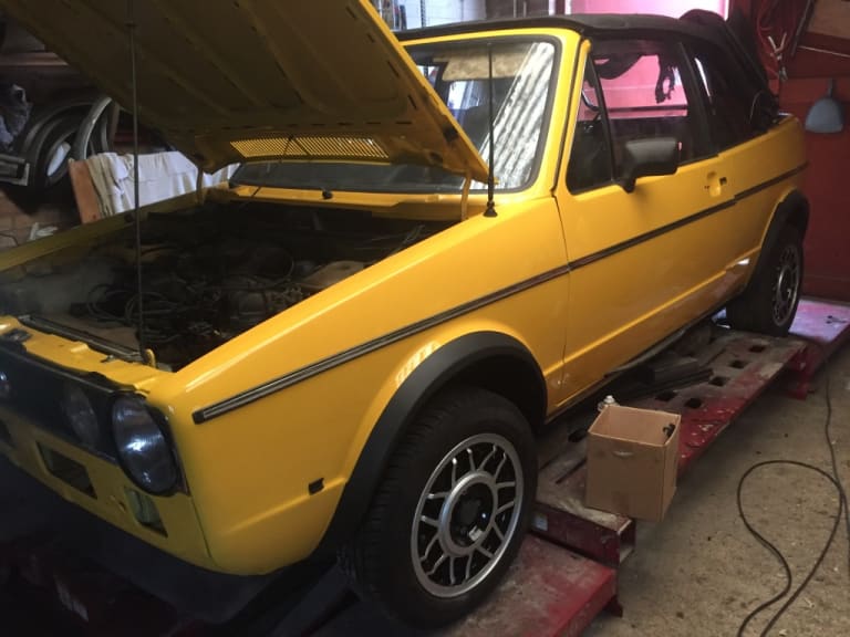

Yipeee!!

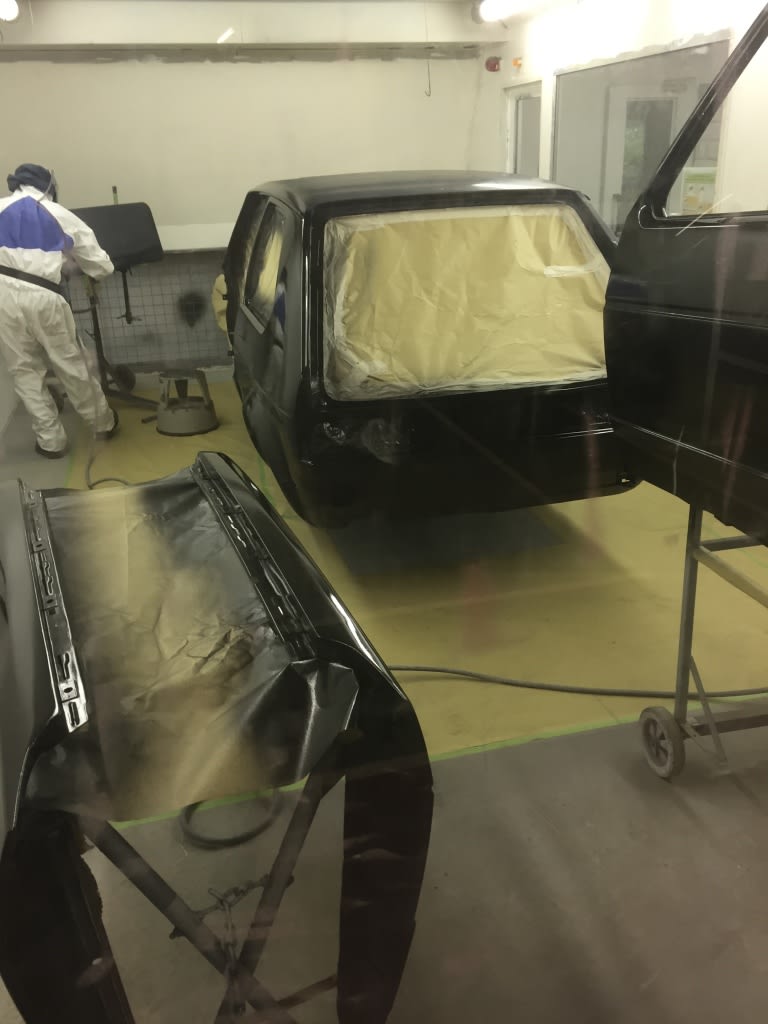

She gets paint!!

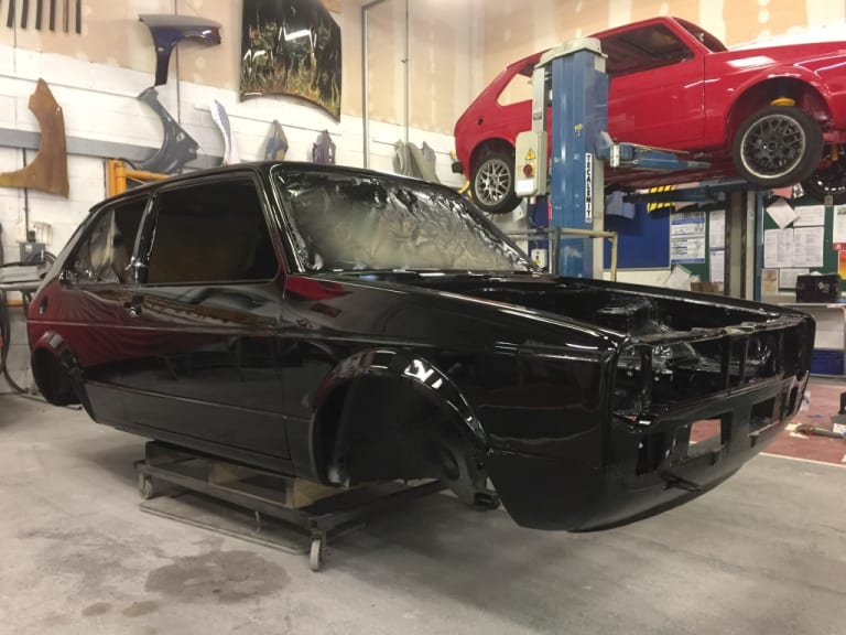

Nice!  :cool:

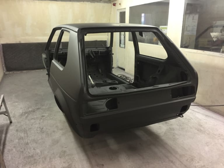

IMG_0517.JPG Coming on a treat! Body and paint done, just fitting up👍
Your mad!!! Surely one mk1 golf causes enough hair loss  :lol:
