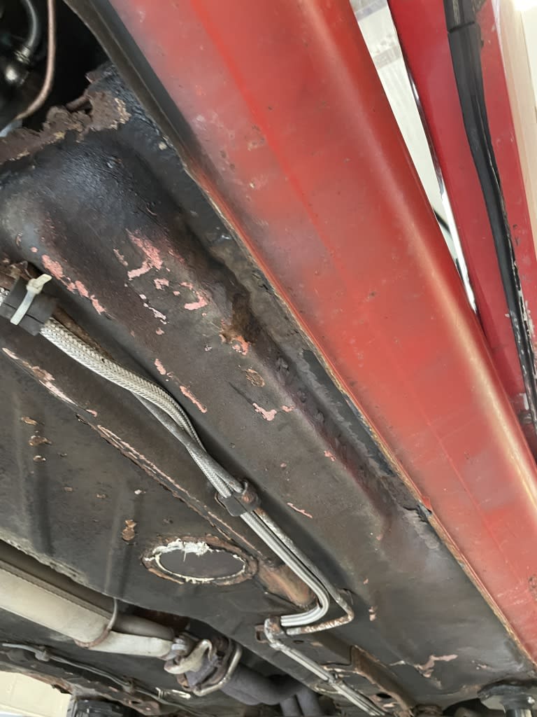

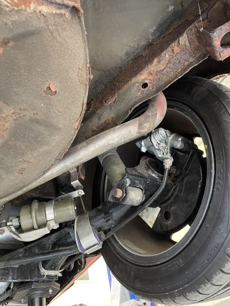

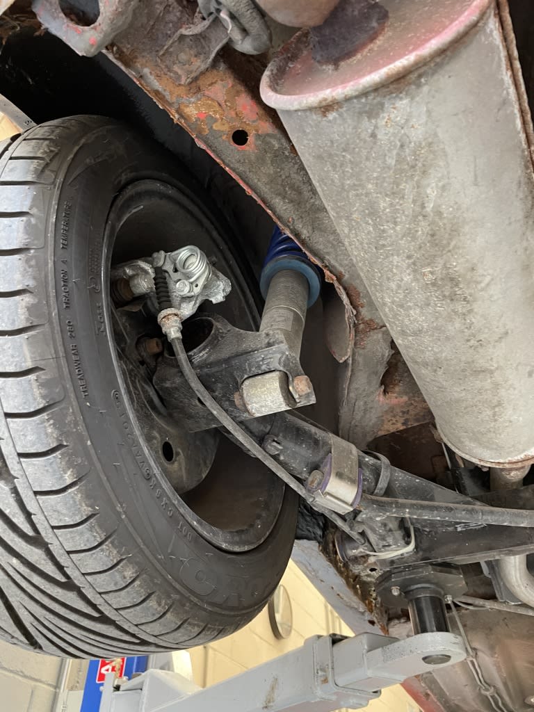

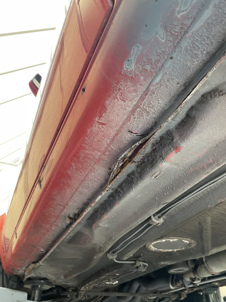

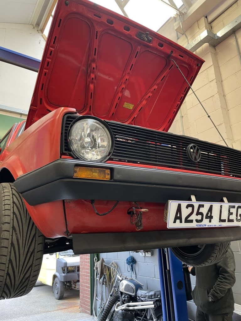

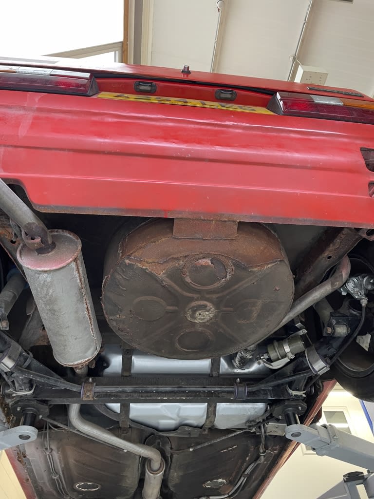

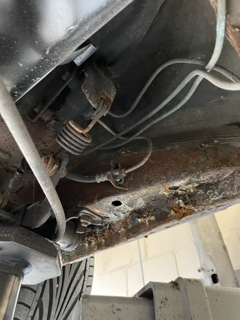

Got it up on the lift today and nothing that needs addressing urgently which is good.
 At some point it looks like the car was sat on something that squashed the floor and sills just behind the front wheels.
 Couple bits of welding to the chassis at the rear I'd like to prioritise and then work round doing sills, wheel well and corners etc where it's getting bad.

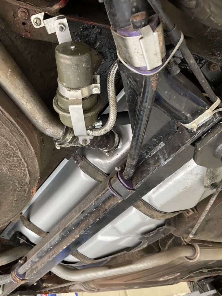

 Sorted the rear beam and running gear, fuel tank, fuel lines, pump, accumulator etc and that's all still looking good.
A few pics:

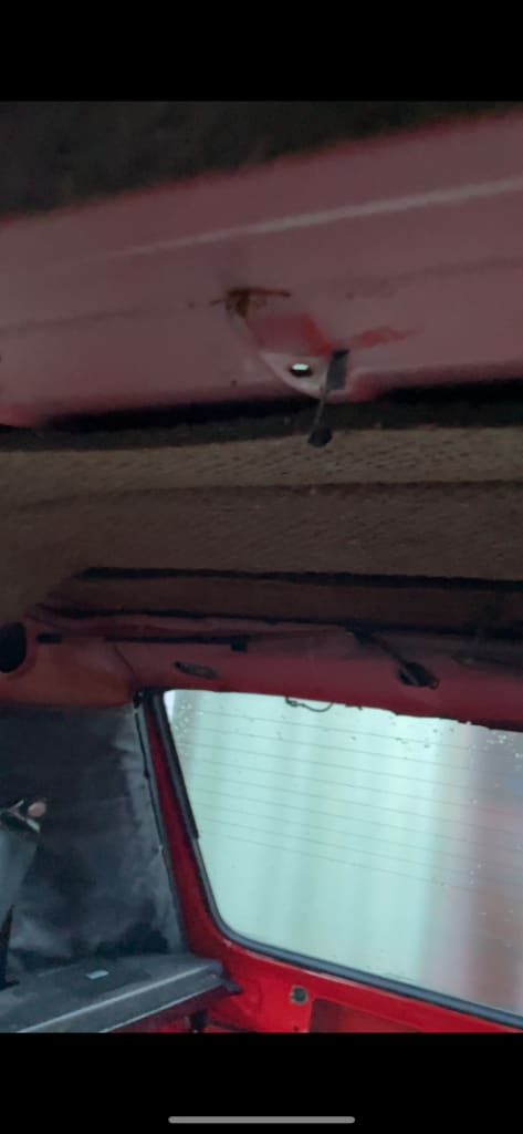

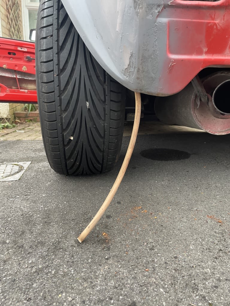

 Despite a new sunroof seal it let some water in, although I'm guessing they are designed that way as otherwise there would be no point in the drainage holes, which are definitely blocked.
Can anyone confirm if these holes in the inner roof skin are from factory, or if a previous owner had drilled them to relieve the water build up?
Safe inside for now until the weather improves
There are 4 drains for the sunroof , one in each corner, with pipes attached which run down the pillars, so I'm not sure what the hole in your image is for.
Yeah those are all blocked for sure, have got a pipe cleaner on the way as the actual metal parts are clear so blockages must be within the rubber tubes.
I'm thinking someone drilled those other holes to relieve water at some point
Dano said
Could it be a bee sting aerial hole?
There are multiple holes, 1 on each structural section of inner roof skin where water could sit so I don't think they would have been for that

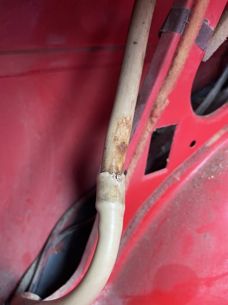

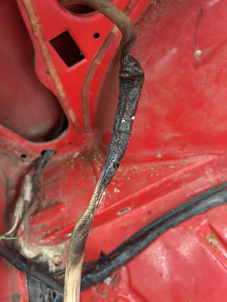

Well this is the state of the drain tube after there was a fire on that side of the car when a garage was doing some welding a few years ago.
Definitely the cause of the issue 😂

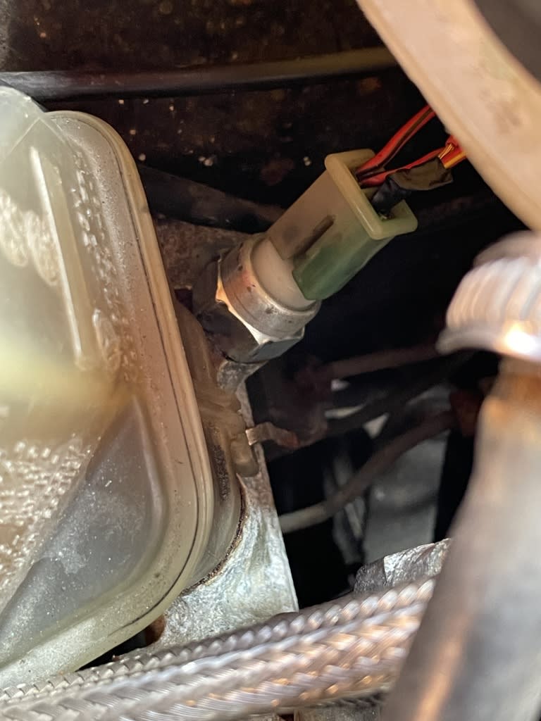

New one on the way along with some other bits. Noticed a decent puddle of oil on the floor under the car today so need to spend some time figuring the source of that.

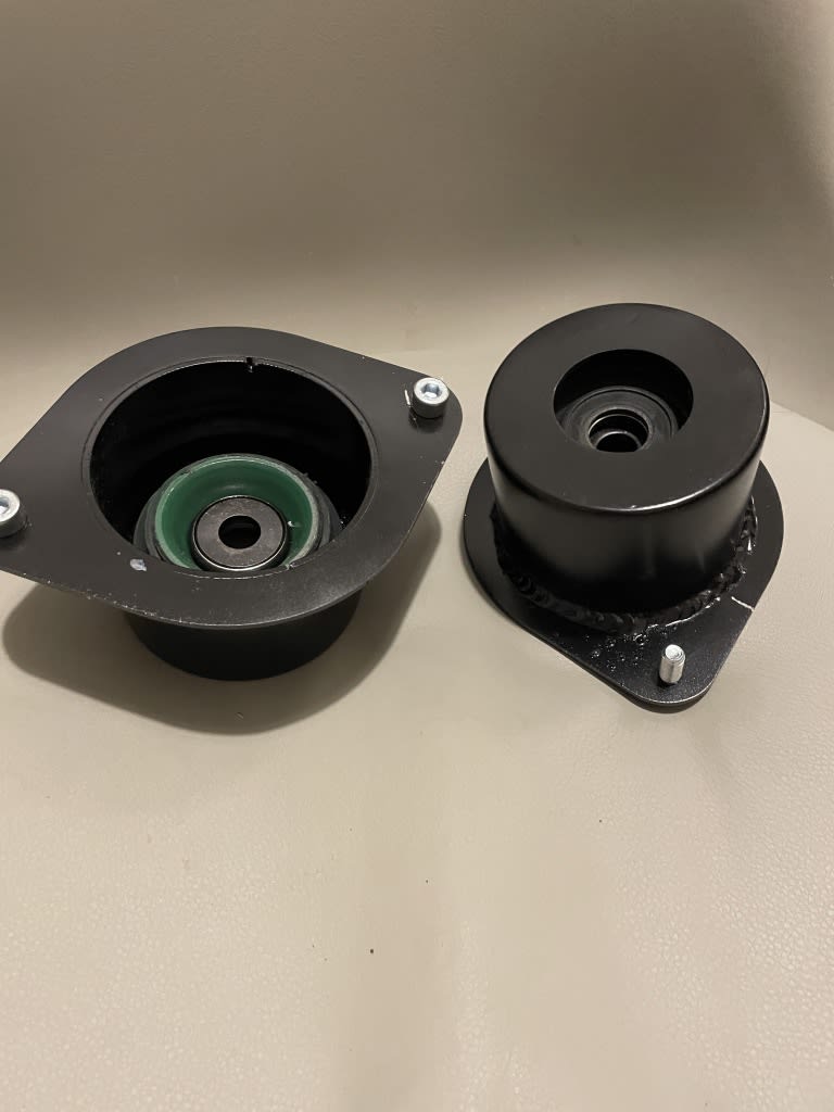

Very speedy delivery of top mount risers from Coltech today, definitely a priority to get these on with all the other issues I've got with the car 😂 IMG_8724.jpeg
Be really interested to see how you get on with these. Did you buy them because you want to drop the ride height or because you want more suspension travel?
The one complaint I have about mine with the H&R lowering springs I have is that the ride is really harsh - well it is with the state of the roads round my way, not to mention the speed bumps.
I know I;d have to change to coilovers, but at least then I might find the sweet spot of more travel, but maintain the 30mm drop I have with my springs.
How do you find the AP's?
Read a thread on here with a really good review from someone who had their car pretty low so hoping for good things.
I used to have lowering springs with koni adjustable dampers and it was such a comfy ride, so I wouldn't expect switching to coilovers would be better for you. Although it may well work out that way with a set of these risers.
I got the APs because they were cheap on here and needed a set quickly to replace the rotten set, didn't realise they were meant to be semi decent as the ride is not good 😂 maybe I'll change my opinion with some more travel as I don't imagine any ride good when you lower them.
I'll try and get a before and after video as I feel like I'm being thrown all over the place by bumps in the road at the moment so it should be quite an obvious change.
Sorted out the drain tube, the one I got wasn't long enough but  connected it to the good parts of the old one. Now at the length VW should have made these from factory 😂

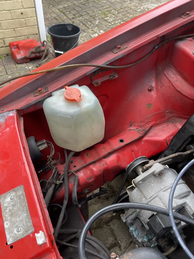

Also switched out this giant screen wash reservoir with a smaller one that was lying around while I was trying to get the lower plastic belt cover to sit better. One of the bolts snapped and I need a smaller drill to get in to remove and replace it so didn't get very far with that
