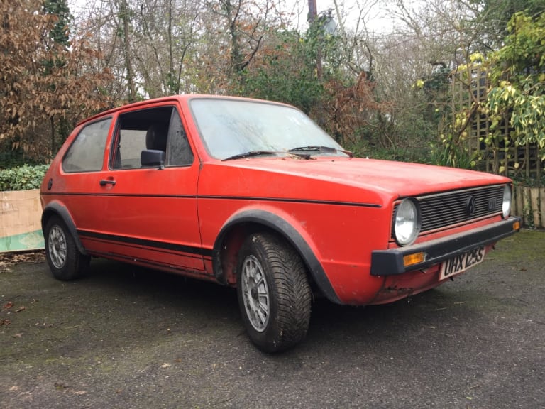

Esp this one as it looks a good enough base to be thoroughly overhauled to MOT standard rather than full on restored.
Good luck with what ever you do it
Last edit: by goldie_88
Early 77 year model Golf. 4-Door
Looking forward to a full resto project

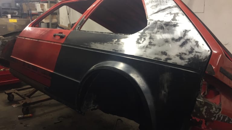

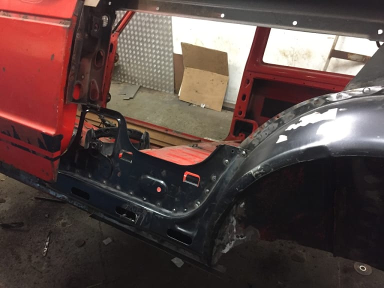

The rear quarter had been replaced at some point due to a coming together with a barrier. It had been porrly fitted and the inner arch was corroded. Easier to pull the whole quarter off and start again.,,,

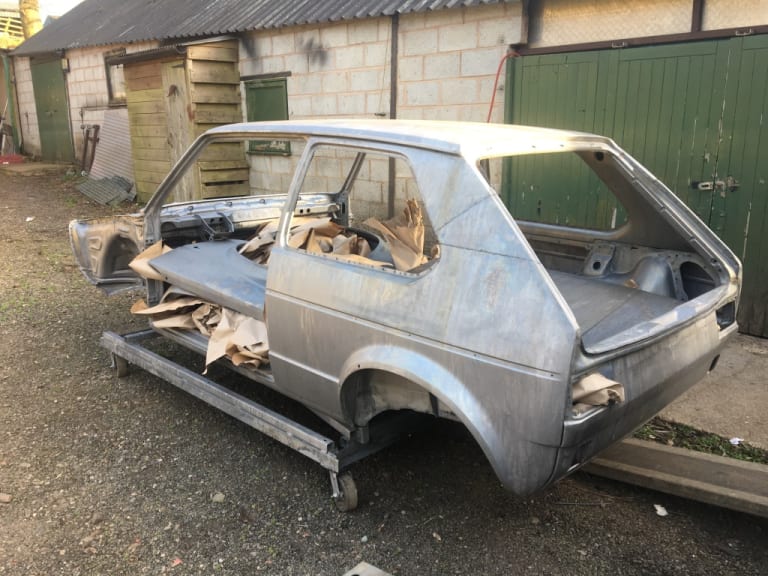

back from dipping…..
tomsdubs said
Doesn't look too bad from a distance…
I'd done the majority of welding before it went for dipping. No real surprises on its return . Just a few pinholes under where the sealer had hidden it.
Now snagging the welding and removing dents followed by body filing before electrophoretic coating.
