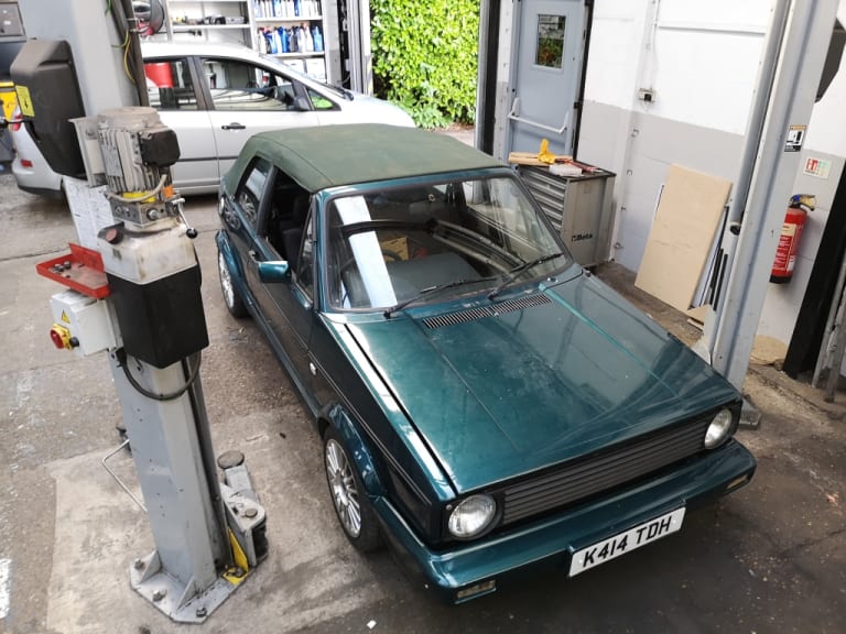

We MOT'd it, it failed on several items, a long list of advisories, and the top hose blew while testing the emissions. It was pushed outside, and we didn't hear from the owner for another 9 months!
Fast forward those 9 months and I find the owner on Facebook, and after some negotiation on price, he agreed to sell it to me.

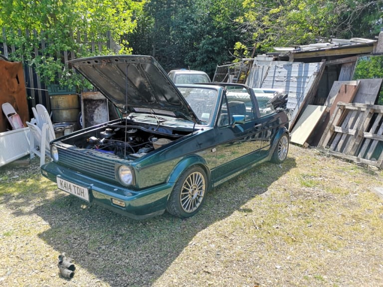

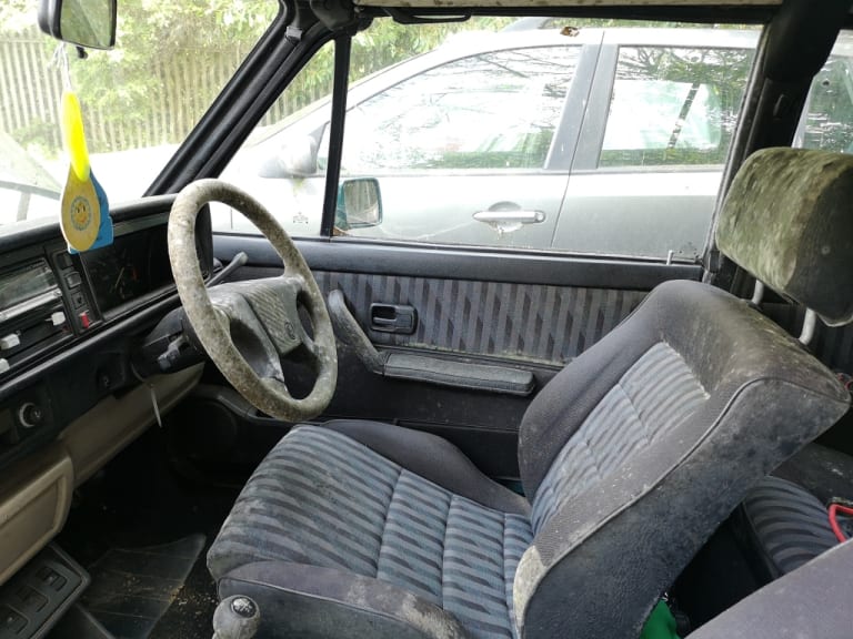

It had been sat outside, untouched. I whipped the cover off to find a very neglected car. The exterior was covered in moss, spider webs, and general c**p. The interior was covered in mould, spiders, bugs, mouse droppings, and smelt very bad!

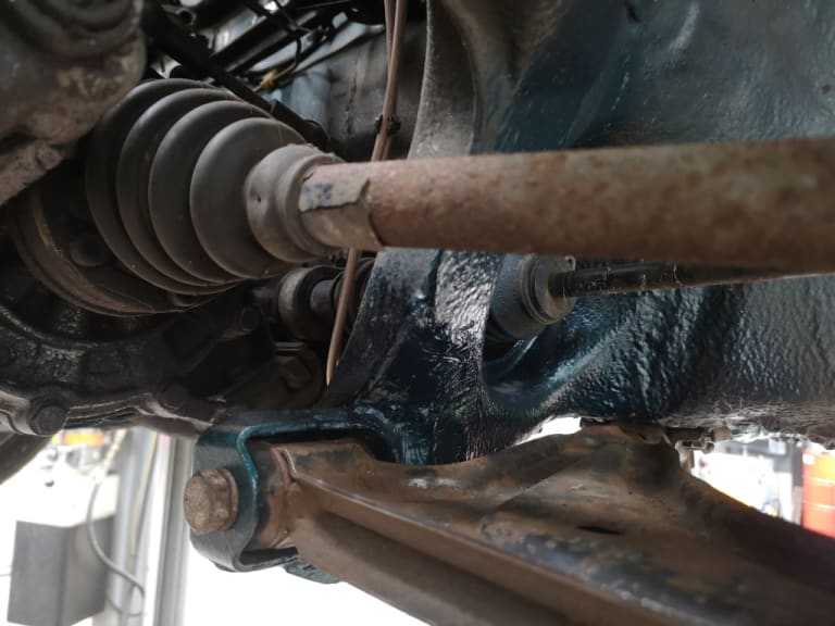

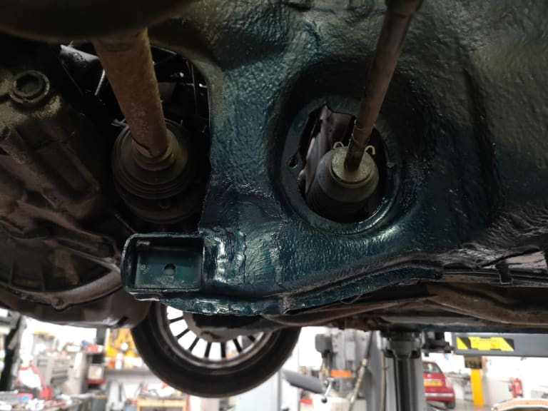

Cleaned off the bodywork, under the wheel arches, underneath the vehicle and under the bonnet. This was mainly to get rid of all the spiders and creepy crawlies!
Inside the boot I found a mouse hibernating between two sub boxes, the spare wheel was full of water, and every piece of trim was wet.

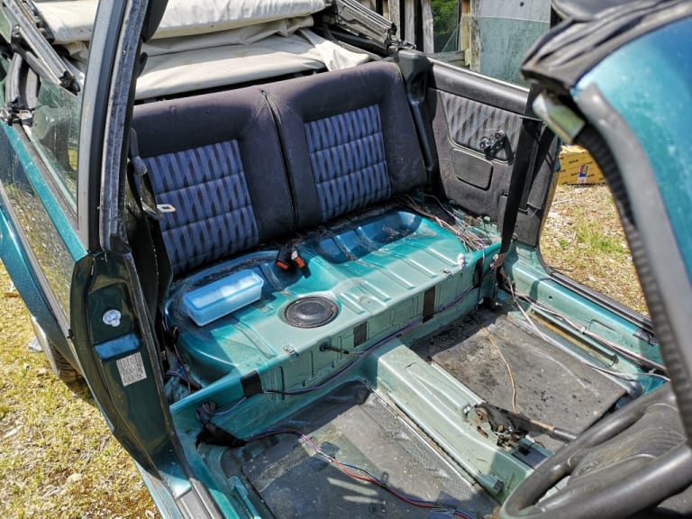

I gutted the majority of the interior; removed the seats, centre console, carpets, parcel shelf, boot trims, and seat belts.
The roof didn't work, so undone the bypass valve to manually open the roof and give it a good airing!

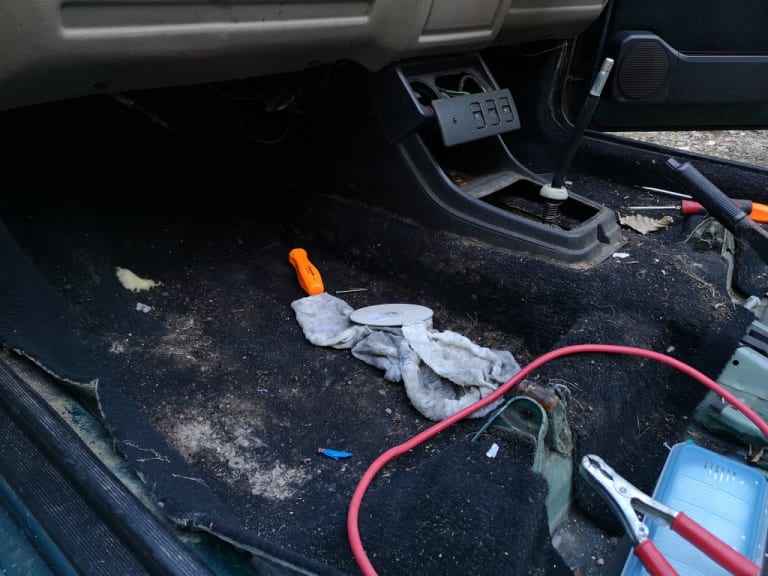

I had to pressure was the carpets. The colour of the water was horrid!
An old friend of mine owns his own detailing and valeting company, so had him come and spend 3 hours on the interior. (Which was still out of the car). He managed to get the headlining look a lot better, and removed all the mould from the seats and door panels.
I then stuck a spare battery on it, and raided my box of spares for a top hose. Got some water in it, and it fired up.

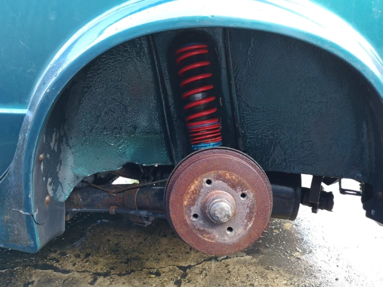

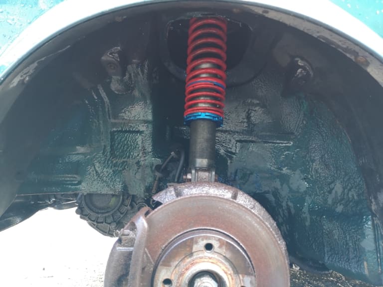

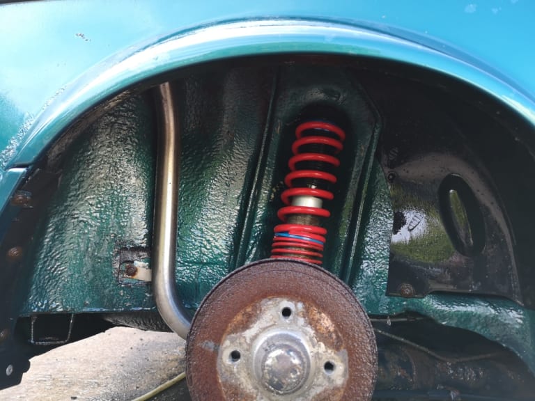

The carpets where still damp in the pics, and found a set of coilovers fitted to the vehicle. I can only assume they are cheap ones.
The inner wheel arches look to be in good condition as well, with little rust visible.

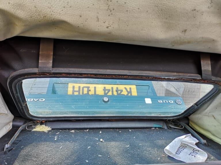

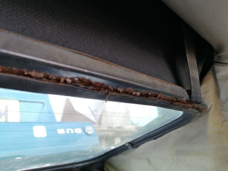

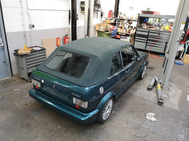

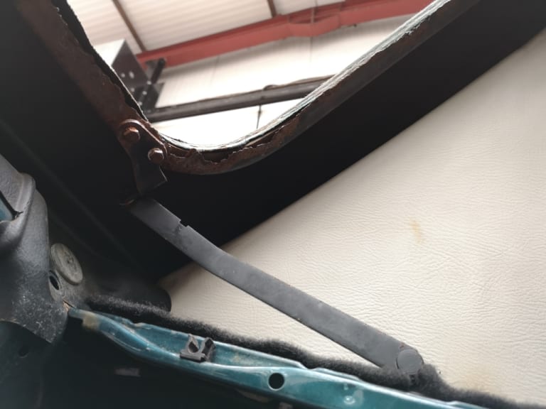

It’s a big job to change headliner as it’s hood off, interliner and padding off too. They don’t stand up to much messing with before they fall apart.
It will be a nightmare trying to change the rear window frame in an already cut top.

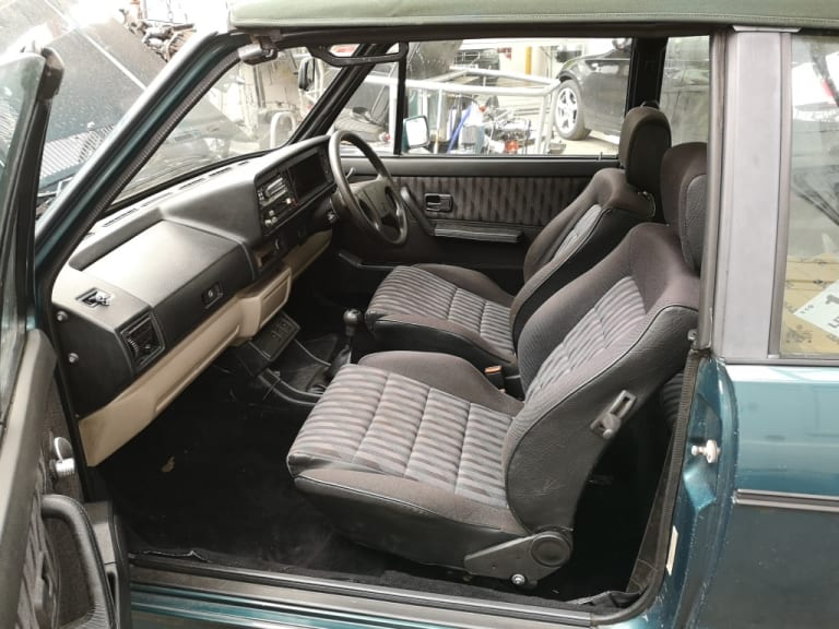

Interior back in.

Had the roof cleaned - now waiting the the sealant to arrive. Don;t seem to have any better pics of that.

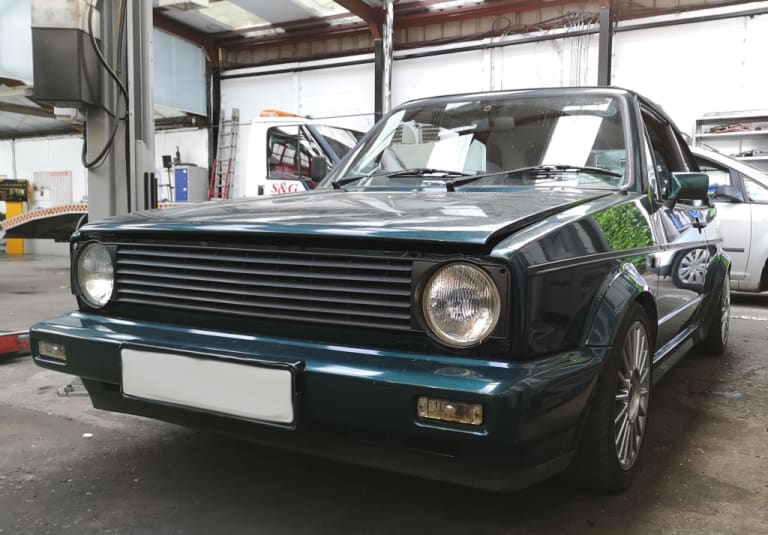

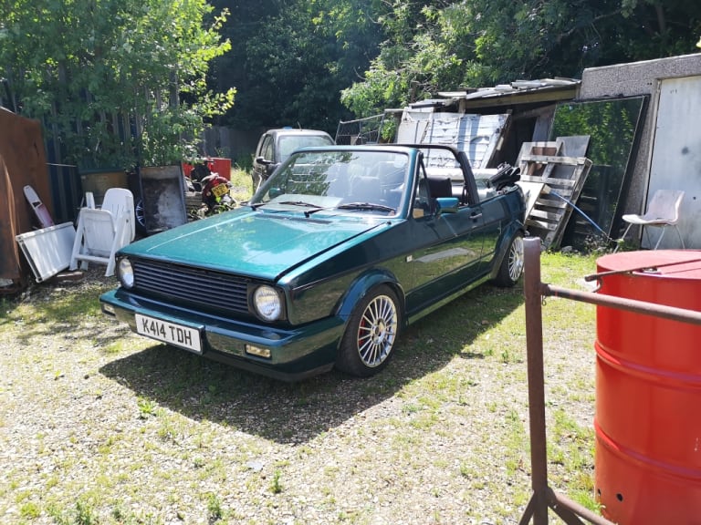

A pics of how it sits currently.
