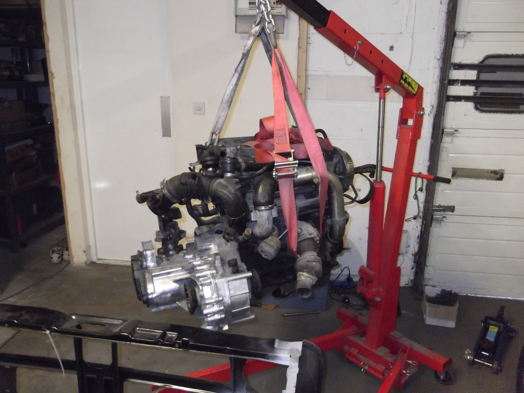

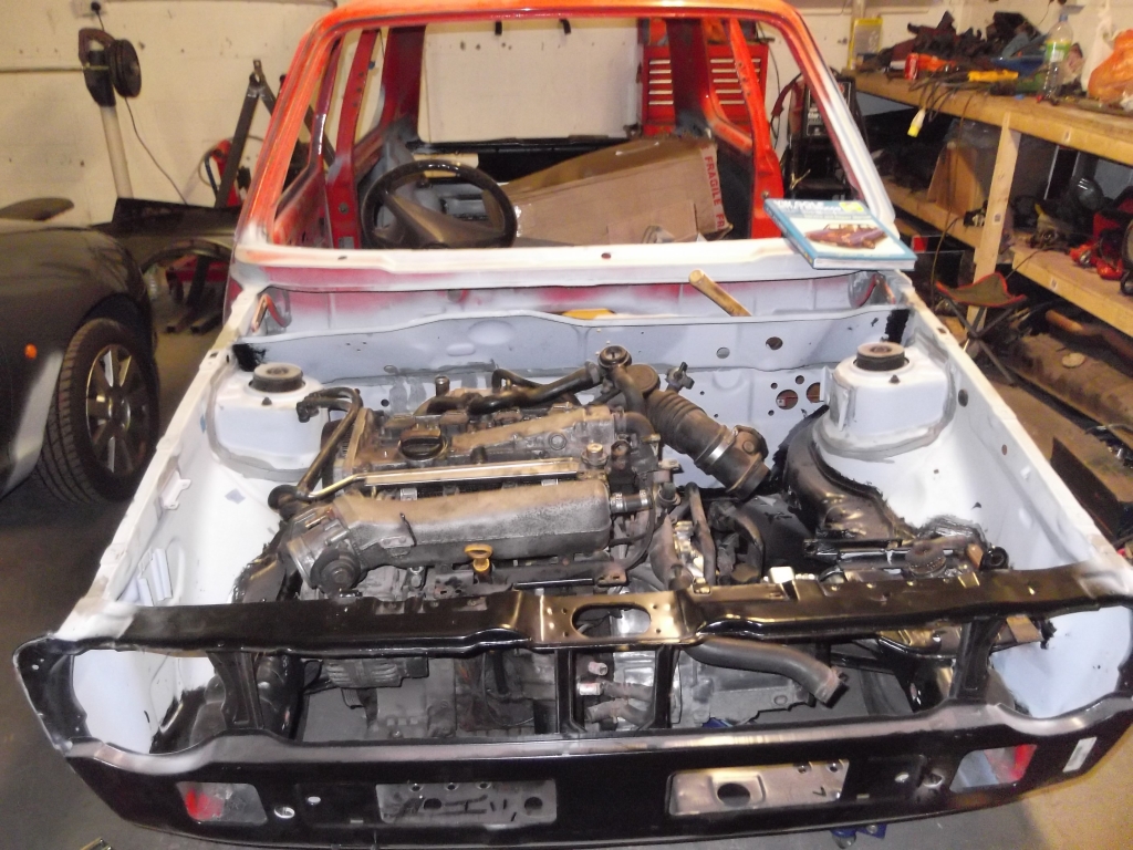

Got the engine partially fitted today, fitted the gearbox mount and the one at the timing belt side, I've got one more mount but can't work out where it goes lol.
Here's some pics

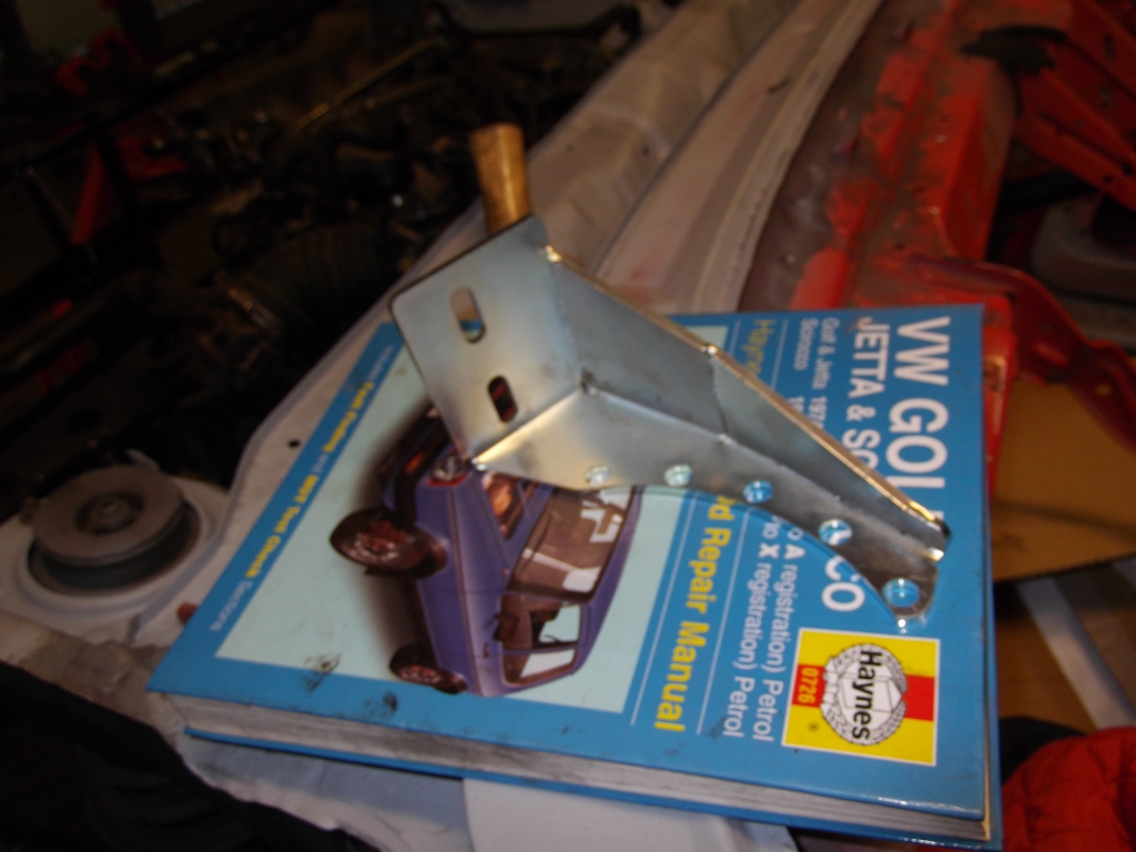

Here's the mount in question, I'm guessing i need another bushing from somewhere?
Cheers, Andy.
Last edit: by Melteddrummer
From the look of the mounting holes I'd guess it bolts to the gearbox.
Yeah me too mate but don't know if its front or rear :lol:
looks like rear to me, then tyhe square mount then the bracket to the floorpan?
