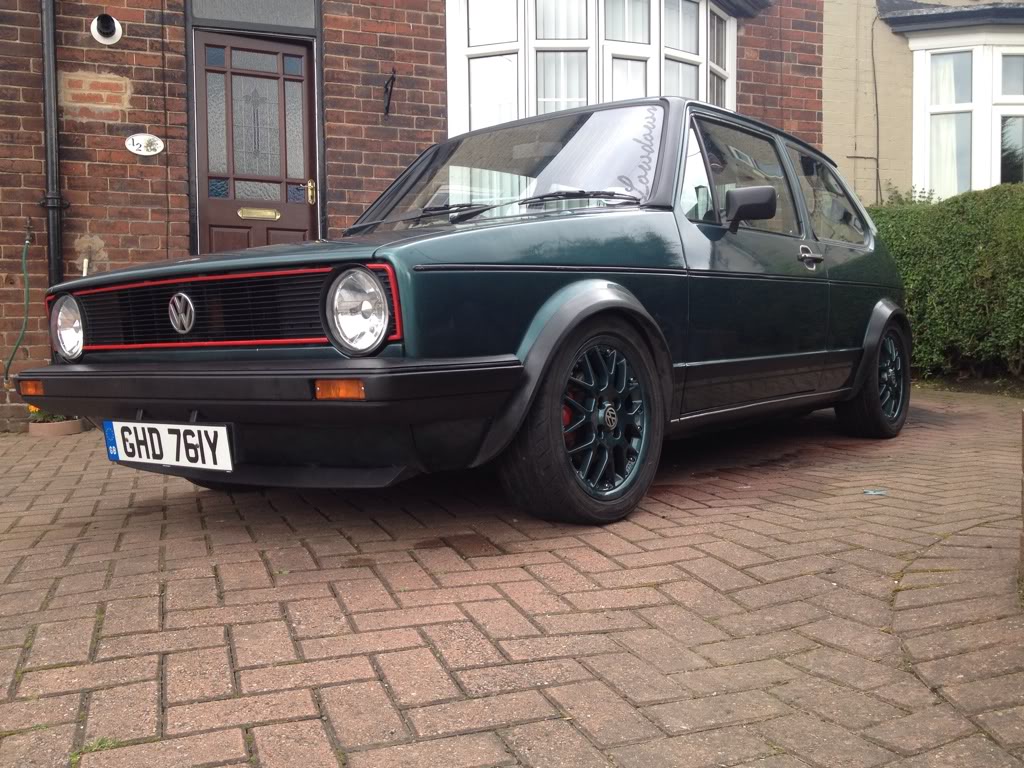

So, after a bit of searching found a local tin top gti with good history and a good runner so snapped the guys hand off for it, picked it up like this,
Wasn't happy with the 13" wheels or the 40/60 springs so swapped the running gear from my cabby I was breaking at this point, mornings work saw this,

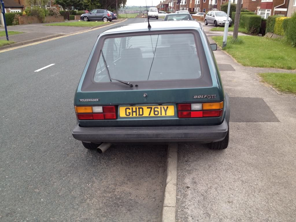

Now the reg plate placement was bugging me, and the rear lights, and the front indicators, got a new bumper, a bloke close by have me back lights for free! And got indicator lenses,
Before,
After
No pics of rears before but they were black, changed.

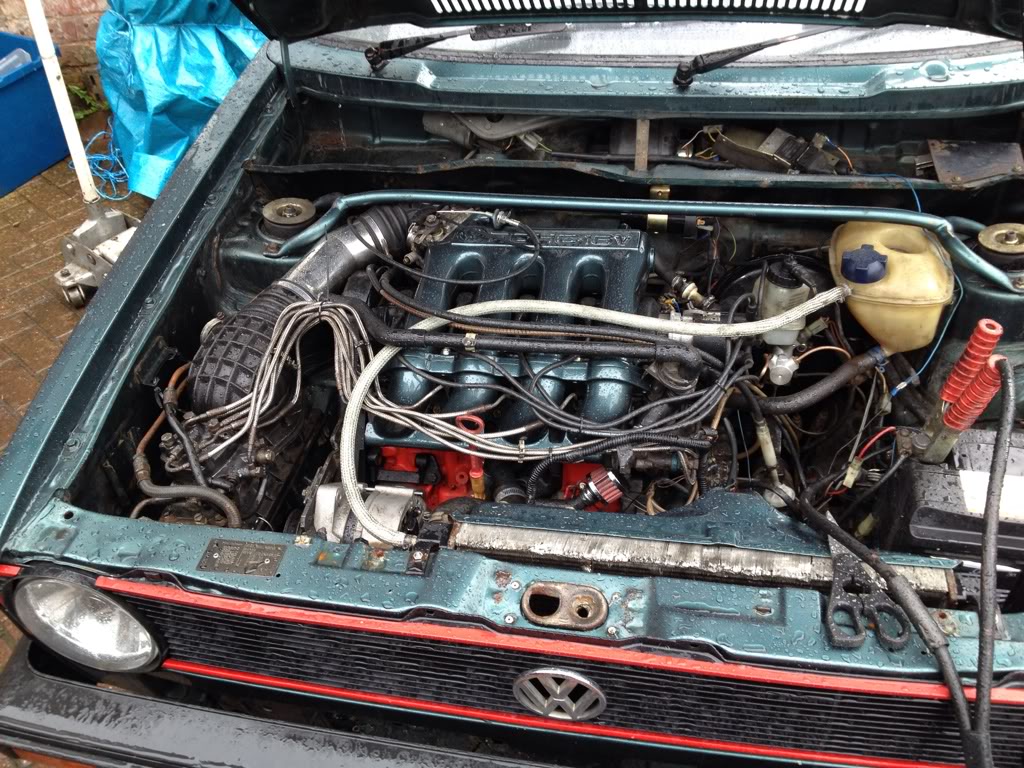

Next was the engine swap, in the day I got block out, hubs swapped over for 100mm driveshafts, engine in, exhaust on, injection side built up, not bad!
Fire proofing, aluminium tape on uj, and a steel plate, heatwrap, and a solder mate between mani and plate.
And engine in :)
And also had alloys colour coded and banged them on day after :) aswell as smaller splitter so I wasn't scraping floor allll the time
Before,
After
And engine in :)

And mogz, its a storm developments manifold, got a Blanket made to wrap the steering boot now though so il be doing away with the plate.

That's the same manifold that I've got.
I have the same 16v set up in my cabby but with dellorto carbs.
Mine was from dub power though….
http://dubpower.co.uk/Exhaust%20manifolds.htm
Same thing as the storm dev ones… I think?  pics are certainly the same…

And mogs the manifold looks same yeah, good manifold but proper close and I never wrapped it first time :(
