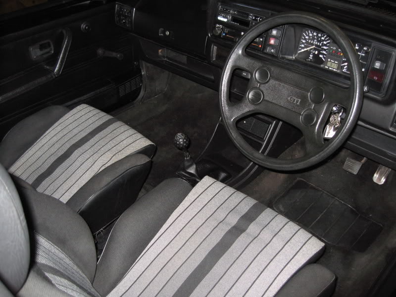

Thought I'd put some pictures up of my motor.
Bought it in April with just over 42,000 on the clock. I spoke with the original owners who had nick named it Black Bullet.
Its all pretty original and has only covered 3,000 miles in the last 8 years.
Short term just looking to tidy it up a bit. Long term I'd like to concours it but I've done that before and don't know if I have enough time to do it.
