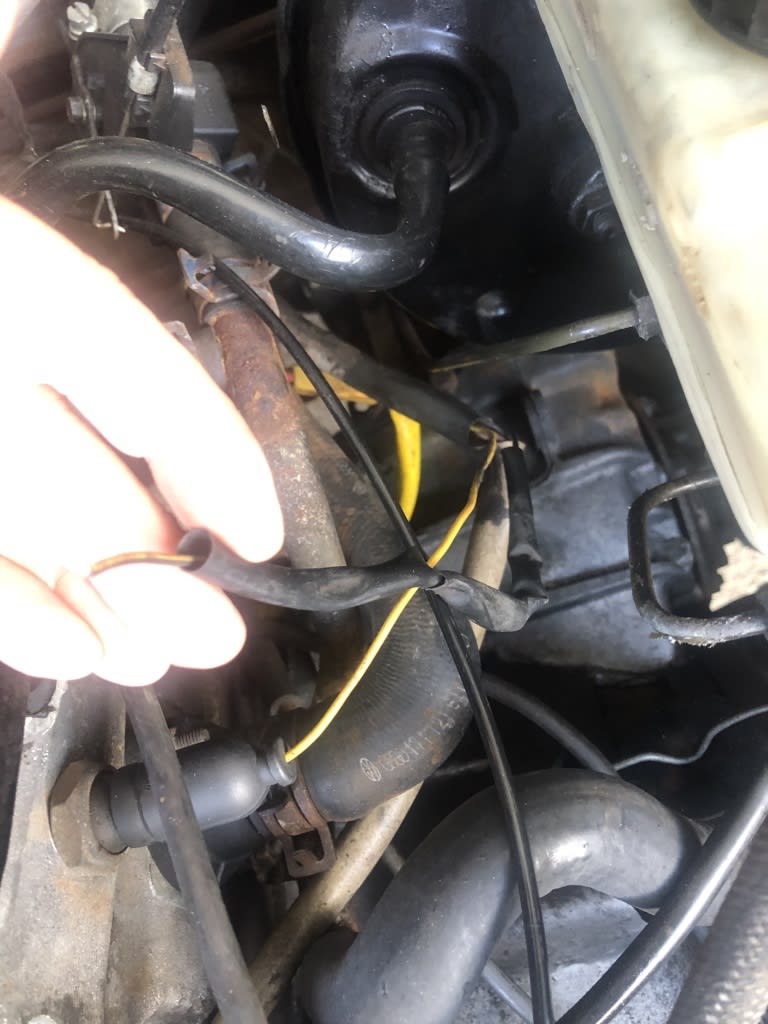

There are two cable behind the stereo/blower control that have been terminated with scotch locks are these for something no longer required, i.e old stereo illumination?
The other images are of cable under the bonnet that I need to identify if poss, the bulk near the fuel filter I assume were for the vacuum bottle removed when the webber went, a grey shrouded cable to the right of the scuttle tray which has a black connector on and a cut black/yellow cable near the sensor on the side of the engine block.
All the best, stay safe during these crazy times and I look forward to bringing her to a meet sometime soon!
As you say, the grey/blue in the dash is most likely the illumination rail - quite possibly to dim the stereo display. Easy to check if it goes live with the lights.
For the yellow its hard to say. The blower has a yellow wire around there. It's also a popular colour for replacement wires. A lot of stereos use yellow as constant power so that would be my guess. Again, easy to test.
If you really want to know, it's actually not that hard to remove the dash and have a look.
