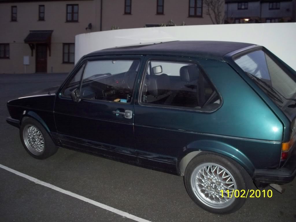

My new baby
Any suggestions on where to start to get her looking something like it?
look good lick a good start
what you want to do to it??
I want to keep her original-ish, maybe get some shiny trims outside and replace/clean up the interior. Don't know wheth er to start inside or out?! Get a respray? The boot needs some welding in the tyre well too.
Any ideas on where i should start? was thinking of ripping out the interior first?!
Hi mate, just starting myself, I was going to sort out everything mechanical first then move onto the body and finish with the interior. Depends what you want to do though, cheers Mat

If you can put up with the bodywork looking less than mint, Id get the engine and other bits sorted first. That way at least it will be usable once MOT'ed etc. You cant drive nice paintwork with a duff engine!!!
If you're thinking of valeting the interior, Id wait until the weather warms up a bit to make it easier on the drying front. The last thing you need in winter is moisture inside the car… and these have enough already!!!

Nice looking tintop mate, good luck with the leak!

Anyone know how to get rid of the dodgy after market sunroof and vinyl roof?
It dawned on me yesterday that the vinyl maybe there to cover up something nasty!
Only way to get rid of sunroof is cut off the roof panel and weld a new one in, i sent a good roof to the crusher just before xmas :cry:
The vinyl, well it depend's what is holding it on, best bet, try boiling the kettle and pour over one corner to melt the glue, and try peeling !
If it comes away keep boiling the kettle and pouring over section's to remove.
If not then try a heat gun for removing wallpaper, but be very careful mate, you could reck the paint with this method !
