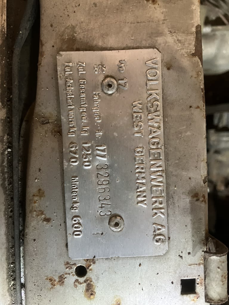

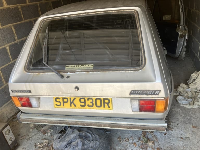

Hi, I've just joined hoping to find someone looking for a project - its a 1977 GLS AUTO 5 door tin top.
I'd be grateful for advice whether it should be saved or scrapped!

Don't attempt to start the engine with the fuel that's in the tank as it will of gone off and could be like jelly, set up a fuel can just before the fuel filter and use that fuel but try and turn the engine over by hand to make sure it's not sized (19mm socket on the crank nut)
Definitely worth saving being a series 1 with the small rear lights and chrome bumpers and early style instrument cluster.
Save it or sell it to someone who will, definitely don't scrap it.
