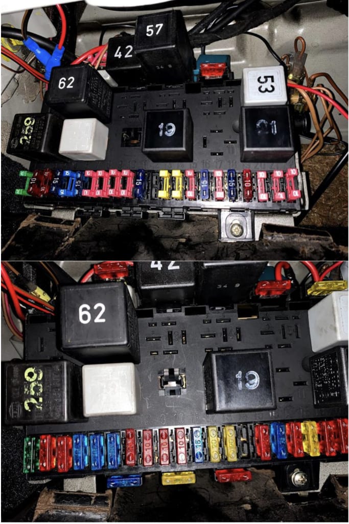

- All fuses replaced aligned with recommended ampage

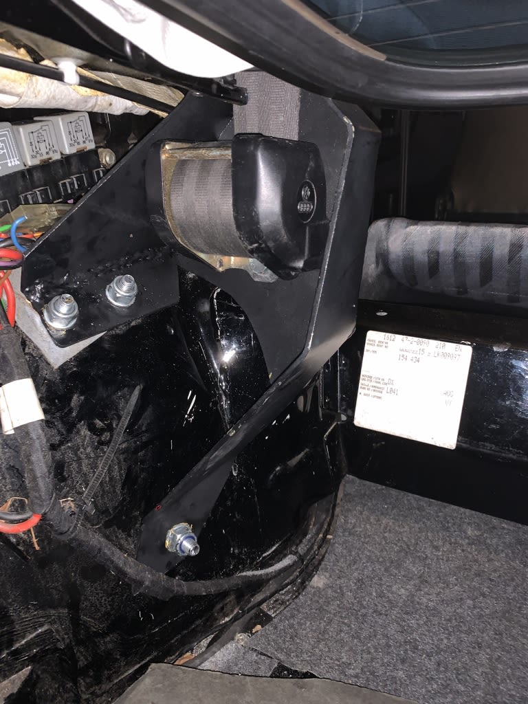

- 3 point rear seat belts fitted

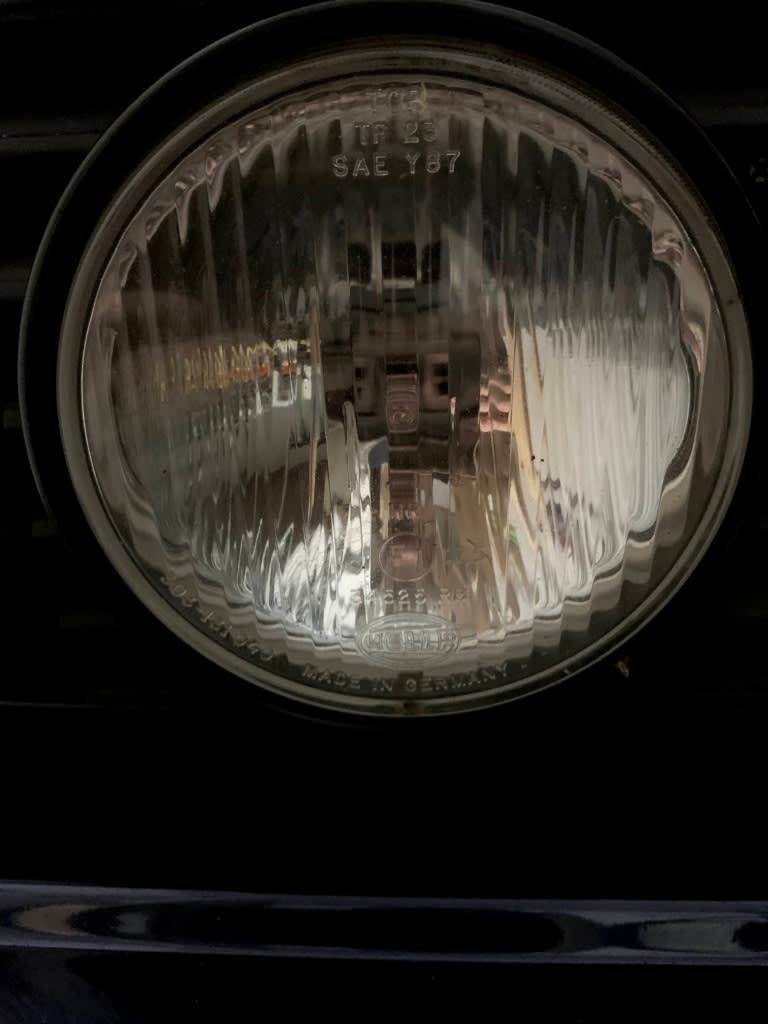

- Misted full beer lamp on the inside cleared

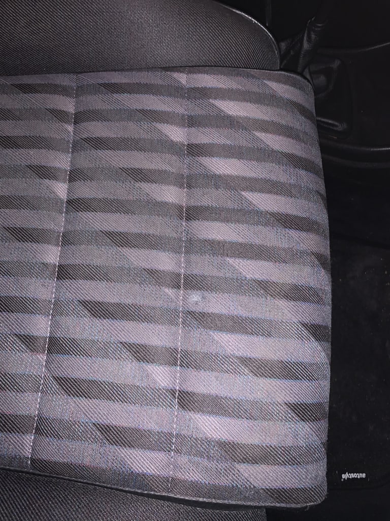

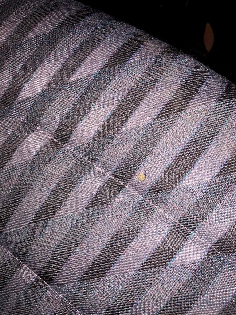

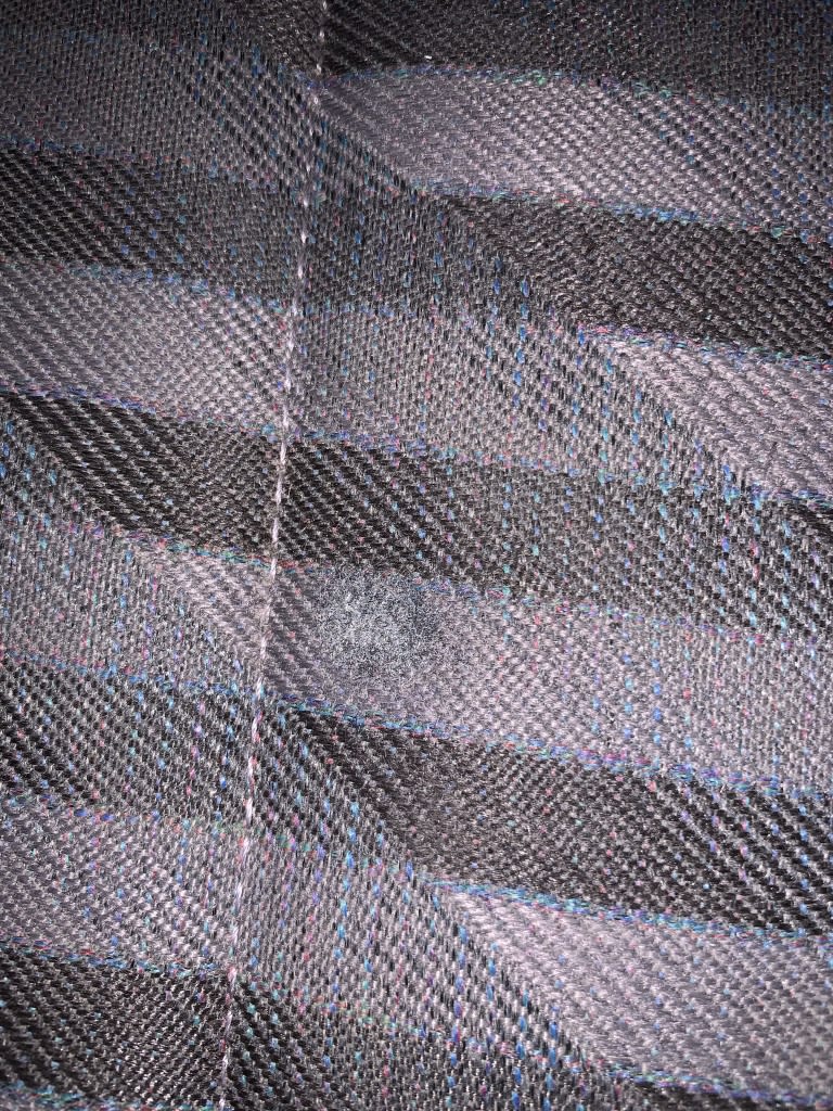

- Cigarette burn fixed on chair professionally

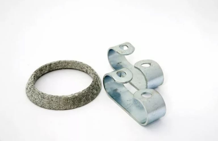

Item purchased
https://www.ebay.co.uk/itm/172244466129
Replaced with

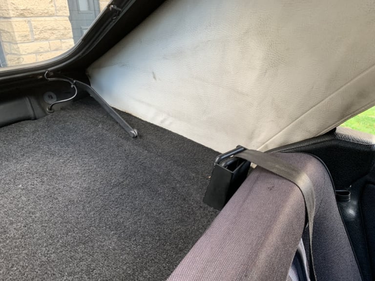

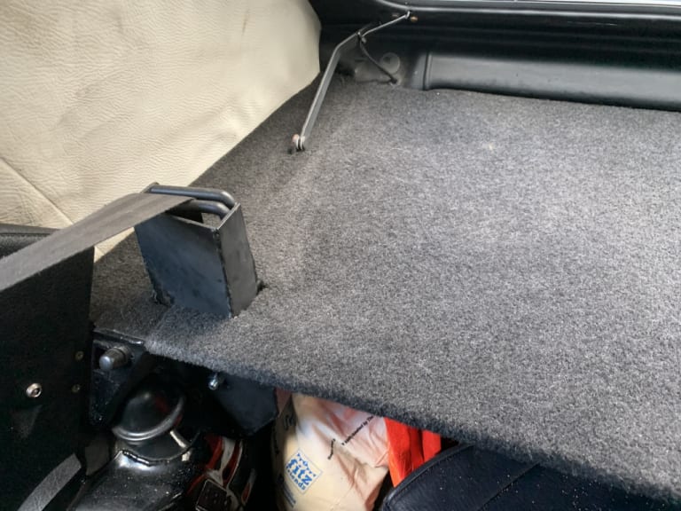

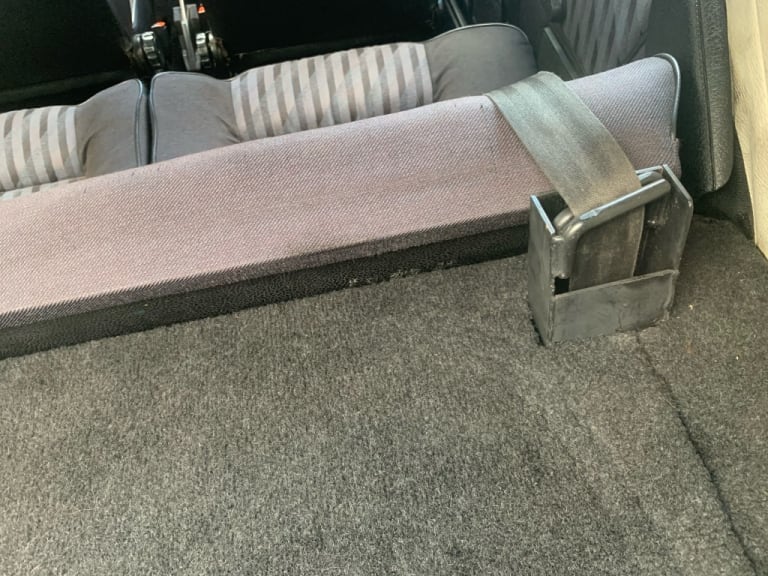

How did you find this kit for fitting and durability/safety? Considering getting it for my Cab as I need it for child car seats.Pcundy said

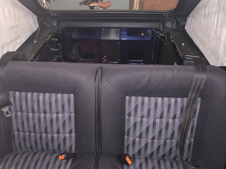

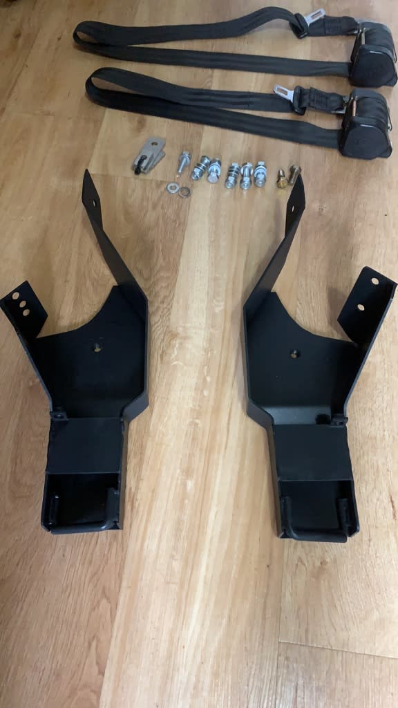

Crazyquiffs 3 point belts that came with the car now fitted

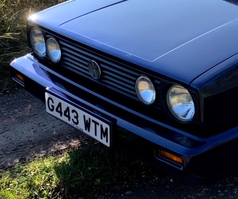

Early-1800 said
How did you clean the headlights?
There are a couple of metal tabs at the back of the headlight, prise these open. Ideally remove the headlight to do (I didnt). Then find a soft cloth to put on a stick or screwdriver. Then I just used window cleaner

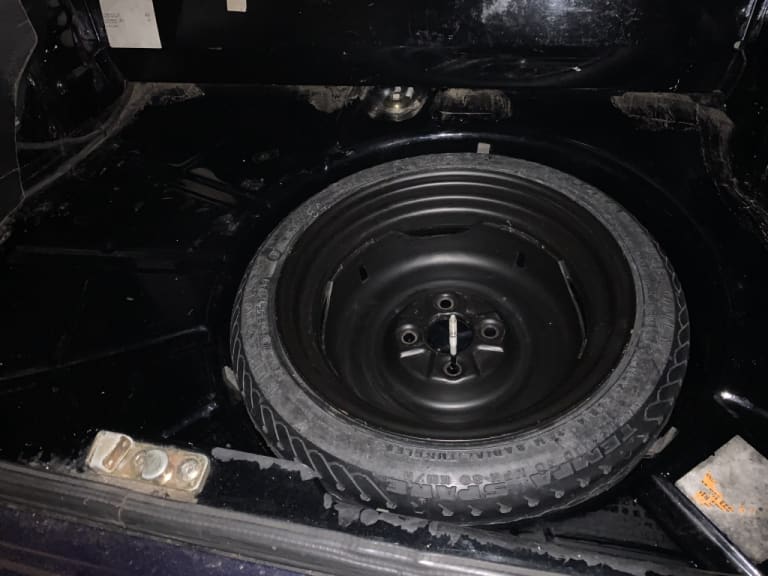

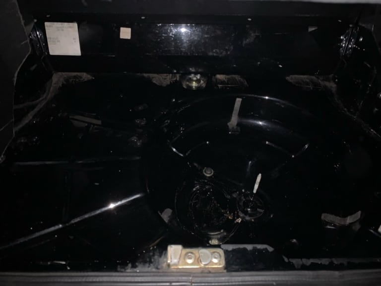

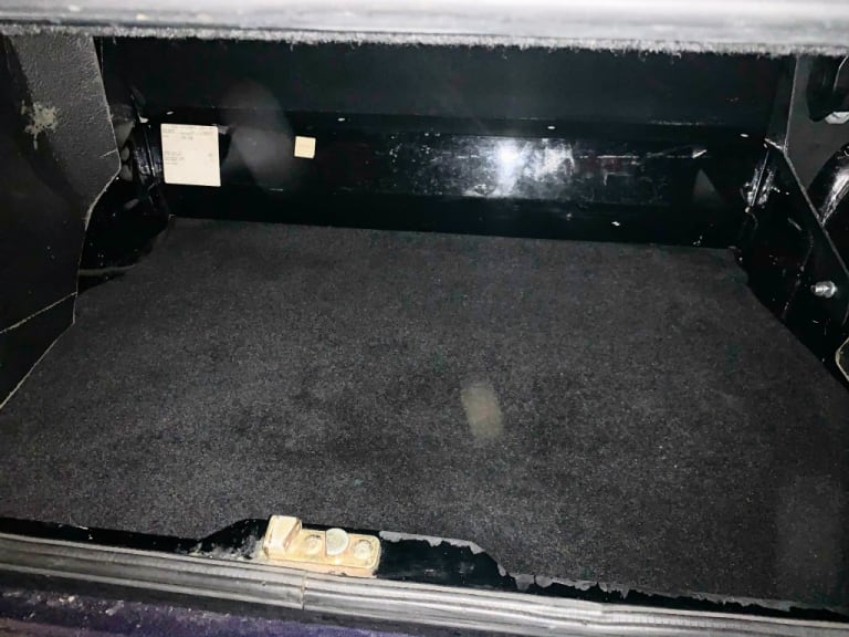

Clean up in the boot and space saver tyre pressure check to the recommended 60 psi

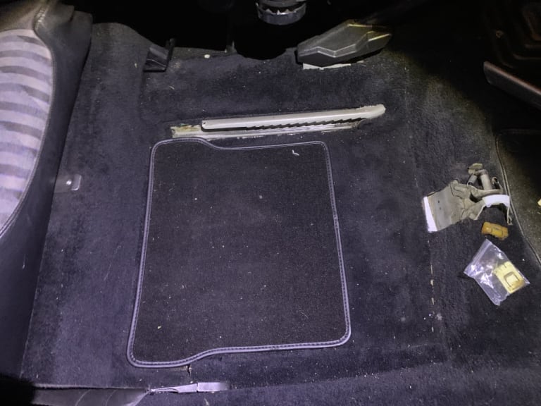

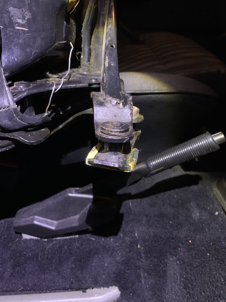

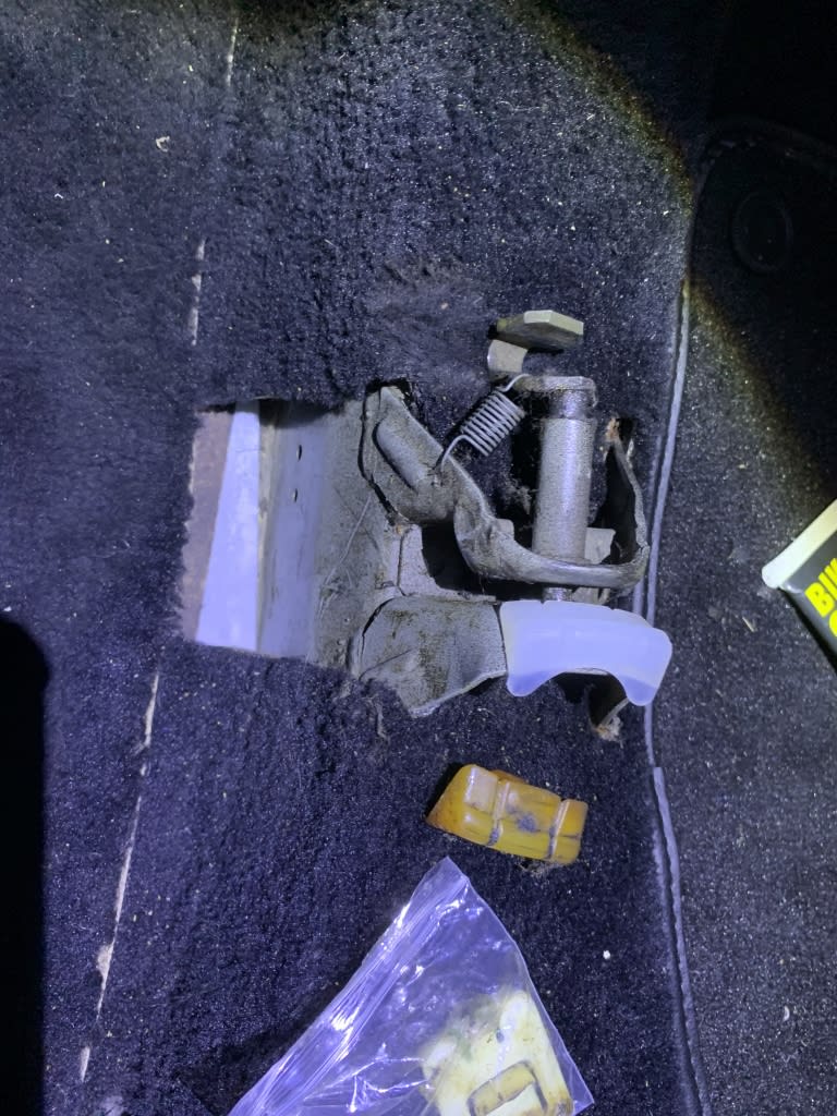

Plastic parts for Seat runners 2x of each parts 171 881 213 B & 191 881 213
Easy job Phillips screw for runner cover behind front seats to be taken off. Then bolts front Centre of front seats. New parts fitted greased and refitted.
