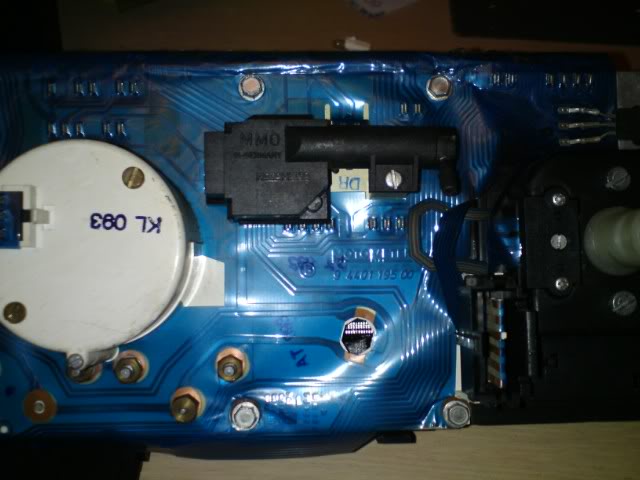

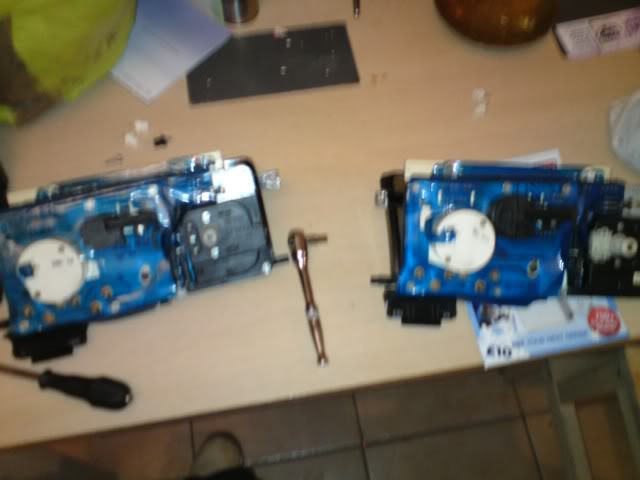

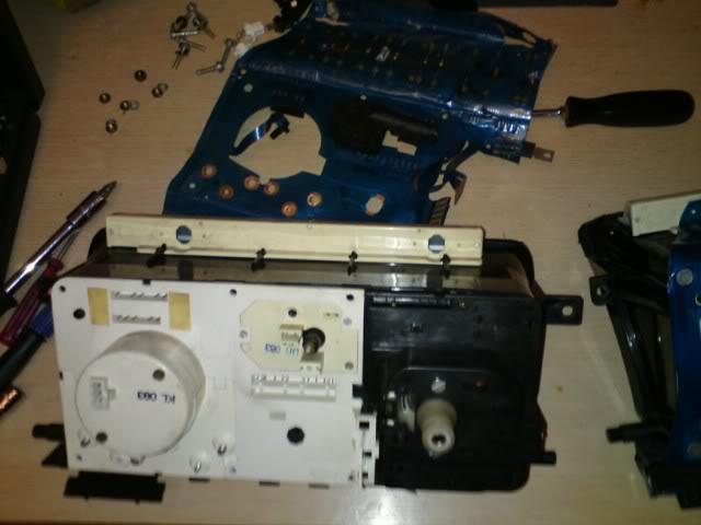

So after carefully taking off the PCB and changing the bulbs and connections over onto my existing clocks, replaced the needle for the Speedo as it seemed to be glued together. Plugged it all in and every thing works 100% can't believe it fully working MFA, bulbs every thing. Next was to pop down to me local VW dealers to get a full set of dash bulbs, so £35 later installed all new bulbs, but the dash light s still seems really dim.

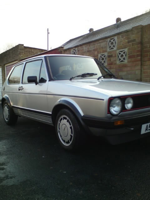

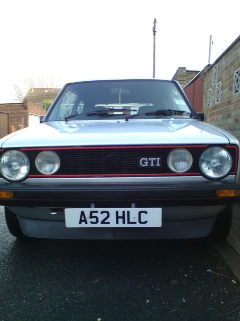

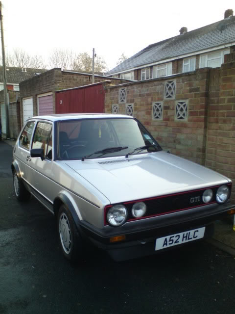

Anyway that's enough of me banging on some pictures of the car; I will post some new ones up when I get a chance with a decent camera.
