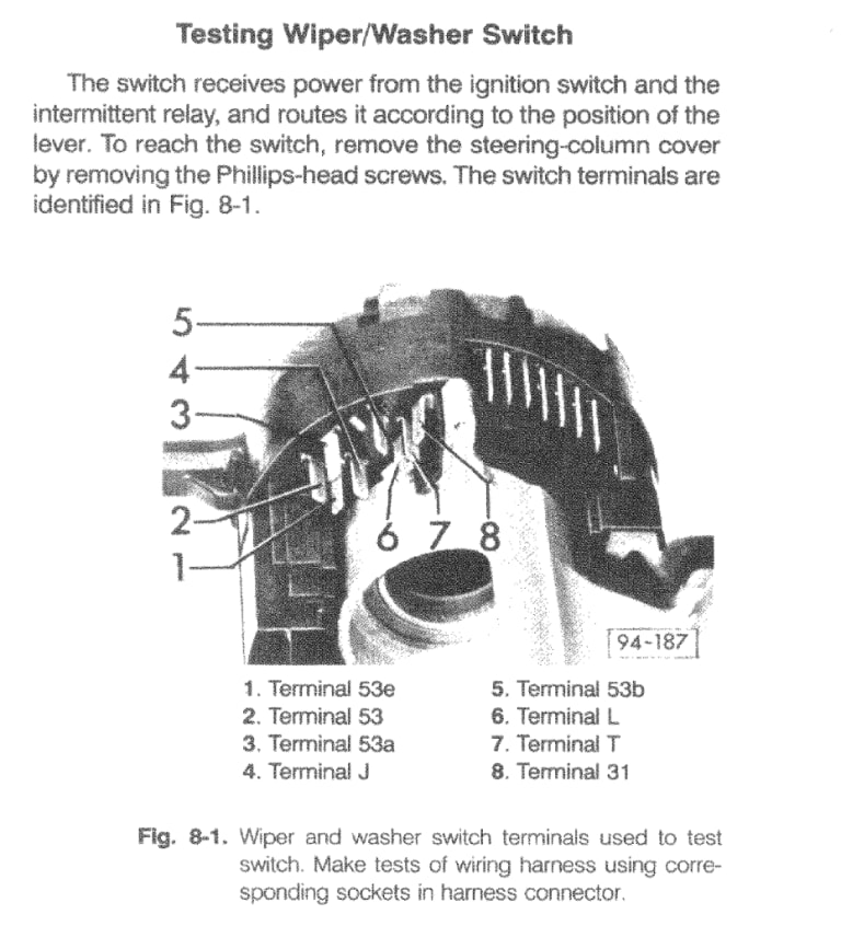

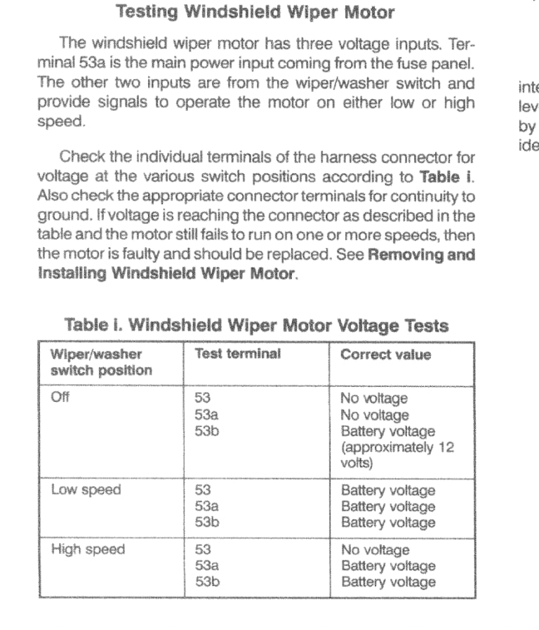

As it could be a bad relay.
See the Bentley Section 13-19

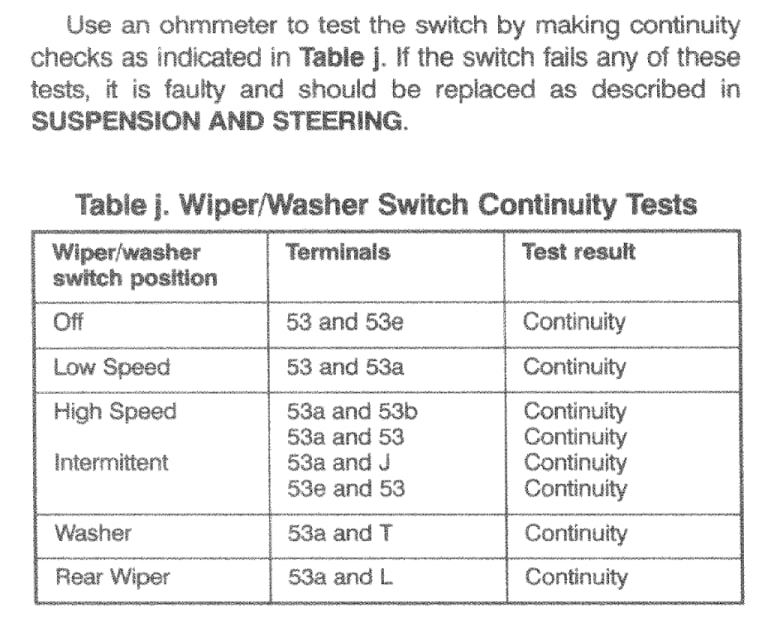

See if the inputs are correct.
Then use the Bentley to Test the Switch.
The Relay controls the low speed function, so don't discount that as a failure point which s why I said to check this in my first post… But lets just use a DVOM and see what is good first.

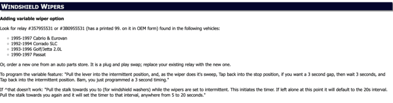

There are threads here abut using the mk3 relay in place of the MK1 and you can get programmable delay speeds.
