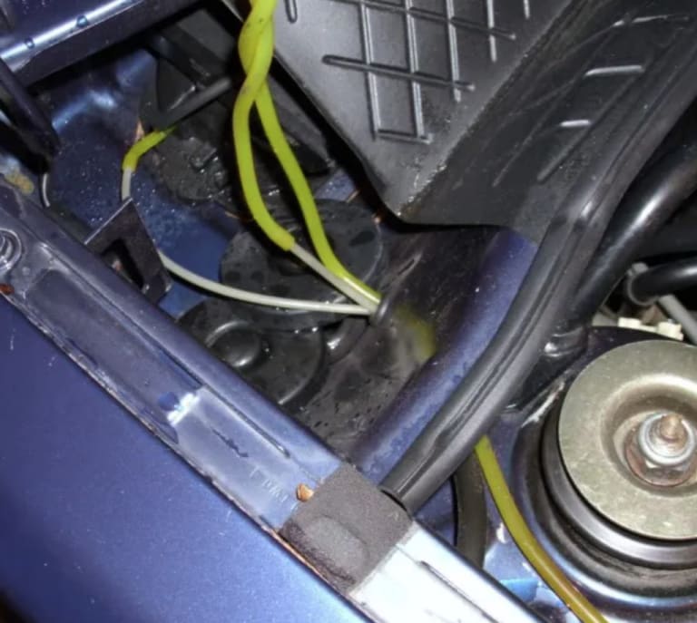

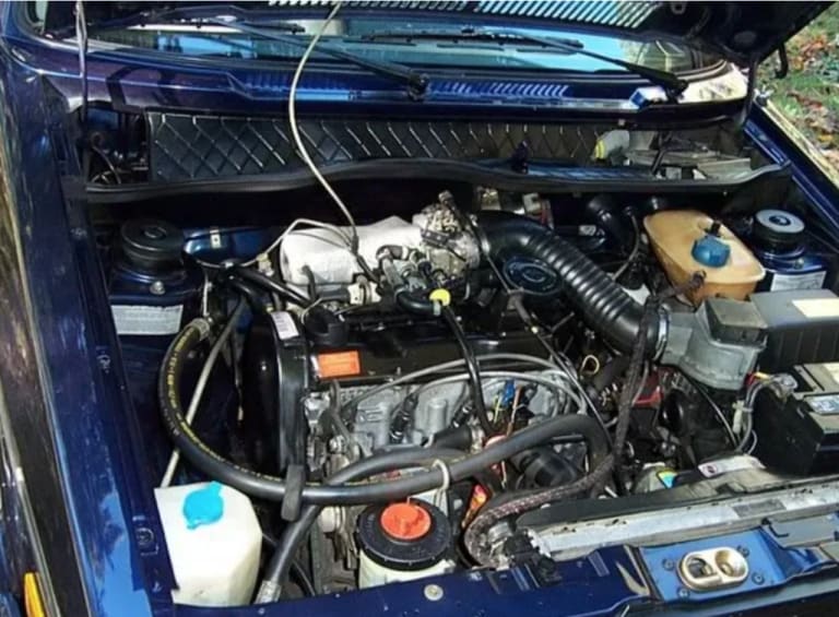

Clean Drains and re-route of Vacuum and washer lines.

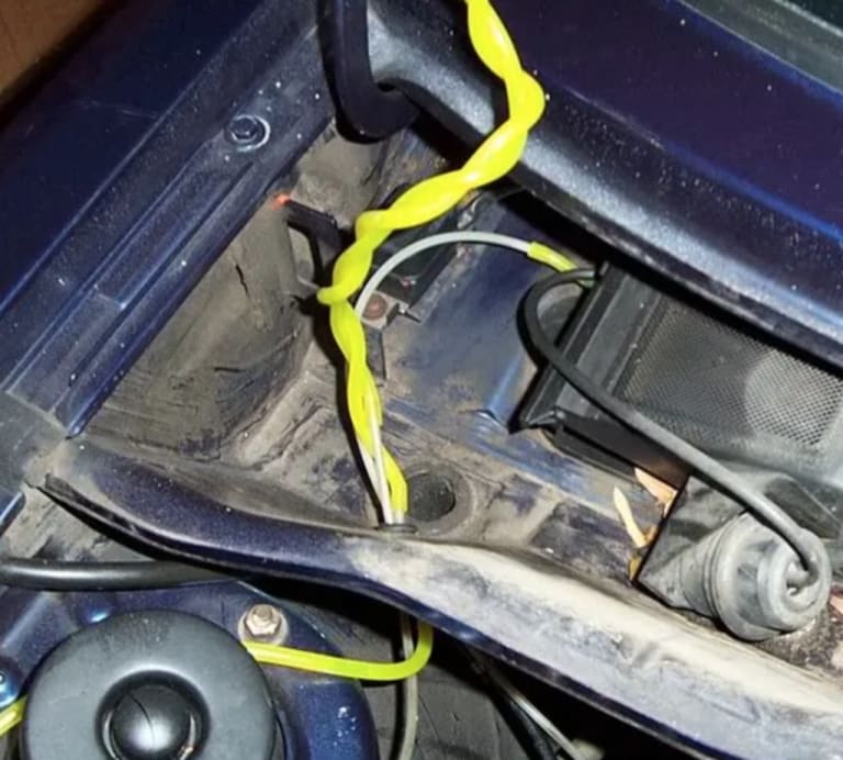

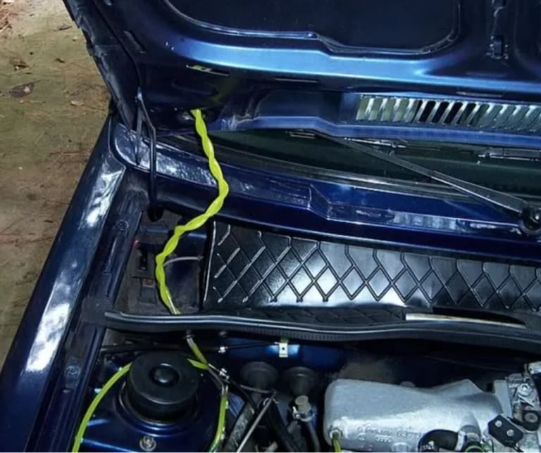

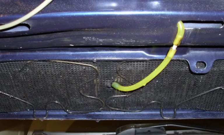

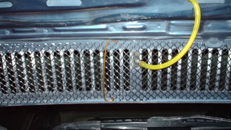

Clean the Vacuum hoses out of the drain and re-route them through grommet feeds and up the hinge. then use Vinyl hard lines through the bonnet.

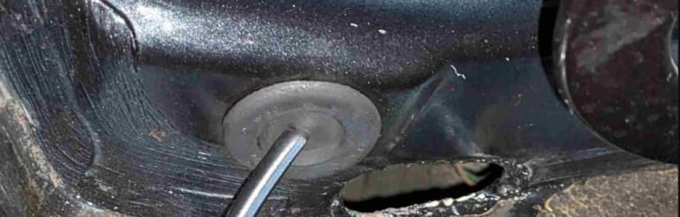

Make or acquire a rain divertor, and Debris Guard and Re-seal all your feed holes for cables and such.
True Debris guard.
OEM routing of vacuum and washer cables.

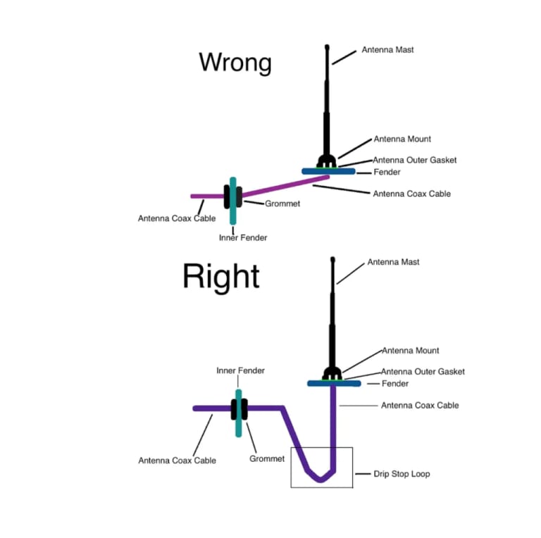

Then last do you have a drip stop loop on your antenna feed.

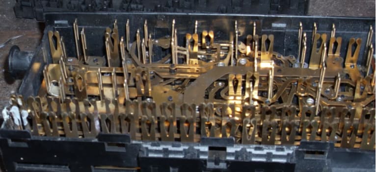

inside of fuse box.
Are you sure the new one is non-corroded.
