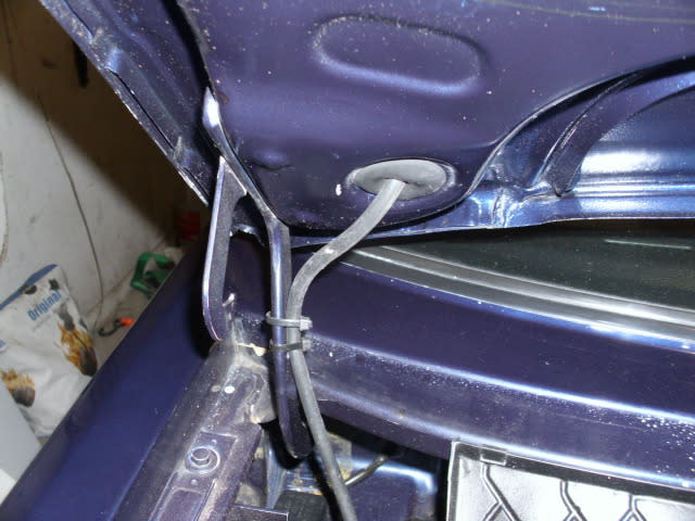

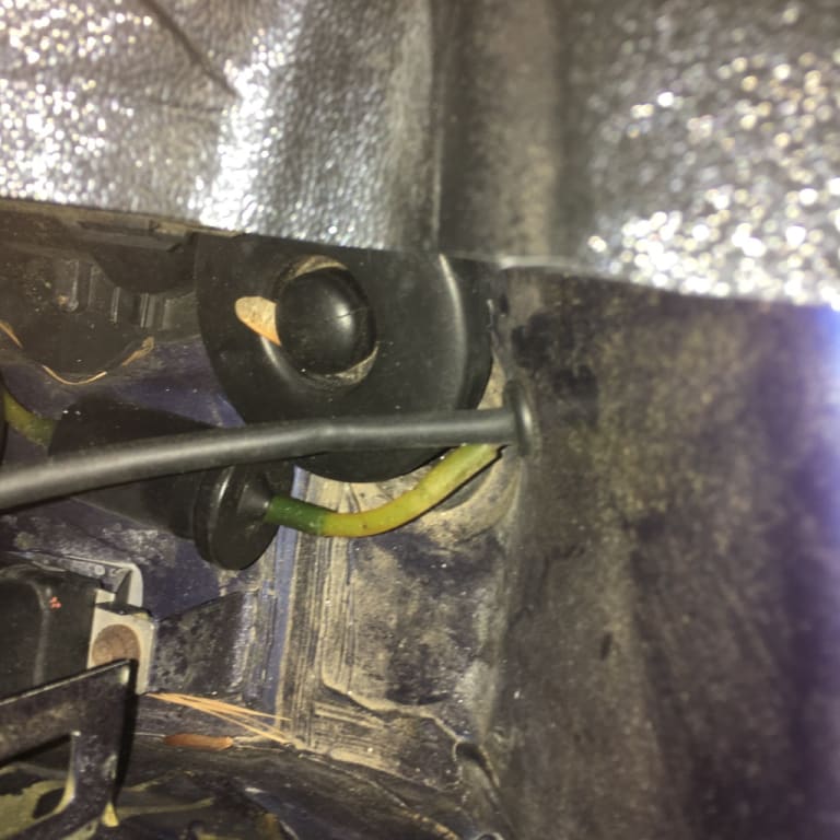

Or, you could run it inside the inner fender and out in the rain tray. The inner fender will cover it and you still can run it through the bonnet frame. I used a brass Barb fitting to keep it from being crushed by the bonnet to the raintray seal.
Mine on my cabrio catches on drip tray above heater motor every time opening bonnet as gives such a bang one day it's going smash drip tray

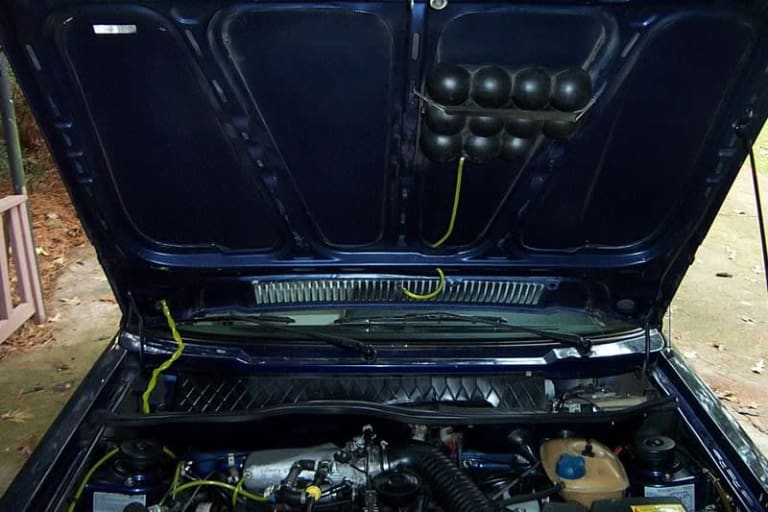

Here is the re-routed less obvious.
The Big Check Valve allowed me to rid myself of the Vacuum Res for the a/c. It came off a 94 Dodge Caravan.
Sorry for the dirty state of my engine bay. I got tired of snagging that hose, and the vacuum hose when I had to work on stuff in the bay, it is a cleaner look
How VW originally did it:
